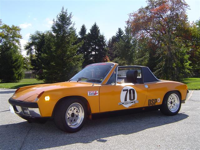

1970 914 with 73 2.0L
21mm Torsion bars with 21mm front sway bar
150lb springs in rear
adjustable rear spring pearchs
no rear bar
Set adjustable koni's to full firm
lowered & corner balanced
Kuhmo 205 50 15's for AXing on Keiser rims
This is my third year AXing and the first with this setup. Our last AX was during some major rain, I beat 2 of the 4 WRX's running and our Hot shoe in his street mod 1970 911. I was 1.5 sec's off TTOD and placed 10th out of 26 drivers. Not bad for using my street tires and heavy rain.
Raw results http://www.inr-scca.org/solo2/2006/2006%20...20tune_raw_.htm
Photo OP (IMG:style_emoticons/default/biggrin.gif) (IMG:style_emoticons/default/driving.gif)
