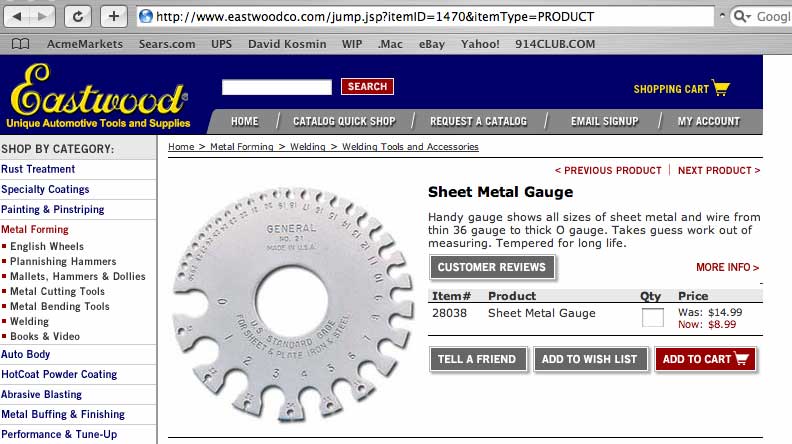

I've been using 18 and 20 ga. A sheet metal gauge is a handy thing to have. I buy my metal at a large metal yard in NJ (http://www.josephfazzioinc.com/). It's much cheaper than HD and a very cool place to wander around. There must be something similar near you. Bring your sheet metal gauge to make sure you get the right thickness and make sure they give you weldable steel (not stainless or galvanized). Have fun. (IMG:style_emoticons/default/welder.gif)
