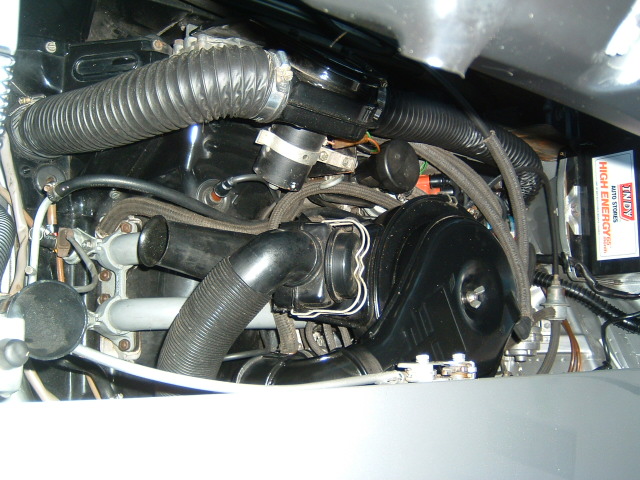

Here are a few phots just because we all like pictures:
Replies(1 - 12)

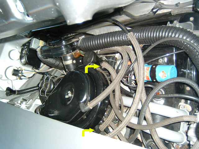

Another:

This is the decel valve. It could possibly be bad or leaking. You can easily block it off for testing (plug the lines running to it)
Let me know what you find.
B

OK, will ops check the decel valve.

Check the decel valve by pluging the vacuum side hose to see if that helps.

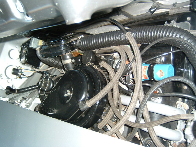

These crack....
