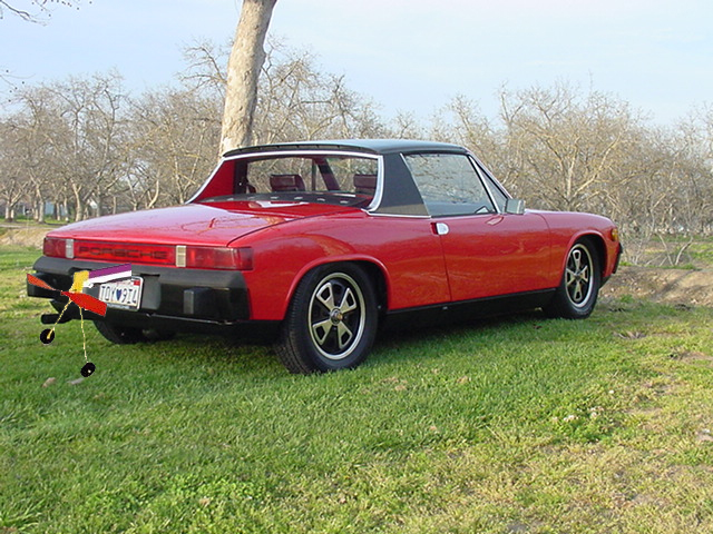

Put a wind-up propeller on the back that can be released when extra umph is needed
