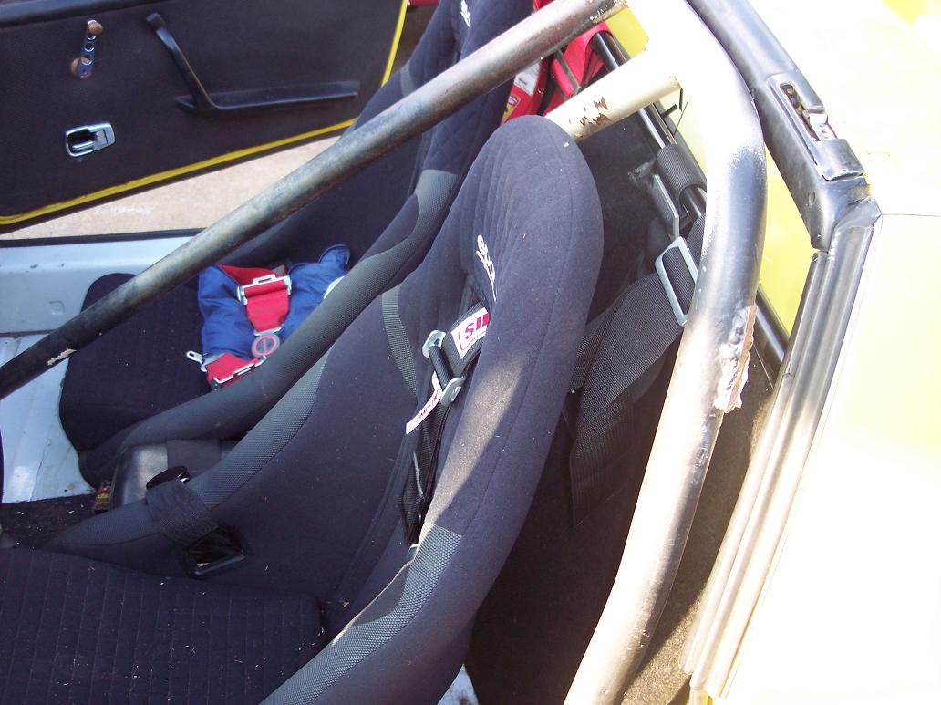

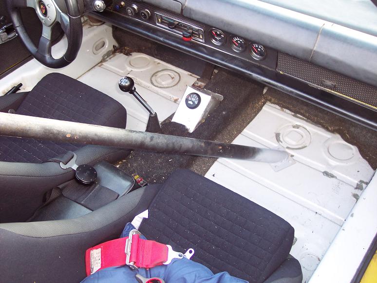

The black parts car I picked up had a roll bar in it. fairly standard piece I guess hoop from top of long to top of long and a diagonal brace pass corner to upper driver corner. with a charlie bar going to the passenger floor board.
whole thing is 41 pounds. Pretty heavy tubing and half ass decent welds.

I thought of that too. SCCA rules for roll bars require top of the diagonal bar originate from the upper 1/3 of the roll bar up right.
and tend 30 degrees either aft of forward.
I would think this makes it hard to get in or out, having to climb over the bar to get in the seat.
Guess I need to mock it up with some PVC to both longs as you say and see what it looks like.

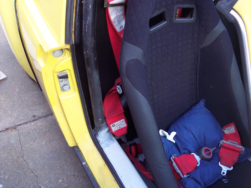

Check the rules. I'm pretty sure that the GCR's require that the cage be mounted to the -floor-. A rediculous requirement for the 914 I know. But there are ways to do it. Most commonly is that the cage meets the mounting plate on the long, but the mounting plate itself wraps down to the floor and is attached to both the long, and the floor together.
I'm thinking of doing a bolt in 6 point cage. Kindof a modified autopower cage. 4 points behind the driver (floor/long and B pillar), and then some forward extensions that tie into the front of the long as well. Then run a bar across the back as a harness giude.

got pics of it fitted in the car. very nice fit. I will have to make new braces to tie to the B pillar.
