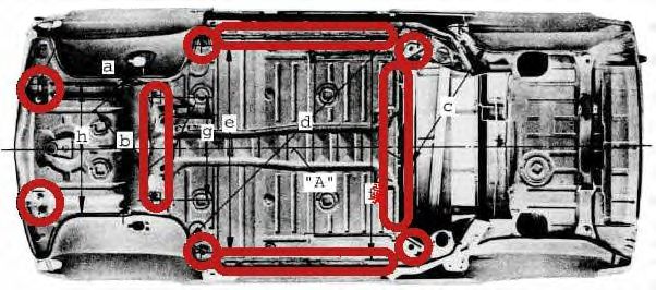

I need to work on the bottom of my 914, where is it safe to jack it up?
At the four corners of the floor, there are round "donuts" that are safe to jack on, and also are excellent places for jackstands. You can also jack on the engine mounting bar (on /4s), and the front suspension crossmember (which is usually hidden by a splash shield). Jacking up under the nose pieces of the front A-arms works, though it can easily slip off these, so be careful. Some also use the pivot section of the rear suspension trailing arms. Jacking anywhere else on the floor will likely damage the floor (as in seriously bend stuff). Jacking under the rear of the transaxle is doable, but it's easy for the jack to slip, and the case of the transaxle is relatively fragile magnesium.
