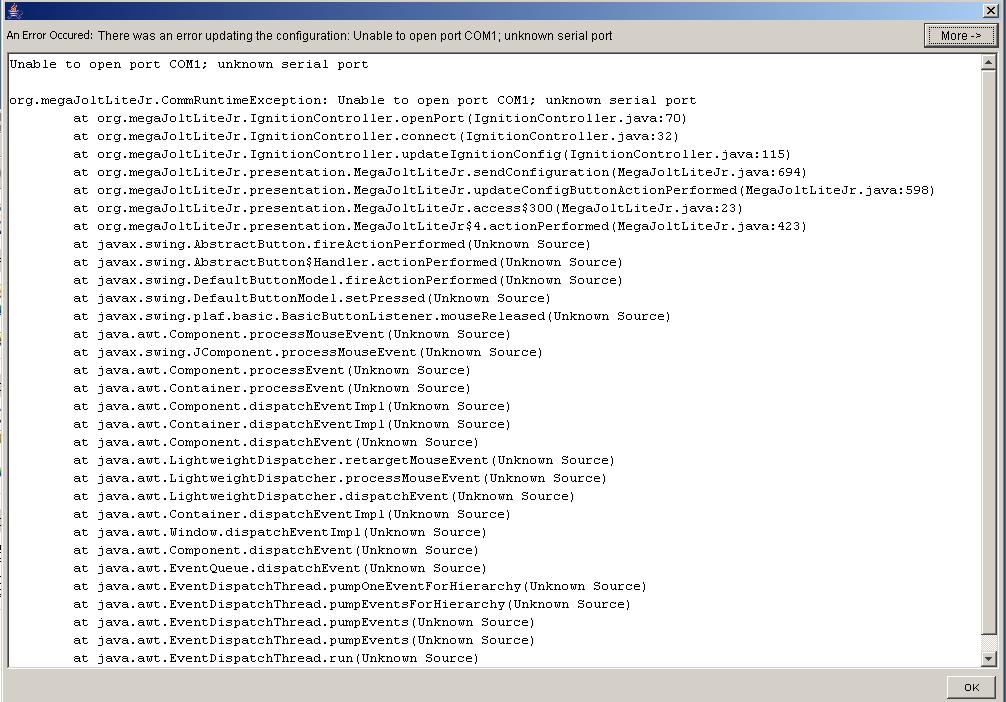

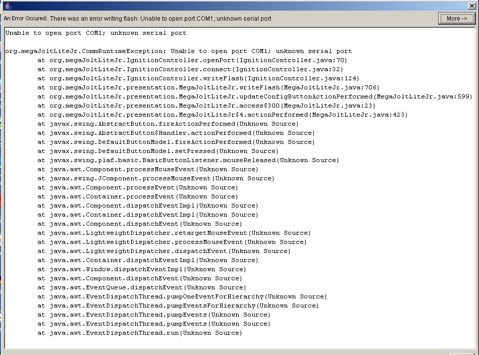

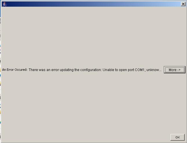

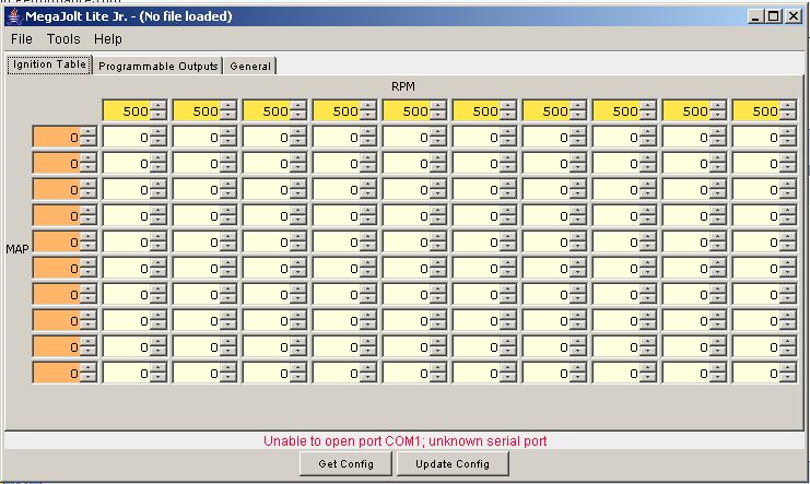

They are out of order (dunno why). 1 is the explanation of the first error, 2 is the first screen error I get on start up, 3, is the preamble to screen 1.

If XP is trying to install some weird driver for the MS, then just disable the Plug and play service and reboot. It won't try after that.

It's times like this when I lug an old desktop with REAL serial COM ports out to where I'm working. On my laptop, I bought a PCMCIA card with working serial communications to work around an issue where I needed a COM port but had none.
Good luck to you.
BTW, my PCMCIA serial card is a SOCKET brand.
Since then, I have aquired an old ruggedized Itronix laptop with a real serial COM port. It can only run up to Win98.

John, I am using my dask top with a real serial port.....and XP which may be the probelm. I am gonna get an older box from Dan when we can meet up.

XP may be the problem as it can't talk directly to the hardware ports.
I heard that somewhere.

Success! It took a looooooong time to get the Java and MJLJ files loaded onto the win98 computer lent to me by Dan, but as soon as I got it loaded and hooked up my box I got to see something that I had yet to see, IT GOT CONFIG! (IMG:style_emoticons/default/smilie_pokal.gif)
And now, it is time to get hot on a starter table using all of the excellent info provided by you all.

Windows XP and 2000 don't let most applications (Java one of them) interact directly with the hardware. Usually it must be a program written to take advantage of DirectX or call specific APIs to allow direct hardware access. Ask skliney for alot more info. Basically for programs that need a serial or COM interface, win95/98/ME is the way to go.
