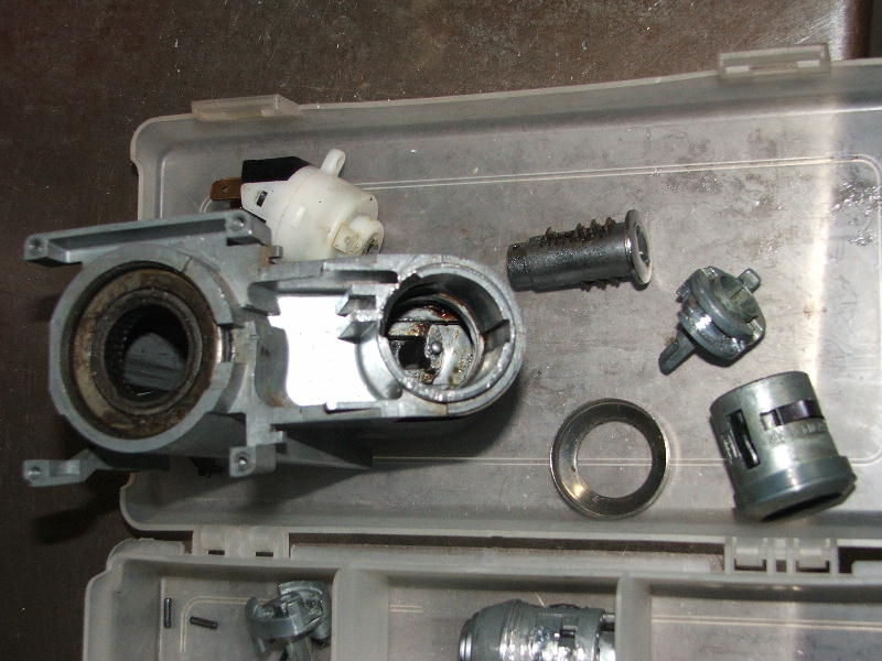

I got the cylinder out. There are two different cylinders. I'm going to re-key the existing cylinder.
Thack
post Jun 4 2006, 08:34 PM
Posts: 283
Joined: 1-June 05
From: Houston, Tx
Member No.: 4,182

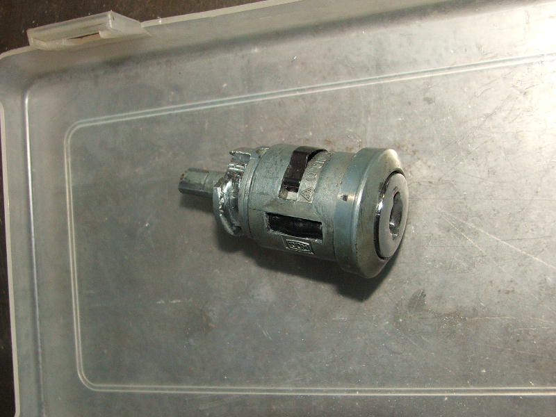

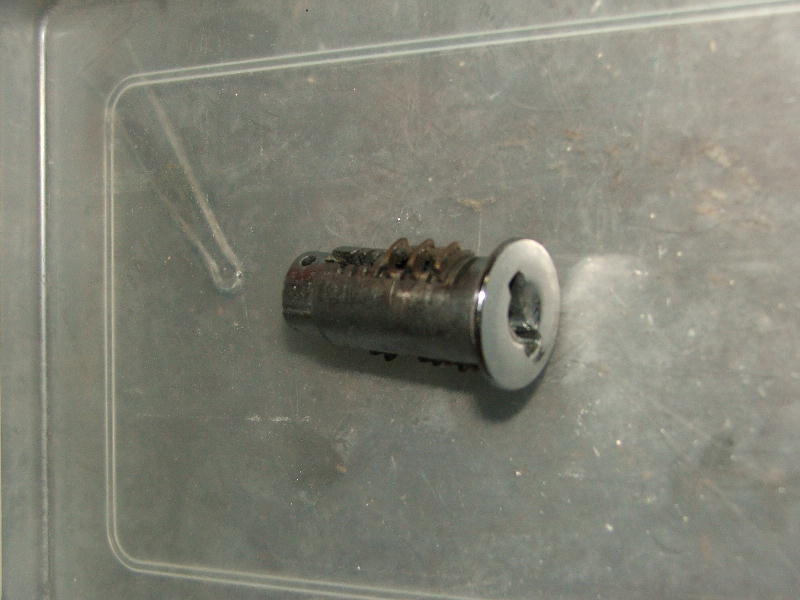

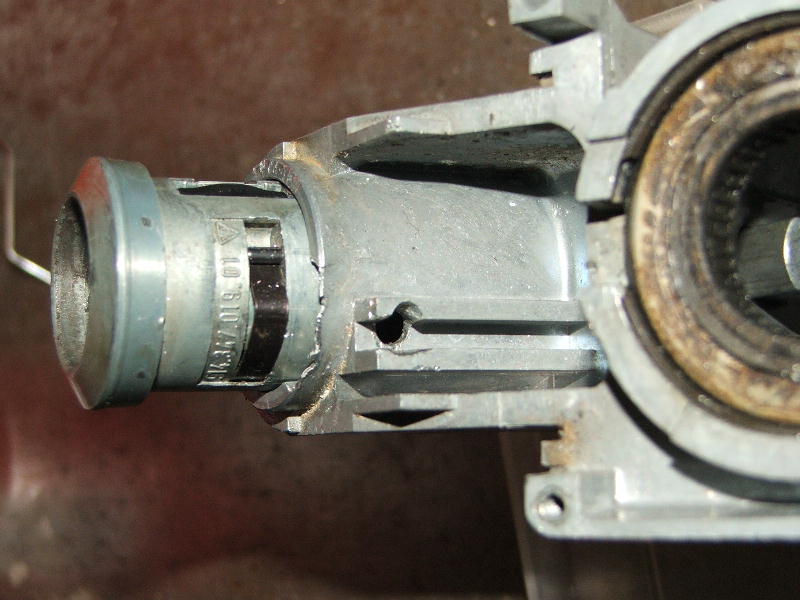

Couldn't re-key it so I modified the 70-71 cylinder I bought for $5.
This is what I am installing after maching the switch engagement drive.
Notice how I had to drill a hole to get the old cylinder out, no fun. Also the tumbler I could re-key is shown.
