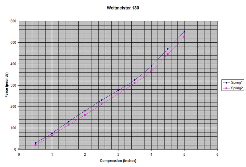

Ever wonder what the specifics of a progressive rate spring are? I did. They're sold as "180", but they're "progressive" so that can't be enough to go by.
The springs I tested are Weltmeister progressive 180s, and have a pretty clear wide coil spacing section, then a narrow one. They look to be pretty constant within each section. One of the springs is a touch longer than the other, which shows up in the graph.
When lightly loaded they are about a 100 pound rate, and when heavily loaded, they are about a 160 pound rate. The transition happens at about 340 lbs of force and about 3.75" of compression.
I'm using these for a V8 conversion, and since it'll be a street car, these will probably work quite nicely. Here's a graph:
