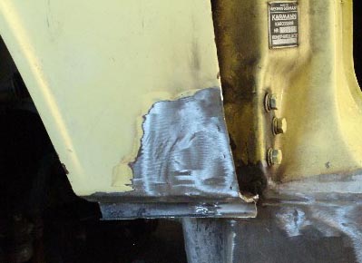

Making my first attempts at body work, welded in the patch piece and grinded it down. Now what do I do to make it smooth? Plastic body filler like Bondo? I'm a little wary of using lead. I'm working in my garage and I have kids around. Don't want to poison anyone. Eastwood has a lead-free solder kit, but it's not cheap ($150). Is it any good? Is it worth the extra cost? Should I treat the bare metal patch area with something before I use body filler/solder?

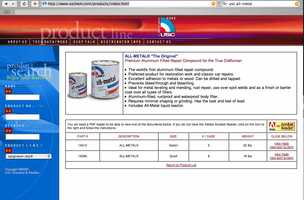

I use all metal exlusively... look in progress thread.
It is ground alluminum. It is impervious to water and will not shrink.
You cannot buy better stuff than this.
Even better it is made in Canton OH... right near me.
HIGHLY Recommended.

link to USC (makers of All-Metal) website: <http://www.uschem.com/products/index.html>
