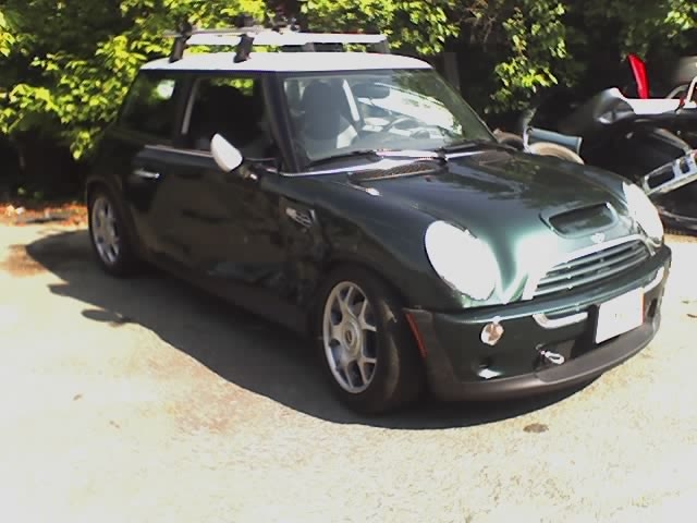

Our mini was in an accident yesterday. Insurance company is on the fence as to whether to repair or total. Car was t-boned at 45 mph. The person who hit my wife never even touched the brakes according to his statement to the cops. Every one is fine so that is good. i thought the mini held up very well to such a big impact, but after I went out to look at the car today I think it maybe too much to repair. Here are some pics.

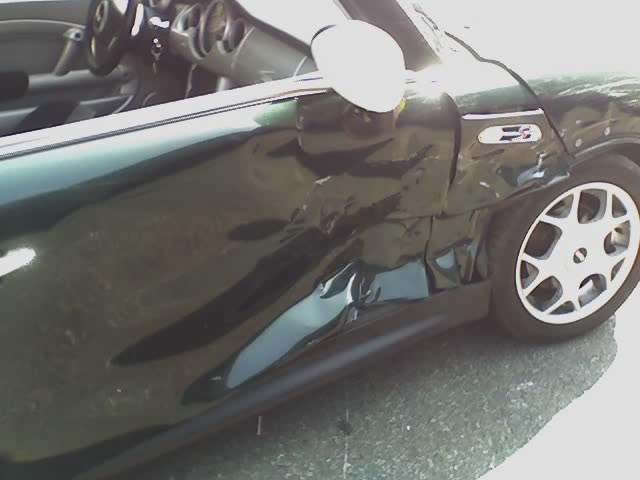

Door:

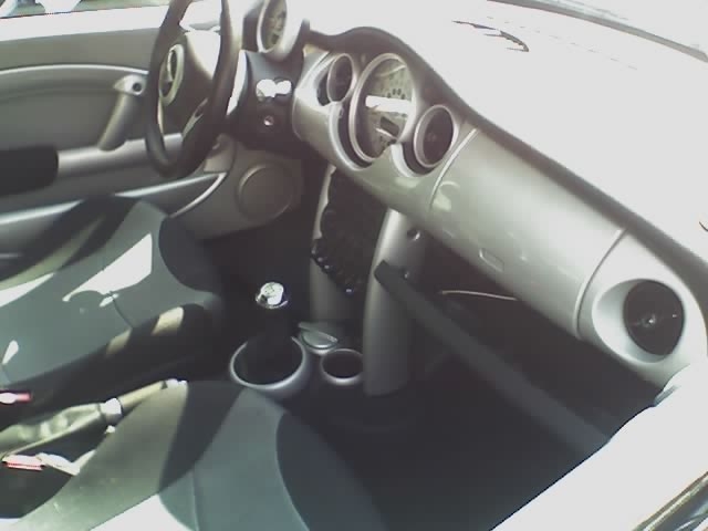

Bent dash:

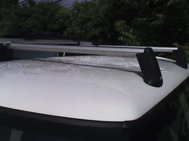

Buckled roof:

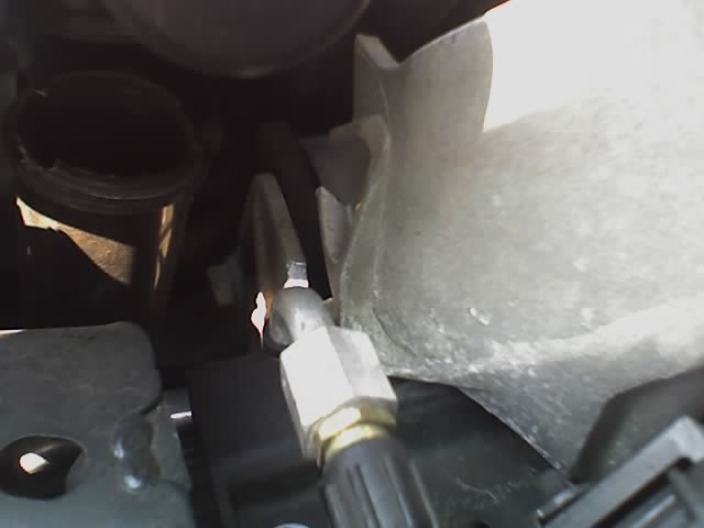

Broken motor mount:

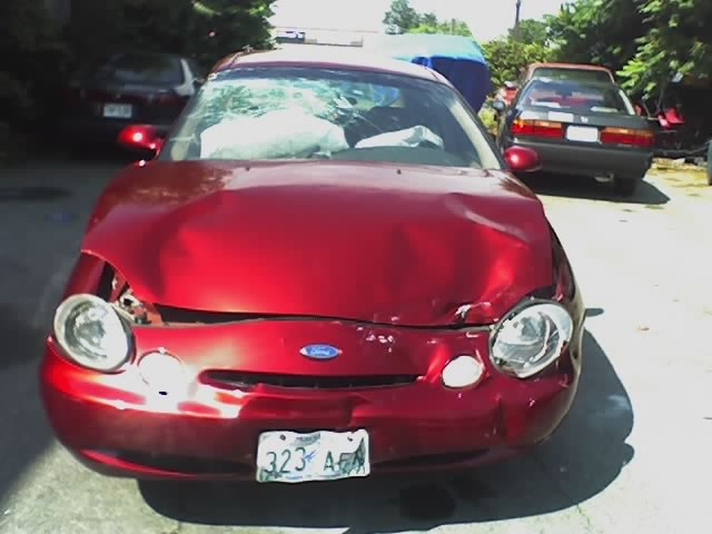

The other guy:

Dang, Nick. Sorry to hear about this. I am glad yoru wife is ok. I would personally total it. It is gonna be a huge pain in the ass to get it righ most likely. This way you can move onto getting another one.
The other dudes car looks worse.

Not sure about structural damage, but I bet the fact the roof is bent is a sign the car isn't straight any more. So far the insurance company seems to be totaling it. It has to be assessed by one more guy. I never thought high resale value would be a problem but the blue book on the car is 18K. That's a lot of repairs.

As for the car? Yeah, total it. The reason why the MINI is so well rated in crash tests is that the whole chassis deforms slightly to absorb impact energy. That car will never be right again, and it's a new car to begin with. If it were a 30 year old classisc car, that's one thing. But you can just get a new one right now. Total it and don't look back.

Only the driver in the taurus. The windshield broke and popped out because the A pillars bent in the impact. I should have taken a picture of it from the side. Everything is bent on that car in front of the B pillars. I was not impressed with the fords performance. None of the doors open on that car
