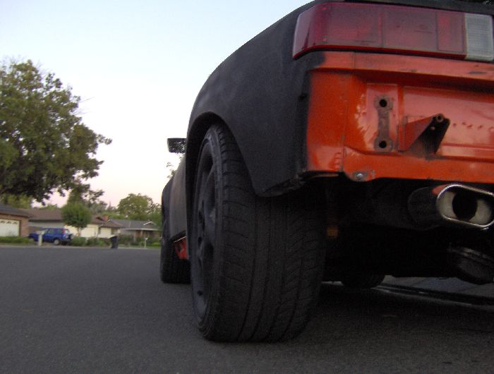

Im trying to go for 27in tires... The tires look TINY compared to the rims on my car right now.. (car is a little tall... but still) Lemme upload a pic.

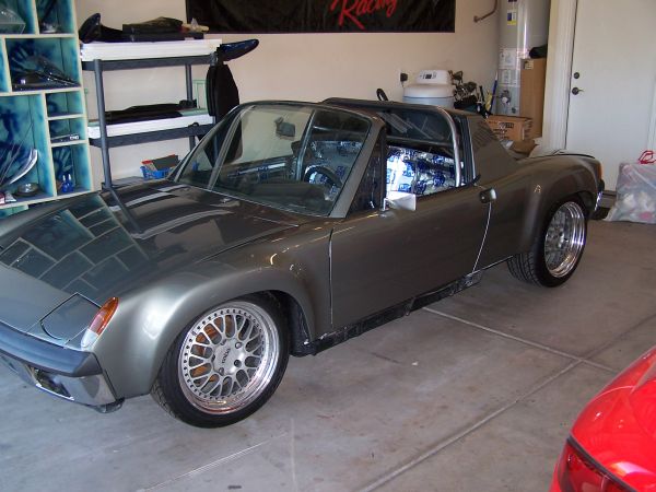

My 17's

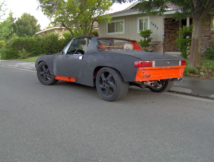

I dont think 18's are too big...
Keep in mind my car needs to be lowered about 2 inches.

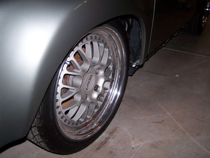

I know this is an old post but , I've got 18x9 and 18x10.5 on my teen. I used a 1.5" spacer for the front and a 1/8" spacer for the rear. check out pics on my v8 thread.

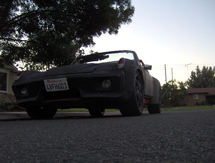

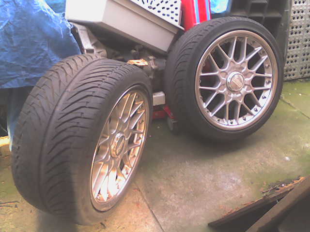

Here's a picture of the 18s I picked up for my project. They are going to be pretty much just for the street. I could of had a 87 928s, but I was two days shy. I'll settle for the wheels.
The 18s
Front 225/40/18
Rear 265/35/18

QUOTE(Mr.C @ Oct 21 2006, 11:38 AM) *
The 18s
Front 225/40/18
Rear 265/35/18
I (IMG:style_emoticons/default/stromberg.gif) in your general direction as this Jehad continues to rebel against your sweet temptations. You have no pull against the faith of my resistance.
