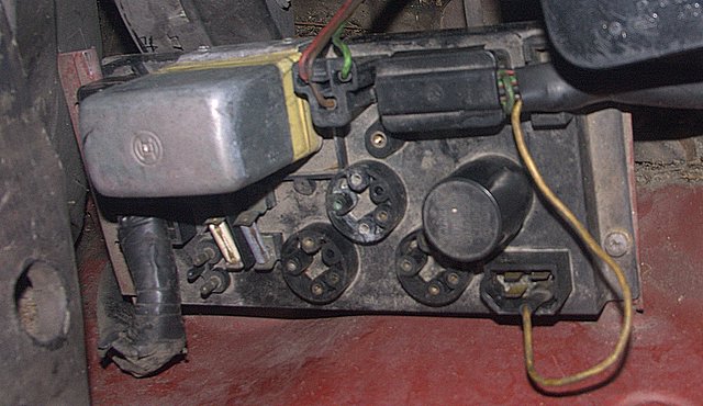

There is a single yellow wire from the fuel injection double relay to the engine relay panel and it plugs into one of the terminals of the quad connector on the panel. See the attached picture. I think I have it plugged onto the correct terminal of the quad.
Can someone with a 1.8 L-Jet take a look at their relay panel and see if their single yellow wire is plugged onto the same terminal as mine?
Wiring diagram is useless. Is just indicates that the yellow plugs into the quad connector on the relay panel. It does not indicate which terminal.
Thanks!

well, I couldn't find a picture, but yes, that is where it should be.

yeah, it looks like you are missing the fuel injection relay up there. Not the fuel pump relay, the other one. You only have the one in the slot for the heater fan. The other three are for fuel pump relay (1.7 and 2.0) and the fuel injection and the optional rear window defroster.

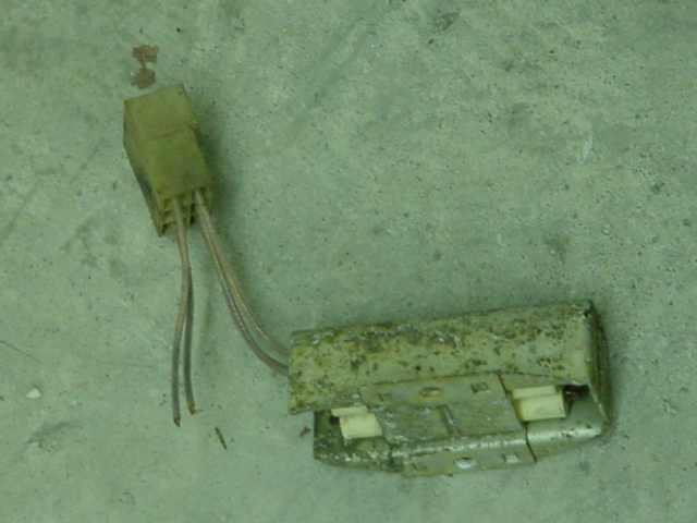

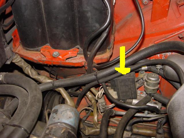

Ok.. here we go... Picture time....

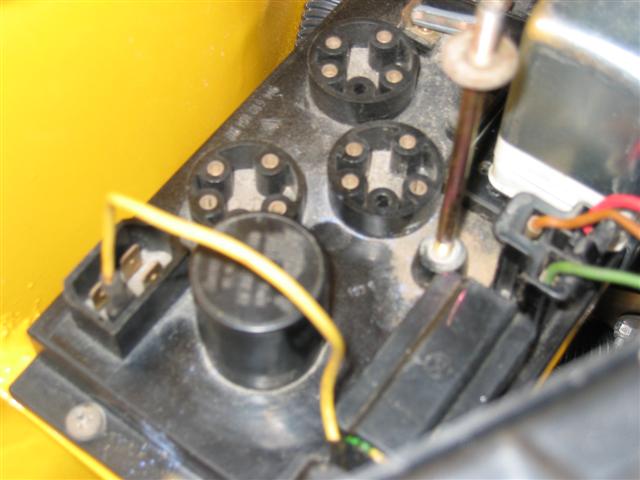

The crappy yellow arrow points at the double relay as installed on Betty's car.
Monted below them are the dropping resistors for the injectors.
(Pict of dropping resistors)
The factory mounted them to the support for the battery tray. I moved them when I installed the rotary compressor for the AC. For the sharp eyed 914 gurus, Yes, the decel valve is gone and in it's place is an idle up solenoid for the AC.

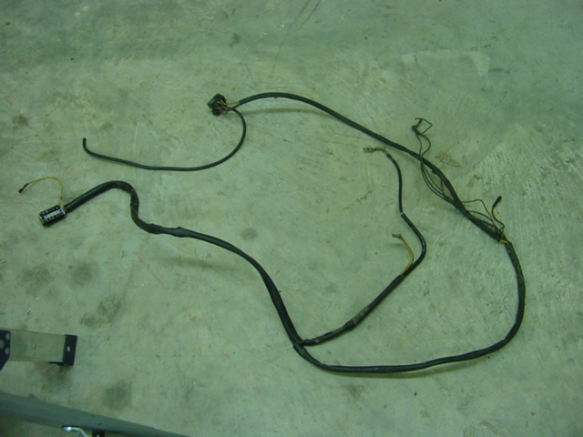

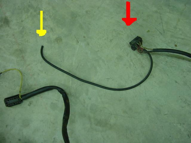

The L-Jet system uses a different engine wiring harness from the D-Jet.
Here's a picture of an L-jet engine wiring harness:
There is an extra plug and connection on the harness to accomodate the double relay. The red arrow is the double relay connection, and the yellow arrow is the wire that connects to the positive battery post.

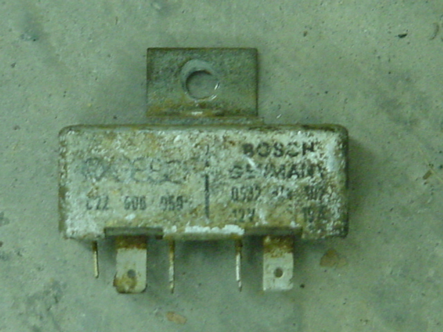

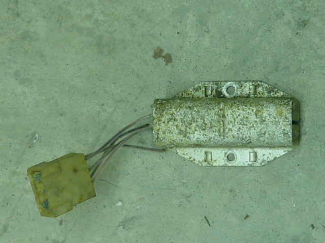

Here's a picture of the factory original, no longer available, official 914 double relay.
They have been superceded with the black plastic VW part. A couple of notes about the replacement VW relay. You have to trim the plastic plug on the 914 engine harness to use the plastic double relay on it, otherwise the plug won't fit the bottom of the relay. And there are 2 VW versions of the double relay. The differences is one digit in the part number, and the location of the fuel pump power pin. That pin will be located in connector that matches up to the FI harness, and not the Engine harness. If you get the wrong one, it will plug in and everything but the fuel pump will work perfectly. (IMG:style_emoticons/default/headbang.gif)

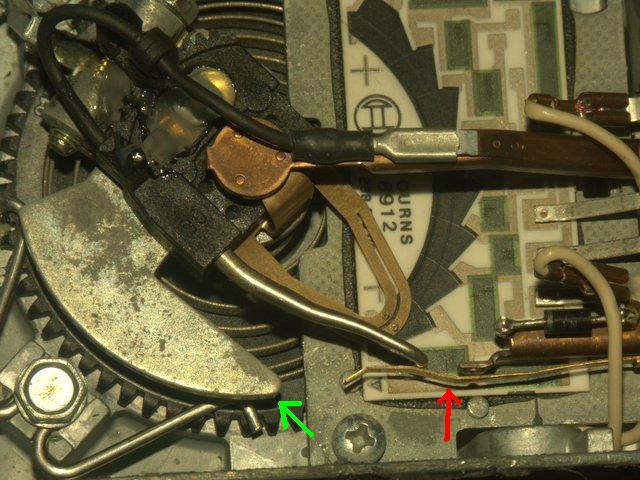

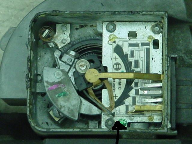

Here's a picture of an unmolested air flow meter. The black arrow points at the fuel pump contacts, which are being held open by the little silver arm.

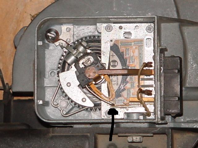

Now here's a broken air flow meter....
Note that the black arrow points to where the fuel pump contacts are supposed to be opened by the little silver arm, but the end of the one contact is broken off.
On a side note, this air flow meter also has slipped it's spring and does not have the correct calibration any more.
Close examination will note that the air flow meters are slightly different styles of manufacture. The late air flow meter (first pict) has a wire retainer in the teeth of the spring wheel. The early air flow meter has a clamp plate (not visible behind the counter weight). The first picture shows a revision done by Bosch due to lots of slippage of the spring.

Mine is a stock 75 l-jet 1.8. I’m not sure if it’s the same for a 74, but if so, here goes:
On my car, the yellow wire is bottom-right and the fuel pump needs 3 relays to engage before it will run.
First one, (on the relay board, second one down) powers the l-jet system & brain. This relay gets it signal from the ignition switch. Turn the key above “off” and it gets power. The contacts close and the fuel injection system is “ready” and idle.
Second one, (the double relay, mounted remotely between the dizzy and battery), engages from contacts in the airbox. When engine is cranking or running, flap in airbox moves above zero, contacts close, engages part of the double relay.
Third one, (on the relay board, third one down) is the actual fuel pump relay. When the contacts are closed, pump on. Contacts open, pump off. Pump on / pump off, that’s all it does.
Basically, a 75 fuel pump should only be running when all 3 conditions are met:
1 – Ignition switch = on.
2 – Flow through airbox = yes.
3 – fuel pump relay = engaged.
It’s a safer system when everything works and it’s wired properly.

Just when I thought it was about time to remove "newbie" from under my avatar pic.
You're totally right!!! She runs without either the "power" or the "pump" round relay. But, when my double relay was bad, the only way to run the fuel pump was to physically force round relay# 3 on. I could push down on the top and hear the pump buzz. Got me home and off the side of the road. Never rechecked anything after replacing my double relay. Never yanked the relays while it was running.
The "power" round relay clicks when I plug it back in, but I guess it's contacts are not used anymore.
So, humbly, never mind my earlier advise. <I deleted my post as to not confuse>

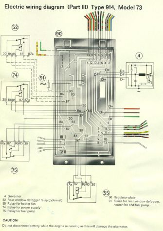

Attached:
73 relay board, the board hasn't changed over the years, but I guess its use has.
So, I now have 3 spare round relays. (no rw defrost either).

How that works....
On a D-jet system, the fuel pump relay on the relay board feeds power out pin 13 on the 14 pin connector on the front of the relay board to power the fuel pump, and it feeds power out pin 12 on the 12 pin connector to power the Aux air regulator, thermo-time switch and cold start valve.
On the L-Jet, the same pin on the 12 pin connector is hooked to the double relay's fuel pump output pin. That means that when the double relay is closed, the power flows into the relay board through pin 12 on the 12 pin connector, through the relay board and out pin 13 on the 14 pin connector, then on to the fuel pump (clever of those German engineers).
So if you close the round relay for the fuel pump on the relay board, it will still power the fuel pump. But it's not used by the L-jet system.

Okay, lets keep beating this horse. I think he still moving!!
Since I have the fuel pump that runs all the time, and no one told me I couldn't,
I pulled the cover off my airflow sensor.
The fuel pump contacts were closed all the time. My first attempt was to bend the
copper arm to get it to operate properly. That worked okay, and now the Fuel
pump only runs when there is vacuum, airflow!! The arm is marked in red.
But.....
I looked more closely at the copper arm. There is a cam type pivoting piece
on the rotating part. The cam thing is marked in green. It ends up hitting the
fuel pump arm and turning off the fuel pump?????? You can even see the bend
that allows that. The plan looks like straightening the fuel pump arm so the fuel
pump keeps running!!! Seems too easy!!!!
Could this be related to my problems with the car running?? The symptom is
that the car will start, then die after a few seconds. If I pump the accelerator, I
can keep it running, sort of. But it will die after a few seconds each time. Maybe
the fuel pump is shutting off as vacuum is building?? I have suspected this alll
along, but couldn't prove it.
Amy I crazy as usual? It looks like the airflow sensor is realatively new,
maybe rebuilt?? Everything else looks clean in there. Anything else to check??
Jeff
ClayPerrine
post Jul 2 2006, 07:20 PM
Posts: 16,462
Joined: 11-September 03
From: Hurst, TX.
Member No.: 1,143
It sounds like you may have a slipped spring on the meter. Was the lid for the air flow meter hard to remove? If not, someone may have fooled with it in the past.
I have a 75 Air flow meter that I can send you if you want to check that out. The 74 uses a different pinout so I can't use it on Betty's car.
Let me know if you want to try it.
