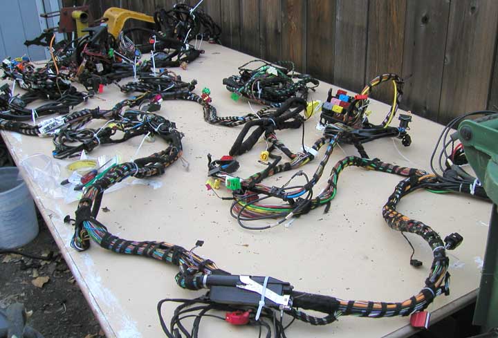

I look to the Subaru converters since there are many done. I know some are using stand alone engine management but I will use OEM ECU for now.
Did you use donor wiring, create all new wiring, or splice some into stock 914 wiring? If splice, what did you keep and what did you remove?
I've got the complete Audi S4 harness and diagrams so I "could" replace everything. I'll likely do that but I first need to remove unused circuits as they take up space.
My plan is:
-Sonu to help get the motor running by October
-Electric door windows
-Use Audi instrument panel and associated sensors
-climate control work including A/C
Audi parts I will not use:
-brake sensors
-air bags
-most emissions systems
-options

I used almost all donor wiring. I did leave the 914 harness in place for the starter, oil pressure warning light, etc. A lot of wire can be removed, just spend some quality time with the wiring diagram to figure out what you need if you want the obd and mil to work.
I made a guesstimate of how long the harness needed to be and started shortening/splicing. My two recommendations are: 1- buy a dymo label printer, 2- give a good strong tug at every splice to make sure it doesn't want to come apart, on the suby some of the wire diameters are pretty small and have a tendency to get very weak when stripping the insulation. I found this out after the new harness was in the car, no fun.
I like all the sensors... plug in the code reader, 'XXXX input low', take a look at the sensor, 'ahh, i should have tightened that vss down a little better', all fixed. Troubleshooting skill- minimal... daily driver quick and easy to fix - yes.

You are not going to believe how much of the original harness you will throw away. My harness that was created out of the factory harness is only about 5 pounds, and about 4 feet long. (IMG:style_emoticons/default/blink.gif)

I made a harness for my Subie conversion (which uses megasquirt) and brings all the wiring into the cabin (MS is between the seats). I think it's simpler than the stock D-jet harness.
To answer the original question - I spliced the stock wiring with my own wiring. I stuck a couple of large connectors on the end which plug into sockets that are mounted to the firewall.

My general take on this is that you'll want to completely pull 100% of the wiring out of the engine bay when doing any engine swap. The only wiring still there should be the stuff that goes to the rear trunk.
Nearly 100% of the center tunnel wiring should also be pulled. What you NEED out of the stock wiring in the center tunnel is the big unswitched battery wiring (red wires), a single small (18g is plenty) switched power wire, the starter wire, and the rear trunk wires (brake, tail, turn).
The switched power wire should go to a relay that provides power to the ECU and the engine. I would pull the relay board, the relay board supports, and put the ECU in a waterproof box in the engine bay. This minimizes the amount of wiring that has to run back up to the dash. Another common option is mounting it all behind the passenger seat and running the wires right through the firewall. You'll need wiring for any gauges you decide to run, and those should pretty much be the only additions to the center tunnel wiring.
Leave most of the dash and all of the front trunk wiring alone. The harnesses all split this way pretty neatly, so you should be able to separate out the front, center, dash, and rear sections pretty easily.

Run a 10g brown wire from the battery negative post to a bolt under the dash somewhere. Or, just grind off some paint, drill a hole, solder a bolt to the body through that hole, then paint over everything but the bolt's threads.
With a conversion as extensive as yours I'd strongly consider completely rewiring the car. My remarks above were more general. Since you're going to remove the stock headlights, and I presume the headlight buckets and whatnot, I'd just remove everything around there. The turn signals are a single wire per light, or two wires if you're also doing parking lights. You're going to redo the turn signal buckets extensively, too, so there's no win in keeping the stock wiring. Esp. since you're making a show car, you'll want all new wire, as a lot of it will be visible, and you want it neat. It will be difficult to get the wiring neat if you use a harness from some other car.

I am about 99.% finished with the wiring for my conversion. Only things left are relays for the radiator fans and wiring in the alternator.
I am using the stock ECU and the stock wiring harness. What I did was go through the wiring diagram for the Subaru and made a spreadsheet for every ECU input/output and from there decided what was useful for me and what was not. There were a few things that I didn't care about, mainly smog related stuff and fuel tank stuff. All of those things are simulated in a small printed circuit board I made up which has a bunch of potentiometers. That box sits atop my ECU for the shortest possible wiring.
The erst of the wiring comes out in I believe 5 cable assemblies organized by use. two go to the engine, another to the oxygen sensor, and another two go to me engine bay box. One of those is strictly for power, the other is for the atmospheric pressure sensor and radiator fan controls.
Inside the engine bay box, the 914 harness (which is mostly intact) splices off to the rear trunk, and also to the ECU harnesses. There is a relay for the fuel pump inside the box, the atmospheric pressure sensor, and 4 fuses. Several of the stock 914 wires are unused, but I'm leaving them there because they don't take up much space/weight and might be useful for other purposes later on.
So the real key here is spending a good amount of time with the wiring diagrams and figuring out what EVERY wire does. This took me quite a while. Aside from the engine bay prep work I've done,the wiring was the single most time consuming part of the conversion.
So get the diagrams, cut out what you don't need (I cut probably 75% of the whole Impreza's wiring out) and leaev those ends long enough that if you messed up, you can connect things later on. I left those wires at elast an inch long from the conenctors and coverd them with shrink tubing to prevent shorts.
Rewiring the car is definitely an option. I almost did this with the other car I was converting, but decided it was too much extra work. There are other complicating issues here too, such as finding good multipin connectors (12 pin weatherpack I _think_ is the most you can find easily) and the cost of building a wiring harness from the ground up (pun intended) can be substantially higher than you might think.
