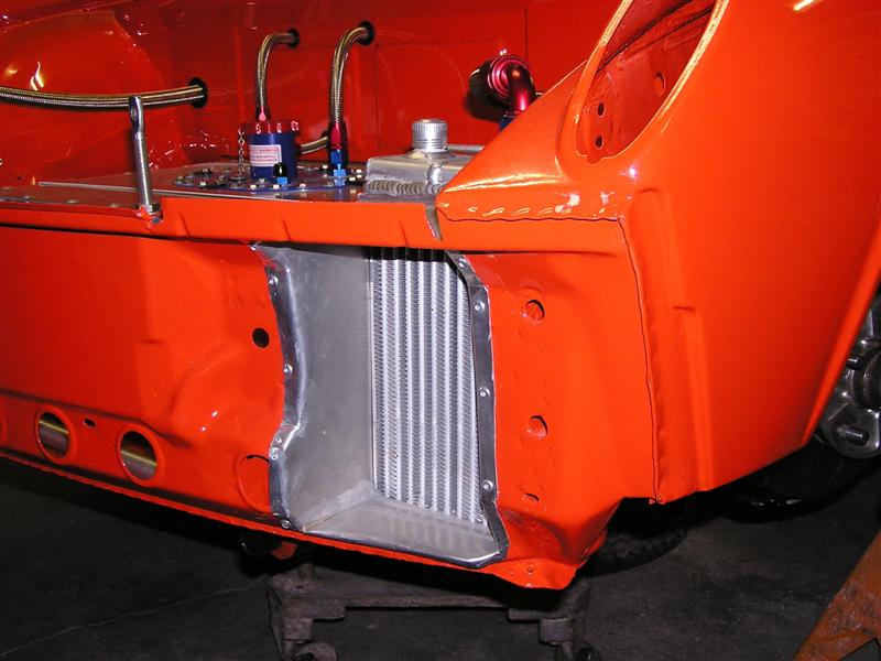

I thought I would throw in my two cents, here is the installation I'm working on that uses two small coolers. I wanted to keep as much usable trunk space as possible. I'm using 90 degree fittings coming out of the coolers and everything fits under the tire cover which is raised due to the DPD AC condensor. I'm going to build ducting that wraps around the spare tire and exits out of the side of the fenders.
I am running the oil lines on the drivers side because the AC lines are on the other side. I did have a rear mounted cooler and fan but it didn't provide enough cooling.

Thanks for chiming in Dean. Your design looks interesting. Can we see more pictures? Like what does it look like from the front of the car?
I only have a 2.2S engine so it shouldn't be getting as hot as 3Ltr. engine.
I like how you are preserving the front trunk space.
I really want to do something that cools efficiently, the least invasive and the most low-profile/elegant.

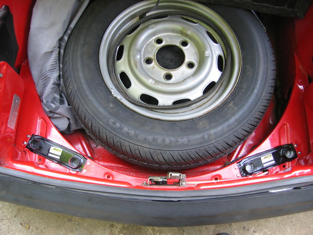

I've been thinking more about the spare tire preservation requirement and it has been brought to my attention by a co-worker that my full-spare only matches the front tires of my car. I have 205s in the front and 225s in the back. So my concern for its preservation are somewhat flawed. Plus I don't have a jack or lug wrench for the tires either...(IMG:style_emoticons/default/slap.gif)
So I'm back to focusing on the front cooler designs (IMG:style_emoticons/default/biggrin.gif)

I have been opposed to the front cooler mount because of trunk space and spare-tire preservation. But as I posted earlier, my full-spare concern is somewhat illogical (IMG:style_emoticons/default/biggrin.gif)
Copper or aluminum lines (IMG:style_emoticons/default/idea.gif) seem interesting. Not so flexible. (IMG:style_emoticons/default/idea.gif) I've heard that copper costs are shooting through the roof though. So much so that construction sites are being robbed and stripped of their copper plumbing (IMG:style_emoticons/default/ohmy.gif)
