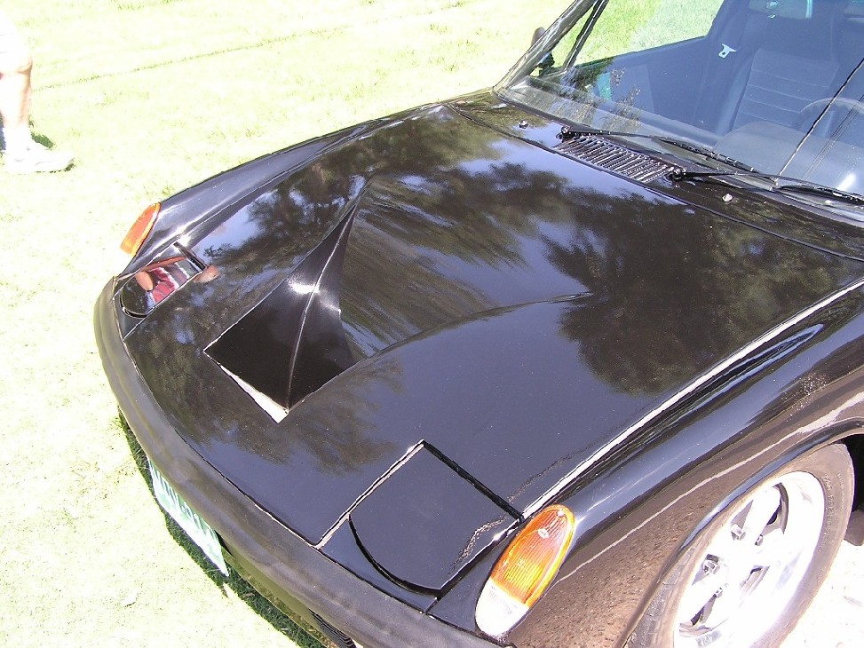

QUOTE(GTeener @ Jul 18 2006, 01:02 PM) *
QUOTE(brant @ Jul 18 2006, 11:38 AM) *
Gwen,
maybe just bite the bullet and go with the proven GT pieces?
(you said you were back to thinking about frontal coolers)
OK, so here's another issue that was brought to my attention with the GT design.... How noticeable is the lift created by the hot air venting out under the car?
The foglight design vents in to the wheel wells, so no lift.
And no, I don't want a vent cut in to my front hood (IMG:style_emoticons/default/dry.gif)
honestly... I never used to notice any lift.
I'm sure there is some theoretically, but not to the level that you can actually feel anything by the seat of your pants... (at least not my seat)
still... front hood is theoretically better
here is my front hood on my retired car:

There has been a lot of talk about the air vented through the front trung floor creating lift, but I wonder if the effect is really significant relative to a stock car. On a stock car with no front inlet where does the air that strikes the front bumper go. The front bumper is sort of bow-like and most of the air probably goes under the car. Unless you have an agressive front spoiler/air dam. Cut an opening, force the air through a cooler, vent it through the floor, where does it go? Under the car. I just don't think there is a big difference.
Now an exhaust through the top of the hood is another matter, and I think that may be beneficial from an aero standpoint.

Esthetically, the top of the hood exit duct doesn't appeal to me. My car isn't a hard-core track car. It gets tracked only recreationally (IMG:style_emoticons/default/smile.gif)
Most of my driving is low altitude street flying ( (IMG:style_emoticons/default/busted_cop.gif) ).

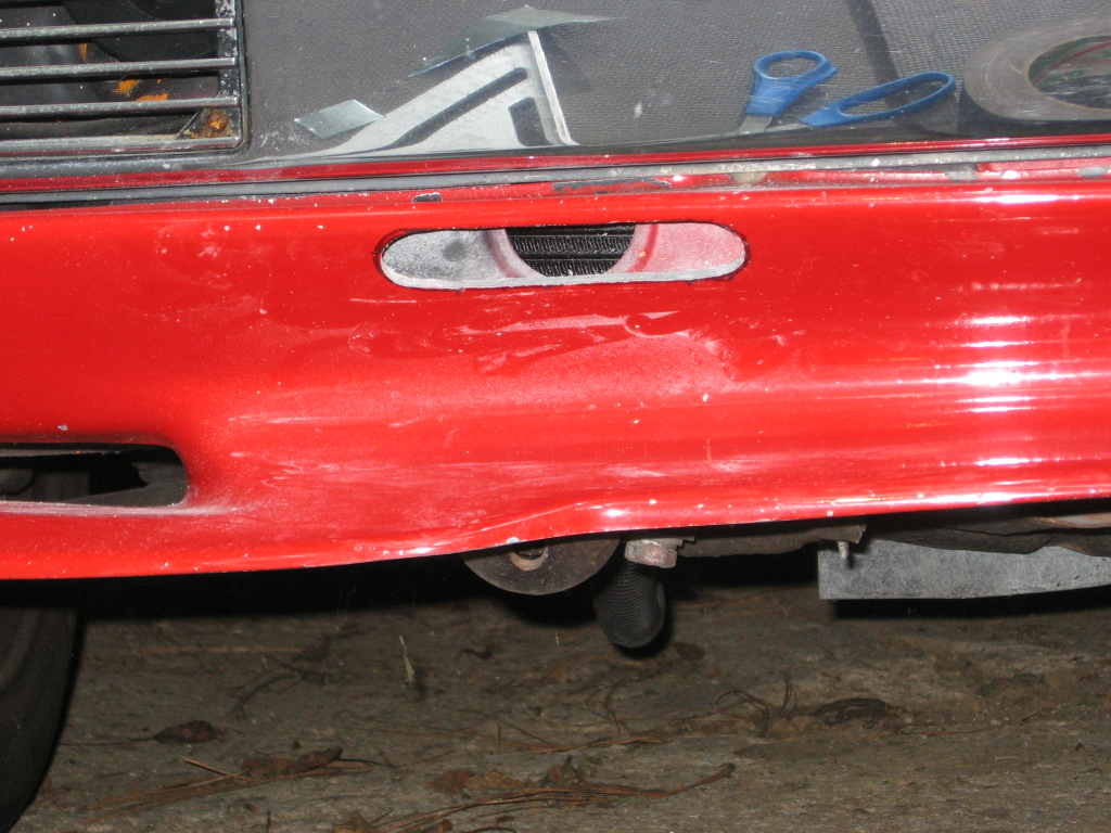

QUOTE(GTeener @ Jul 18 2006, 08:22 AM) *
Thanks for chiming in Dean. Your design looks interesting. Can we see more pictures? Like what does it look like from the front of the car?
I'm still hacking away at it. The holes I made in the front are pretty small, I may have to open them up but I wanted to try it out first. I have more pics at http://www.marinerc.net/914/front_mounted_oil_coolers.htm
GTeener

QUOTE(agrump @ Jul 19 2006, 11:08 AM) *
Thanks for the front view.
