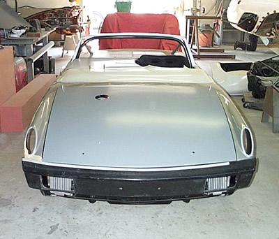

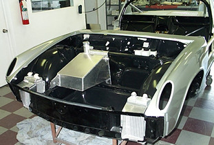

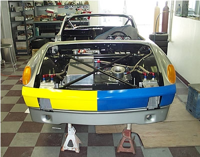

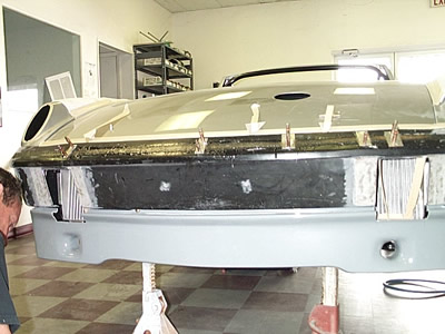

Gwen, here are some pictures of the Gunnar Racing 914 with twin front coolers. This wouldn't be something you would want to do to a street car but it tell you what can be done.
Attached Image Attached Image Attached Image Attached Image Attached Image Attached Image
