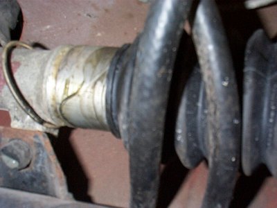

Use the 17mm socket to loosen the castelated nut on top of the tie rod.Attached Image

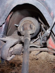

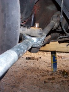

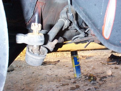

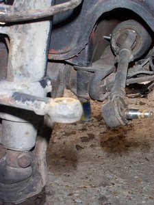

Then insert the pickle fork between the tie rod end and the steering arm which is attached to the front strut and use the hammer to loosen the two pieces. Wiggle the pickle fork between hitting it and the parts come right off. You can the swing the front brake assembley out of the way. Picture shows the bad tie rod flopped over, note the torn off rubber boot.

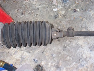

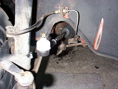

Next you have to remove the bushing and the support/steering limiter. This is shown below. It is the ball shaped yoke with the bolt thru it. You can use the channel locks or small pipe wrench to undo this part. When undone, the bellows and retaining springs will come off with some gentle pulling towards you. The bellows is the rubber part behind the bushing.
Unscrew the tie rod end off the new tie rod and set aside for now.

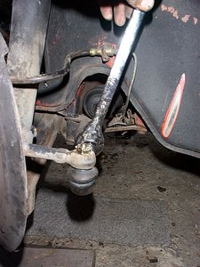

Next screw in the new tie rod to where the old one came out of. The big flat washer that is in the kit goes on the tie rod before it gets screwed in. It acts as a steering stop on the new rod.

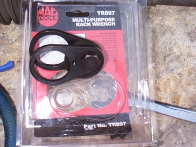

This is where you use the tie rod wrench. It slides over the rod and goes up against the flat washer and using a socket you tighten the cam on the wrench which tightens the tie rod to the car. You can buy a specialty wrench to do just these tie rods, but I opted to get one I could use on other applications.

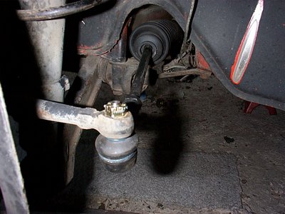

Next slide the retaining spring (off the old bellows) that fits the large end of the new bellows on to the end of the new tie rod. Then slide the new bellows that came in the kit on to the new tie rod. Big end goes on first.
Next you slide under the car to where you can see the end of the steering rack where the bellows attaches to the steering rack. There is a V shaped channel at this point.
Now you should be very glad you cleaned the area of anything sharp by now or mabey the pain keeps you focused while your laying under the car. (IMG:style_emoticons/default/biggrin.gif)

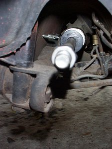

Now use the two pair of needle nose plyers to grab the sides of the bellows and wiggle it on to the steering rack, till the first grove goes into the V channel. Slide the retaining spring on to the first groove and that part is done.
I tryed for a long time at this point to get the outside portion of the bellows on to the the new stop and then add the retaining spring and finally gave up on that idea and went and got a zip tie to attach it. Put the zip tie on till it just starts to click and push the bellows back with one hand till it's in place and then pull the zip tie tight. Trim off excess zip tie with plyers. Shown snipped off in the next picture.

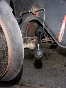

Next screw on new tie rod end.
Remove the nut and protective cap.
Size up the alignment. This can be done by putting the tire back on and checking the measurements you made with the straightedge and ruler when you started (now where did you put those measurements?). You adjust the tie rod length by screwing it in or out till it matches the steering arm.
Insert the tie rod into the steering arm and install the new castel nut and the new cotter pin (supplied in the kit).
