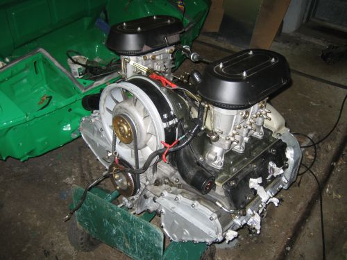

I know this is just an engine, and that it don't look like much, but it's a 6 cylinder. Specifications are as follows:
Cylinders: 6
Stroke: 66 mm (short stroke)
Bore: 89 mm
Crank: 2.0 / 2.2 counterwheigted std/std
Case: Late 7R
Pistons JE pistons, 10.5/1 nominal compression
ignition: Electromotive HPV1, twin plug
Camshafts: GE80
Fuel: PMO 40 MM carburetors
Venturies: 36 mm
Jetting: details to follow
Ports: I 36 mm / E 36 mm
Valves: Standard
Valve springs EBS sport springs
Expected redline: 8,000
Expected HP: 225 - 250 hp
And here a re a few pictures. I am having a close ratio gearbox built. As soon as that is done (early next week) I will bolt the assembly into the car.
Cheers.

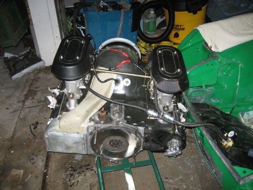

From the back:

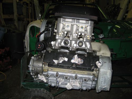

From the side.
Ignition wires still need to be sorted out.

What is the total displacement? You really think 250hp?

See this thread:
http://forums.pelicanparts.com/showthread....ghlight=grenade
217 hp at the rear wheels, and it's a single plug. He does use 46 mm carbs, though.
