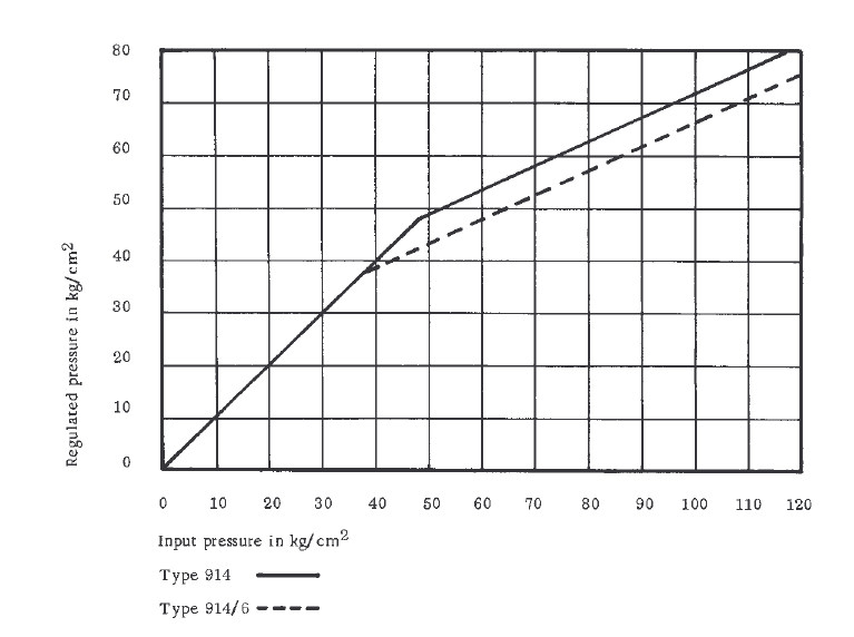

The stock valve is a proportioning valve (pressure regulatiing valve). Here is the factory pressure curve.

Correct.
In a panic situation. The graph shows the relatively high pressure it takes before it slows down the fluid to the rear calipers.
Porsche calls this a "damper'
B

QUOTE(Brad Roberts @ Jul 29 2006, 05:59 PM) *
Correct.
B
Porsche calls this a "Brake Pressure Regulator" and the curve looks the same as the Wilwood, Tilton, and Kelsey Hayes valves, as that is what they are.
It may also be called a damper by Porsche somewhere, but this does not mean it is no longer a proportionaing valve, which it is.

Looks the same when?
When the Wilwood and others are wide open?
Every single time I have installed an adjustable brake bias valve (Wilwood etc) Every time.... I have had to run them wide open. At that point, why run one in a stock system?
JWest
post Jul 29 2006, 05:47 PM
Posts: 1,665
Joined: 6-January 03
From: Fort Worth, TX
Member No.: 97
QUOTE(Brad Roberts @ Jul 29 2006, 06:23 PM) *
The stock valve knee point occurs at about 680 psi. This is equivalent to position 4 (out of 7) on a lever type Tilton valve, or about midway on a rotary Tilton, Wilwood, or Kelsey Hayes.
Now, whether the stock valve is set appropriately is another debate, but saying that putting a tee in is the SAME as a stock valve is not a legal situation I would want to place myself in. A rising limit starting at less than 700 psi is definitely effective, and is not well above what you may reach in threshold braking.
The 914 may welll brake better with the valve gone, just as dialing out understeer in most production cars will make them corner faster, but it is not something you just lay out there for the uneducated.
