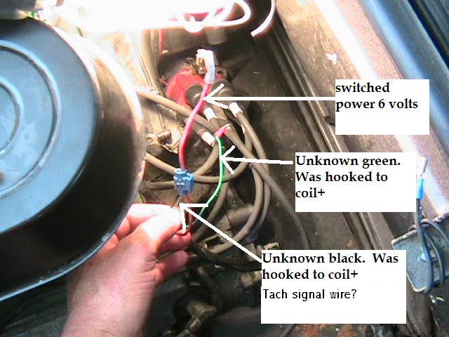

I would go this route. Your tach should work without adapters with the MSD system. That 3 pin CD box was used, there is no telling how many miles it has on it and it's still close to 30 years old at best. Time for a newer system maybe?
The only wire left is the black one that was hooked to the coil+ so it must be for the tach signal. I've pretty much figured out the rest of the wiring so I'll go that route and see what happens.

Hopefully you have not just plugged in the black wire yet to see if it was the tach? I would recommend pulling the tach out of the dash, unplugging the feed wire and grounding it and then checking the other end to ground with a ohmmeter. Then open the connection at the tach and see if the resistance changes. If it does not, then check it for 12 volts with and without the key on. If you were to fry the MSD box after all this it would be a shame.

QUOTE(john rogers @ Aug 11 2006, 06:21 PM) *
I'll make sure to do this before I plug it in.
