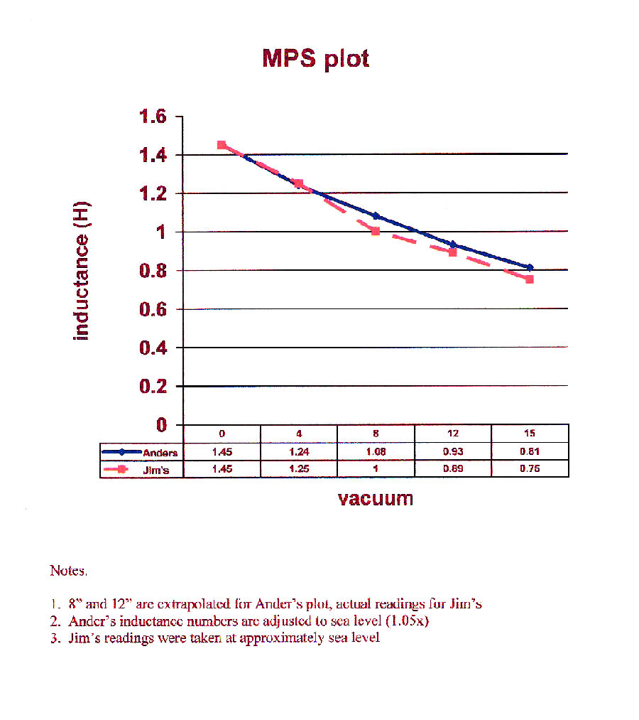

Also, my LC meter arrived yesterday. I did a quick check on inductance at 0 inches Hg, and whatdayouknow? 1.45 H. EXACTLY the inductance Paul Anders specified for a -043 MPS (after correcting his 1.39 H for sea level, where I'm at).
That was great news, but that's at 0 inches, and my problem is at part throttle, probably 6-12 inches. But at part throttle, the inductance is varied only by the aneroid cells, and if one or both were leaking, I think I would see less than 1.45 H, so I think my aneroid are OK, and since the MPS holds a vacuum overall, it should be adjustable if it's out at the other vacuum levels.....

Ok, WOT is good on the MPS for a 2.0L stock.
What is the inductance at 4 hg?? This is the reading for partload as the outer screw is set against the stop plate for this reading. This then sets the inductance scale from 4 to 15hg which is the transion phase from idle to partload where most of us do our driving.
This is why the "flex" of the diaphram is so critical for smooth running and soldering stiffens up the diaphram giving it problems. I also think this is why OEM MPS's run smoother than even the Brett rebuilt units as they have a different pleating on the diaphram than OEM.
The shudder could just be the dizzy adv plate sticking as it spins up the adv.
or the MPS partload setting isn't right for your car. Most of the driving occurs at 2500to3000rpms normally, so that is where the critical setting occurs.
The old Kjell Nelson article had you adjust the center screw at 2500rpms but that changes the idle settings too which I don't think he understood. But, it does give you a better partload setting/running for a quick fix.
With the hydro cam I am not sure what problems it coud cause with the djet as the hydro cam I have seen are pretty steep ramps compared to the stock solid cam. (IMG:style_emoticons/default/confused24.gif)

Here's the plot. Mine is Red, Paul Anders' is blue/black.
Not sure the hydro cam would do the shudder. It's almost exactly stock timing- 2 degrees more duration at 1mm, which may only be longer ramps. People use much more aggressive cams than this with D-Jet, I think.
It feels like ignition. Or lean miss maybe I guess. My curve is slightly leaner than Anders', but then I also have that ballast resistor that I'm not supposed to have which would probably more than make up for it. I suppose the ECU could be hosed. Fuel delivery is OK, because it runs great >3000 RPM.

At sea level you should be at 0hg 1.45, 4hg 1.19 and 15hg .76 as those are the readings I get with my NOS 043's using a Wavetek meter. Yours is adjusted to 037 spec.
Long story short, you are running rich at partload and idle. Aw, its only a little bit off but its a lot in terms of A/F ratio if you put a LM1 w/o2 sensor to test in.
Pull the MPS apart and adjust it to spec. You can just remove the WOT stop by burning the expoxy off and screwing the stop in all the way and cleaning the thread until the stop comes out cleanly. Then adjust the inner and outer screws to spec and reinstall the stop to spec. Put a piece of tape over the wot stop and drive around to test it.

OK, so the Anders numbers of:
So, for a 0 280 100 043 MPS, the 0, 4, and 15 in. Hg calibration values would be, 1.45, 1.24, and 0.75 H, respectively.
are incorrect? That would be good news, because at this point, anything that fixes it is good news....

His numbers are based on using a correction factor and taken off 2 rebuilts and one used factory 043.
My number is based on 2 NOS 043 units at Sea Level. (well, my house is maybe 50ft in elev.) Paul's house is at 1280ft.
Try my numbers and see how it runs.
Everyone remember, the best and surest way is too measure the A/F ratio on your own car with a wideband. Either on a dyno or doing test runs with a LM1 meter. The Wavetek method is a via electronic standardization similar to what Bosch did. The Factory states the A/F ratios to be 13.7 to 1 for partload and 12.5 to 1 at WOT. We don't know exactly what the numbers the Factory used other than measuring the units we have.
The NOS units I have tested on a couple of cars just to see how they run compared to old units. They run crisper, meaning the idle/partload transision is much smoother than the Brett rebuilts or god forbid, AA units.
My Raby cammed 2056 MPS runs at .81,1.44,1.74 to set the A/F ratios of 13.6 to one at partload and 12.4 to 1 at WOT. Makes good power too. (IMG:style_emoticons/default/driving.gif)

either reset the MPS to my numbers or due to the hydro cam try to adjust it by ear. Take off the WOT stop
1. warm up the car
2. have a friend try to hold the rev's at 2500rpms via the gas petal
3. adjust the inner screw to the best running you can as your friend battles to hold the rpms steady at 2500. (its tough cuz its gonna go up and down as you adjust the screw slowly). You will find the "sweet spot" if you go slowly, this should be fairly close to 13.5 to 1.
4. shut off the engine and check your readings via the inducance meter, reset the WOT stop to spec. tape it.
go for a drive....and see if it improves any. This is the shadetree MPS adjustment method and will "get you home". To really set it up you have to use a wide band meter to set the A/F.

I'll start by setting to your numbers using my LC meter. That way I can get the feel of setting it off the car, and maybe get it closer. I'll follow with the test drive and the reset by ear, as you suggest.

While I waited for my the injectors to arrive, I spent A LOT of time checking curves on MPS, but in the end, I test drove with my original one. In fact, every thing I've tried has been one change at a time, so I could see what happened.
Anyway, when I got the filter and the new injectors installed, I took it out for a test drive. The mid-range shutter was GONE! (IMG:style_emoticons/default/smile.gif) The bucking was GONE! (IMG:style_emoticons/default/biggrin.gif)
