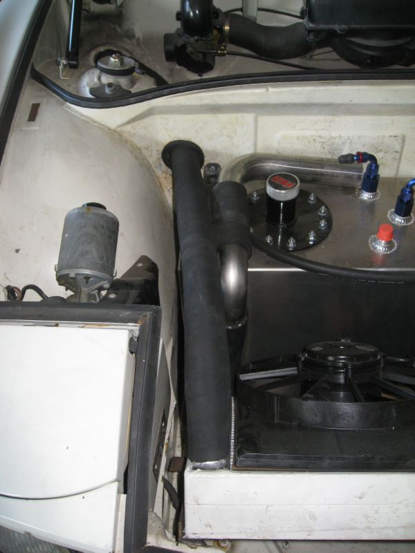

the radiator and fuel cell sharing the same cramped space should result in a rise in fuel temp - could this be an issue or benefit ??

QUOTE(jimkelly @ May 18 2008, 06:26 PM) *
The duct I plan to make should shield the tank from direct contact from the heated radiator air. It still could be an issue though and is something that I intend to keep an eye on.

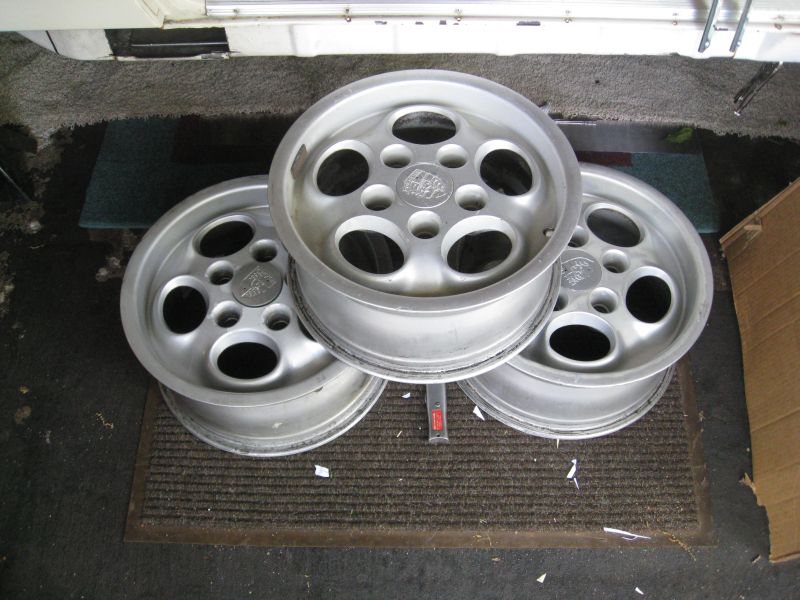

I picked up some 15x7 Phone Dials on ebay this week. I am not planning to do the 5-lug conversion anytime soon but got a smok'n deal that I could not pass up. Now I just need the 4th. They will be powder coated before going on the car.

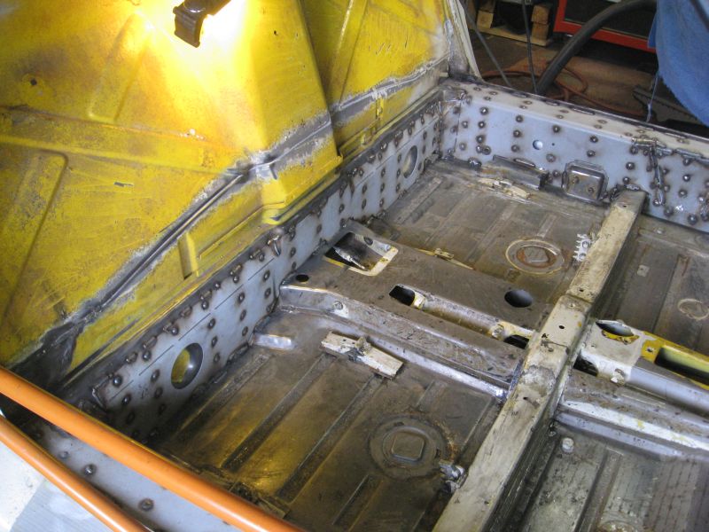

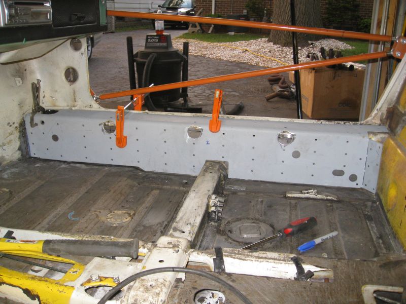

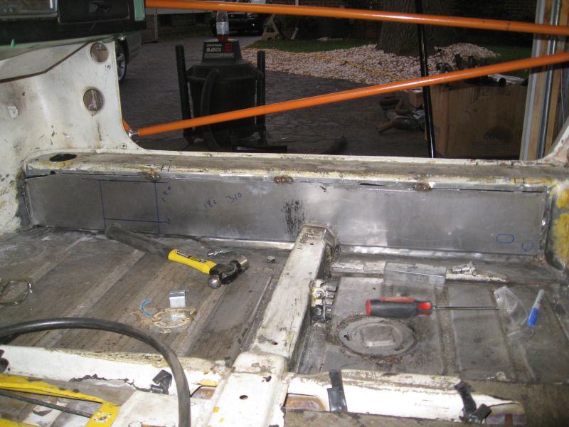

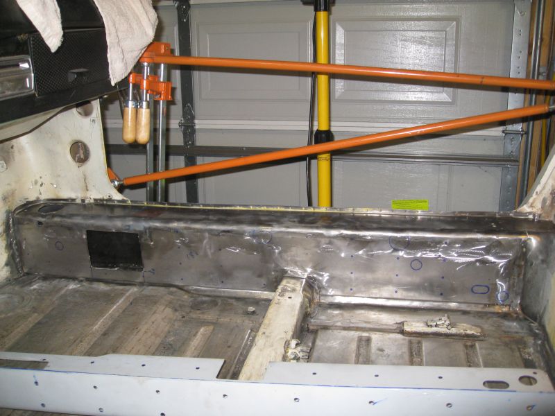

I finally filled the gaping hole in the passenger side long. In order to make sure that everything is straight and that the reinforcement panel fits, I used it as a guide. I made three windows to the weld seam with a hole saw and clamped it down. The floor and pinch seam are already tacked in place at this point.
Decent gap...
Tacked
Ready to be welded shut (IMG:style_emoticons/default/welder.gif)
It was getting late so I put in a few more tacks just to make sure that everything was in place. Before calling it a night I decided that it would be ok to get into the car again. Seems silly but after working bent over the door supports for several days the idea of working from the inside again is something to look forward to. My lower back has been taking a beating. (IMG:style_emoticons/default/pinch.gif)

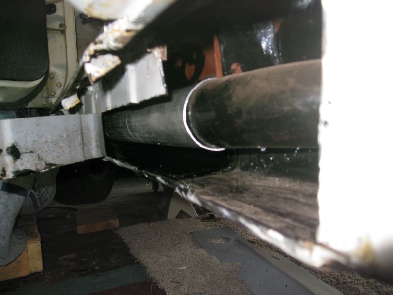

very nice...what size piping is that for the cooling line? ARe you running one on either side?

QUOTE(cobra94563 @ May 27 2008, 09:05 AM) *
I am running one on each side. The line to the radiator is 1.5 and the return is 1.75.

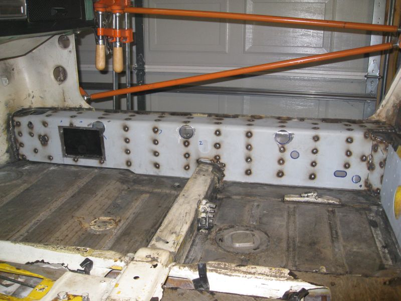

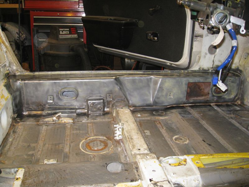

Finally...I have all of the rust out of the longs. It is like the last 2 months never happened. (IMG:style_emoticons/default/headbang.gif)
Back to progress (IMG:style_emoticons/default/aktion035.gif)
Still a bit of welding to do and I need to install the seat belt mounting lug. I have not decided if I am going to run the plumbing through the passenger side before getting the driver side ready for plumbing. Probably should finish up the passenger side just in case there is an issue that requires changes that I could carry over to the driver side.

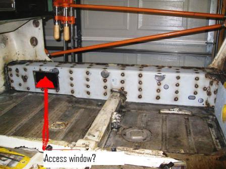

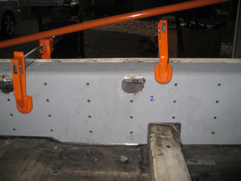

Attached ImageWhat is this in the long?

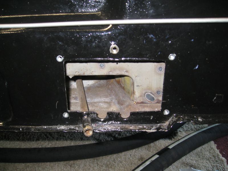

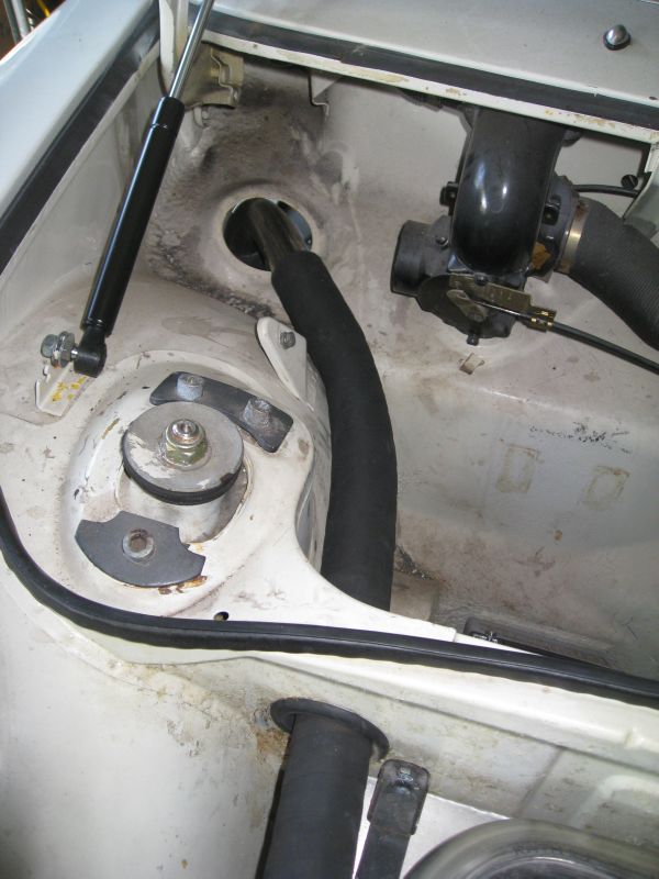

QUOTE(Zaney @ May 28 2008, 10:15 AM) *
It is an access hole so that I can connect the SS bend to the Gates hose.
You can see the area here, just below the vertical locking pliers:

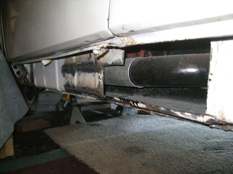

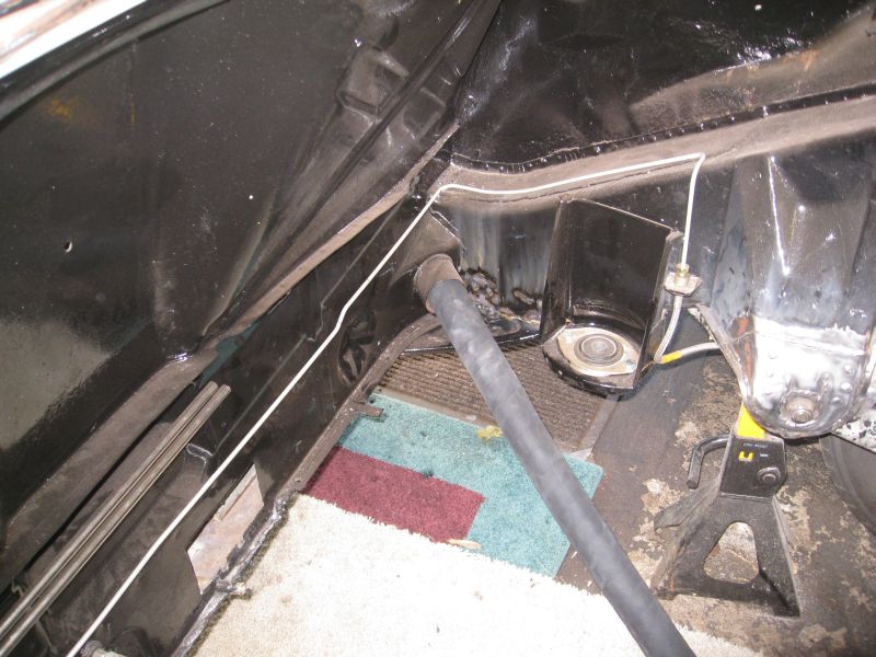

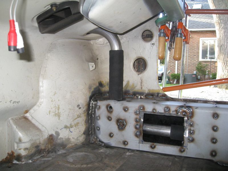

Ok...so here is how the passenger side cooling line will be run.
From the Radiator
Through the heater hole
Into the long
And into the engine compartment...boy is it dirty back there.

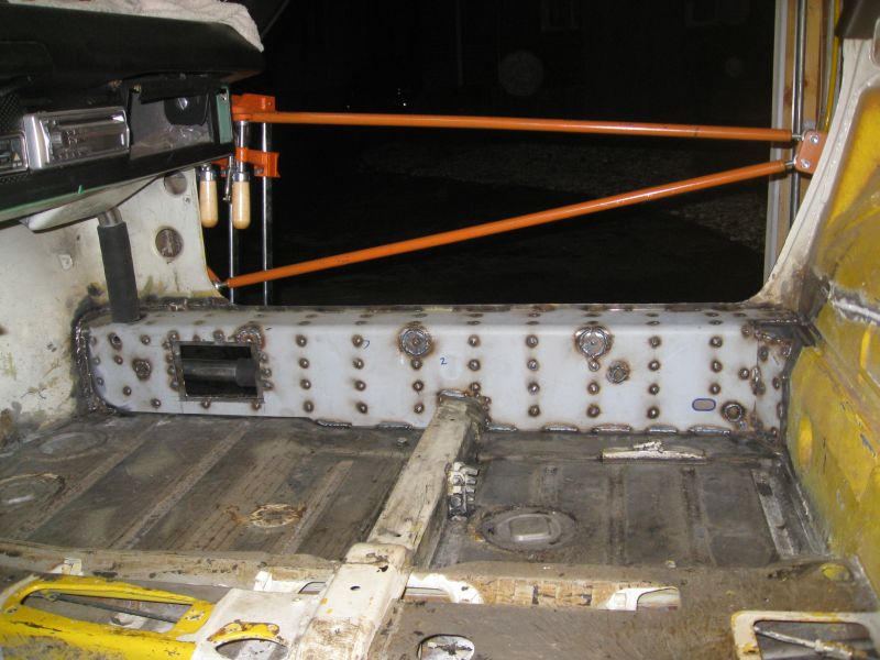

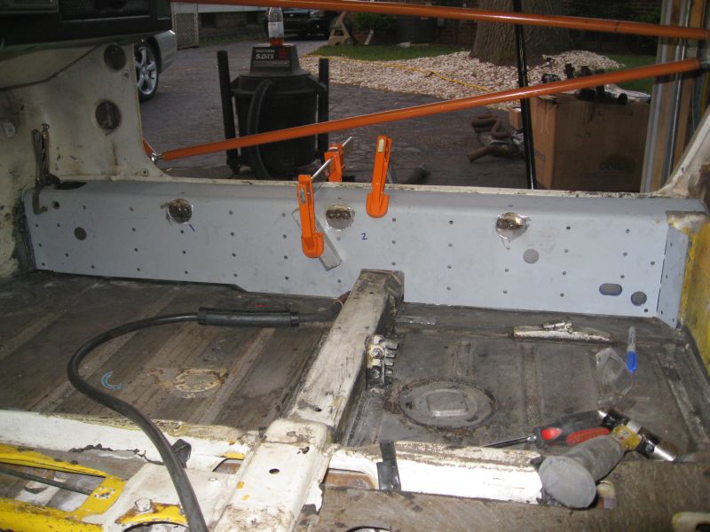

Finished welding in the passenger Engman reinforcement...put a few extra welds in for good measure and because I was enjoying welding. (IMG:style_emoticons/default/welder.gif)
Cleaned up the driver's side. No surprises here!!

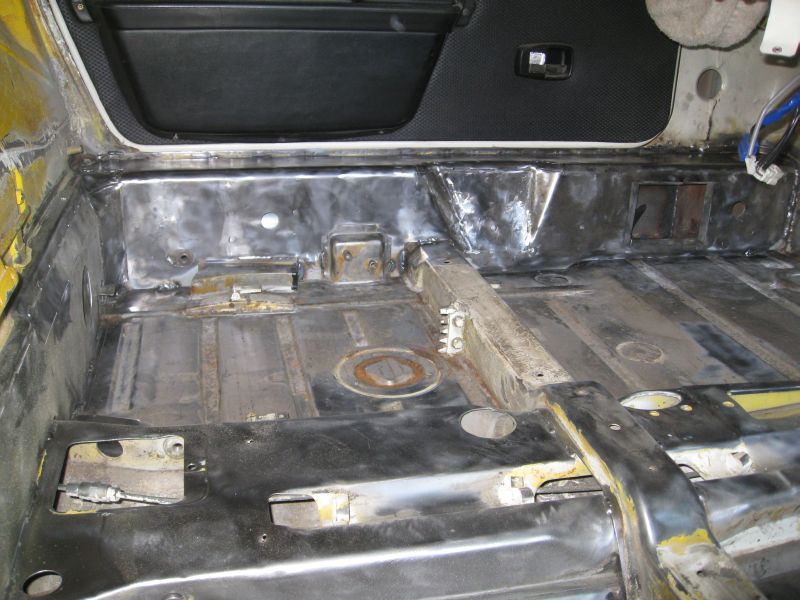

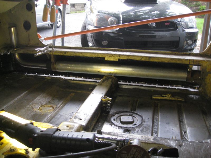

I have not posted an update for a while but not because of the lack of effort or progress, just have not been doing anything that a dozen other people have not already posted a more novel or skillful implementation. So here are the end results...
Finished welding in the Engman reinforcement kit. (IMG:style_emoticons/default/welder.gif)
After a load of grinding.
Finished repairing the pedal area.

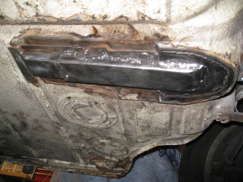

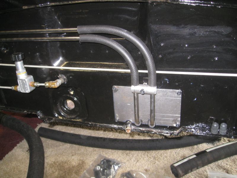

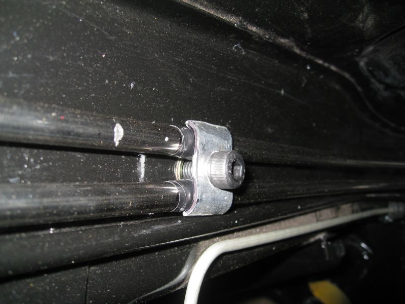

Installed the driver side cooling line support. Had to cut open the long to get it in.
Welded back up.

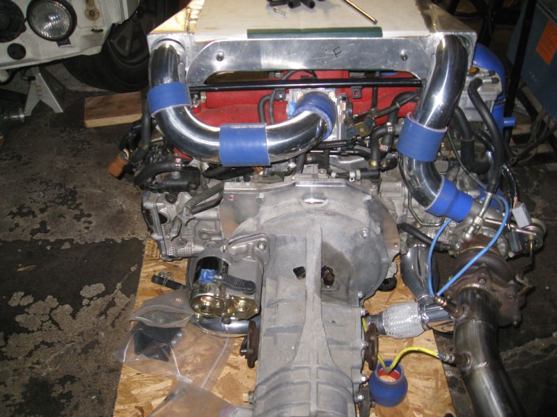

Worked on the engine plumbing a bit. Cleaned up the crank case vent hoses and rerouted the turbo cooling lines.

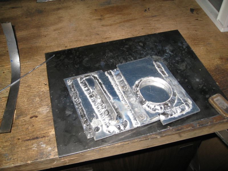

I have been spending hours practicing Tig welding Al. It is as challenging as everybody told me it would be. I am making strong welds but not quite as nice looking as I want considering the high profile locations I need to weld on the intercooler and the radiator. This is my creation from this weekend.

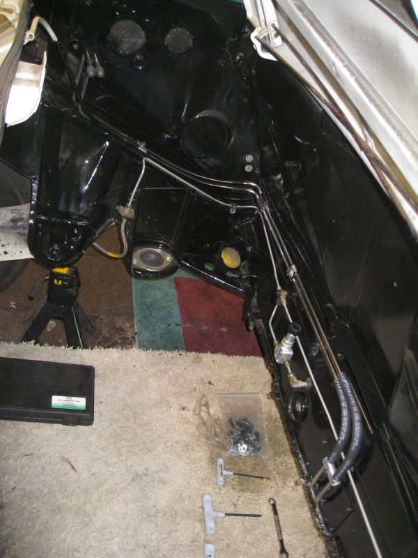

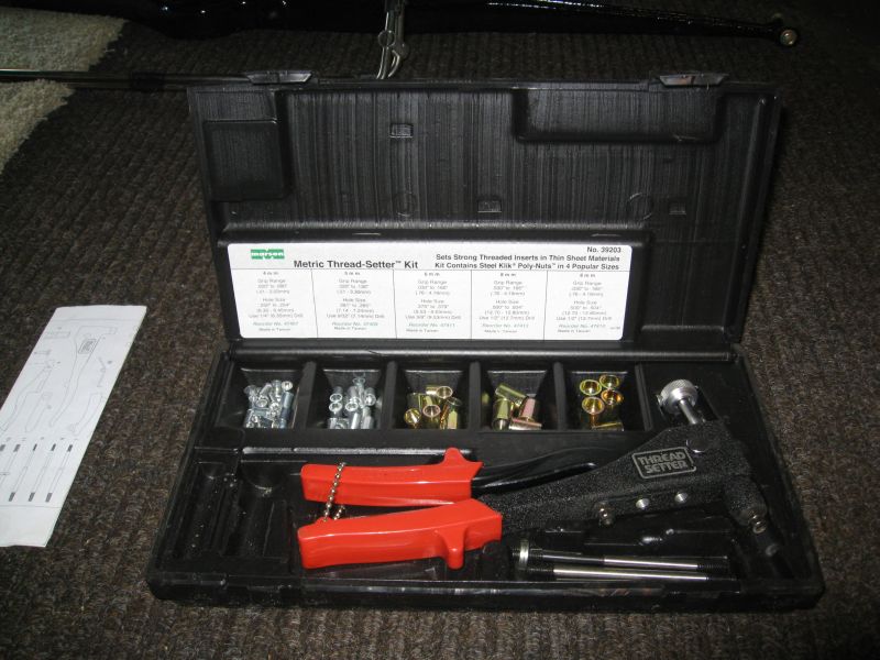

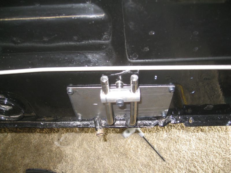

Made bit more progress today. Made another mount for the fuel lines and a cover for the access hole into the center tunnel.
I think that next to the tig welder, nutserts are my second favorite tool. No more sheet metal screws for me!!

What tool did you buy and where did you get it to use the nutserts?

This is my nutsert tool
Nutserts for the plate and fuel line mount
Another fuel line mount using a nutsert.
All of the fuel pump and filter brackets use nuserts. I started installing nutserts for the rear valance and will use them for the front valance as well.
Finally, the fuel lines are in for good. (IMG:style_emoticons/default/cheer.gif)

So where did you buy that handy tool. Looks like a great tool to have.

QUOTE(Phoenix 914-6GT @ Jul 13 2008, 05:07 PM) *
Nice work.
Picked it up at Grainger:
Edit:deleted bad link
