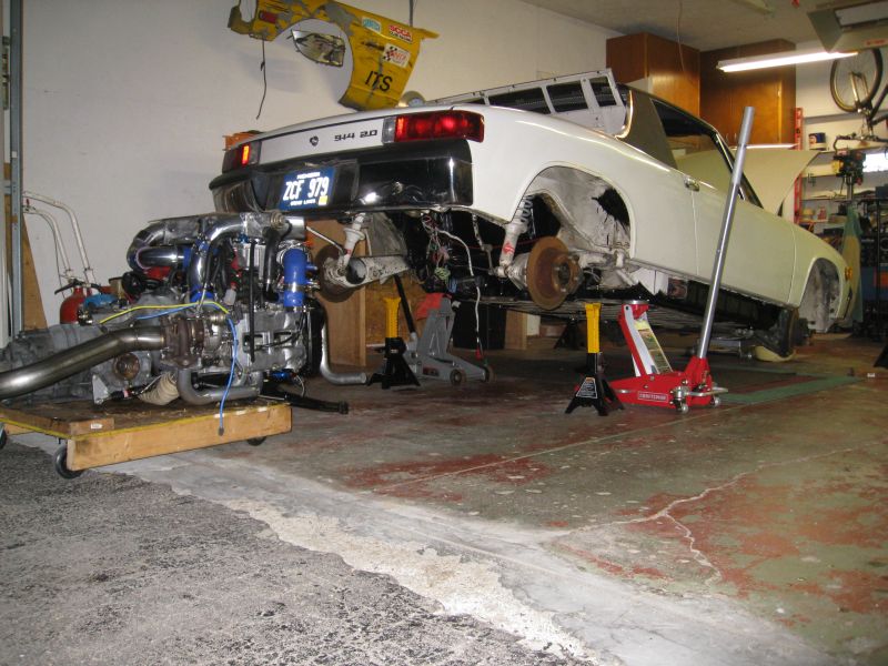

As the title states my project has turned a critical corner. After may months of planning and measuring and prognosticating how great it will be, I put down the sand blaster and stripping pad and got down to real work.
I purchased my 914 with the plan of dong this swap. The motor is from my ex-daily driver that I managed to shorten a bit. The 914 that I am starting with has been restored once before and had a decent autocross suspension. The first thing I did to it was to upgrade the front calipers to 3-series BMW. It is not perfect but is pretty clean and straight. The only part that had not been repainted was found behind the heat/sound pad in the engine compartment. The plan is to repair some shoddy patch work in the battery tray area and repaint the engine compartment once all of the fab work is complete for the swap.

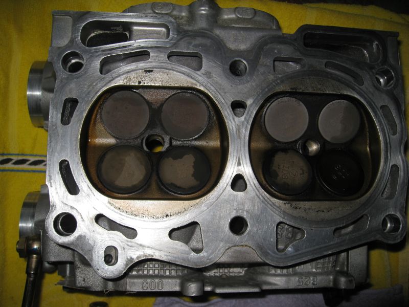

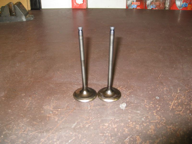

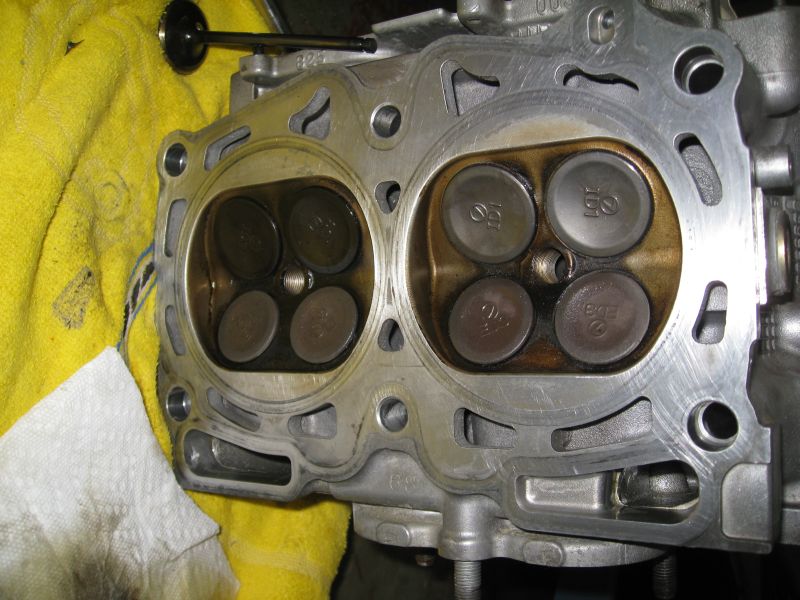

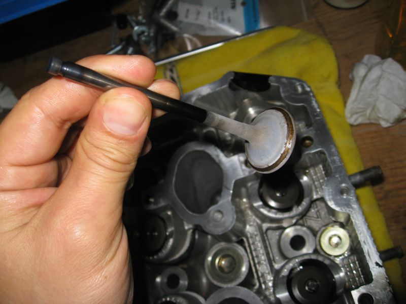

When the timing belt broke 2 valves were bent so a teardown was necessary:
(IMG:http://www.914world.com/bbs2/uploads_offsite/www.digitaldash.org-4154-1328899178.1.jpg)

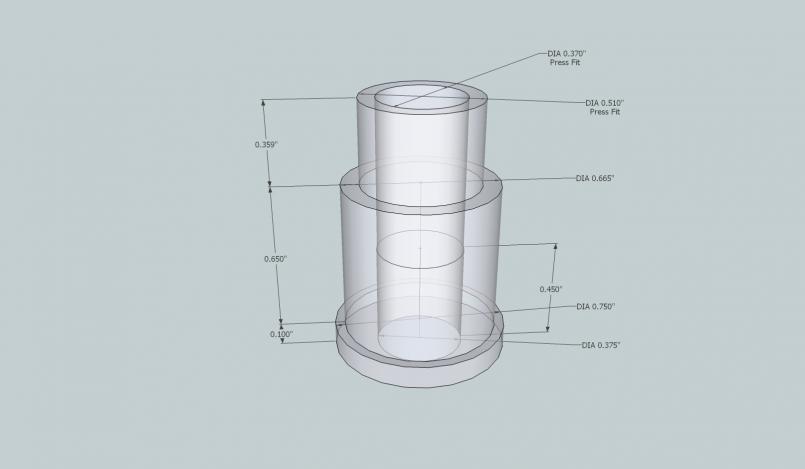

Due to the obscene cost of the Subaru tools to remove the valves I, made my own:
(IMG:http://www.914world.com/bbs2/uploads_offsite/www.digitaldash.org-4154-1328899179.2.jpg)

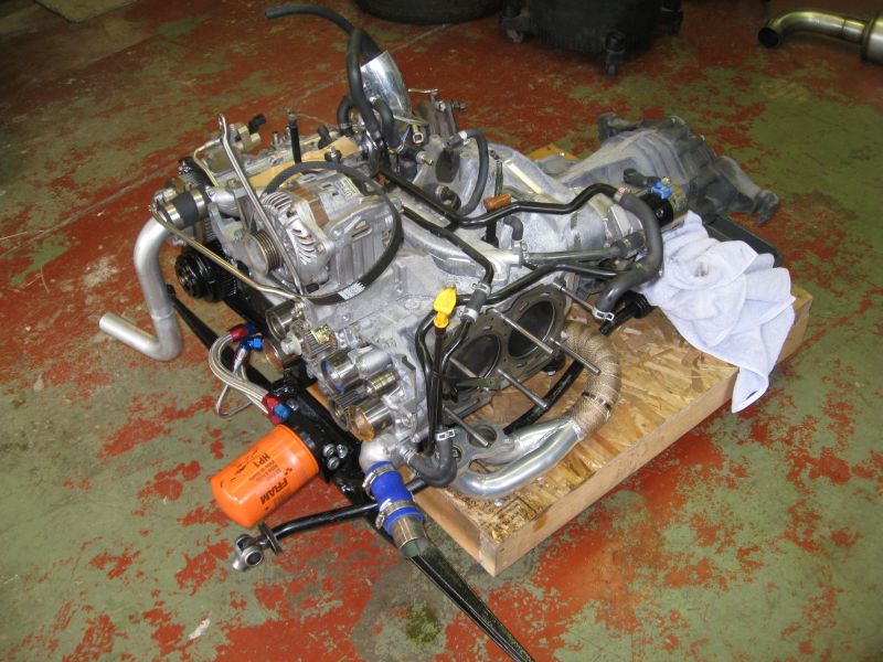

Put the engine back together and attached it to the trans:
(IMG:http://www.914world.com/bbs2/uploads_offsite/www.digitaldash.org-4154-1328899179.3.jpg)
Slipped it into place and attached the trans mounts:
(IMG:http://www.914world.com/bbs2/uploads_offsite/www.digitaldash.org-4154-1328899179.4.jpg)
Here is a picture of the unmodified Small Car Performance engine brackets mounted to the bottom of the engine. They wrapped nicely around the oil pan. There was a slight interference between the water line from the oil/water cooler that required a notch.
(IMG:http://www.914world.com/bbs2/uploads_offsite/www.digitaldash.org-4154-1328899179.5.jpg)
