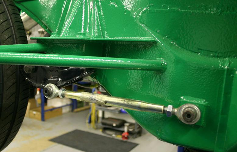

QUOTE(mepstein @ Jul 4 2016, 06:43 AM) *
what is the reason for the modified trailing arm brackets?
Primary reason is so that I can install a toe link to make adjustments easier.
The rest of the welding is to reinforce the spot welds to stiffen it up a bit.
Cheers,
Scott

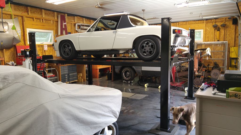

I had a pleasant surprise this week. One of my wife's co-workers bought a lift and she proposed that we should get one also. The ceiling half of the garage was designed to be high enough to stack most things I might buy but I was not actually planning to get one in the near term. I called up the lift company, negotiated a deal (much better than her co-workers (IMG:style_emoticons/default/shades.gif) ) and it arrived Friday afternoon. Few hours assembling it on Saturday and....
It will move to the stall with the C10 once I pick up some more hydraulic fluid so that I can raise it high enough. Now I just need to get the C10 on 4 wheels so I can park it on the lift and then I will have room to work on Grey Matter (IMG:style_emoticons/default/smash.gif) (IMG:style_emoticons/default/sawzall-smiley.gif) (IMG:style_emoticons/default/welder.gif) (IMG:style_emoticons/default/smilie_pokal.gif)

Need to notch that C10 frame, I think you need clearance them C10s are tall beasties. Would help a lot if it could sit down on putting grass levels (IMG:style_emoticons/default/shades.gif) (IMG:style_emoticons/default/poke.gif) (IMG:style_emoticons/default/poke.gif)
Nice score on the lift, I was not expecting your wife to approve anything that put a couple tons up in the air. Figured that would set off all the safety alarms. I know my fingers distracted her. (IMG:style_emoticons/default/laugh.gif)

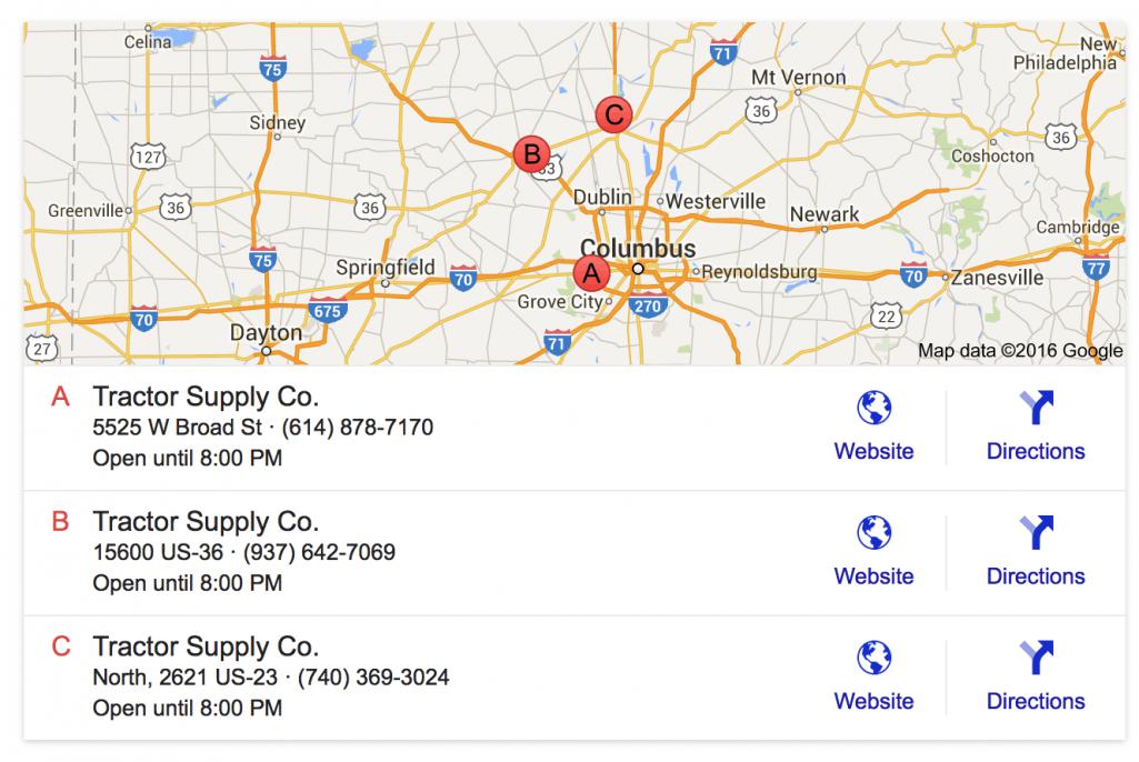

You all are deprived of Tractor Supplies (IMG:style_emoticons/default/confused24.gif)
And Rural Kings, man that sucks, you can buy Hydraulic Oil buy the drum there. Looks like the small jugs for you, let me know if you can't find some locally.
Voss Brothers up in Powell should have what you need, as wold any hydraulic hose dealer, Parker store in your area.
Never bought the stuff, at a big box store before, Napa might be another place to get it in larger quantities. Of course the guys dealing in Cat or JD construction equipment will have it also, but you pay CAT and /JD markups for the yellow and green and gold bottles.

I already have a C-notch that will get it in the grass if I don't cut it for 2 weeks. (IMG:style_emoticons/default/slap.gif)
She did already check out the warning labels and refuse to go for a test ride on the lift. She also confirmed a half dozen times if it should be bolted to the floor.
I get the fluid from a local Parker store. I also have some JD fluid on the shelf but did not want to mix.

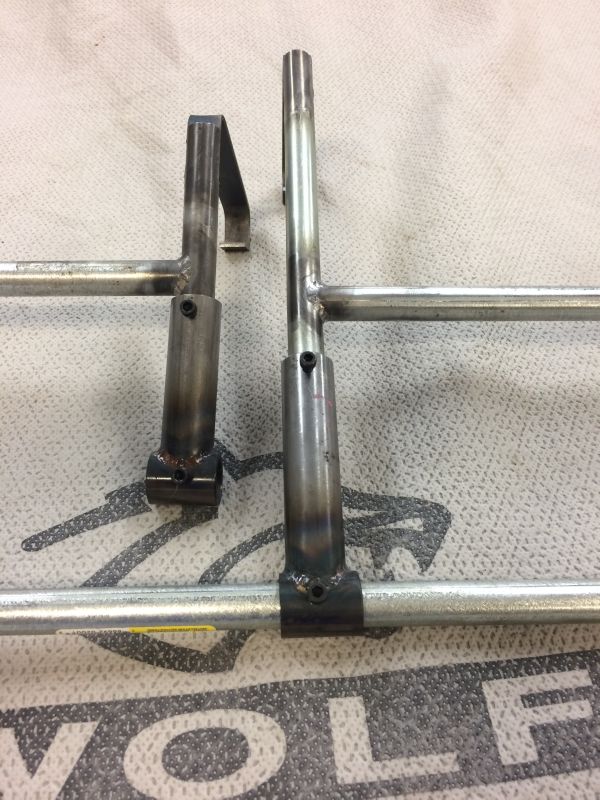

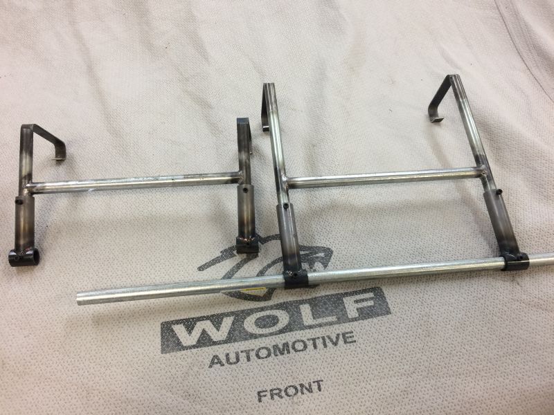

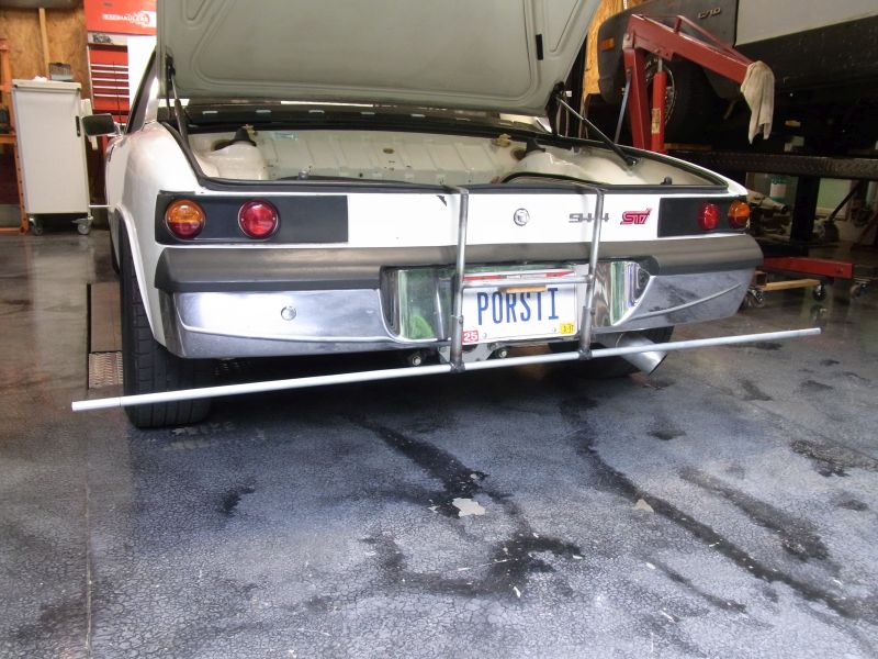

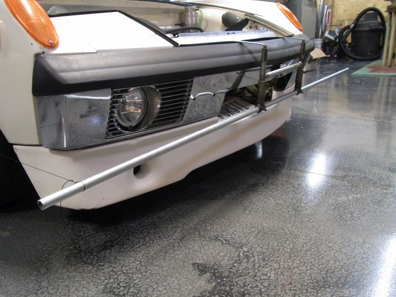

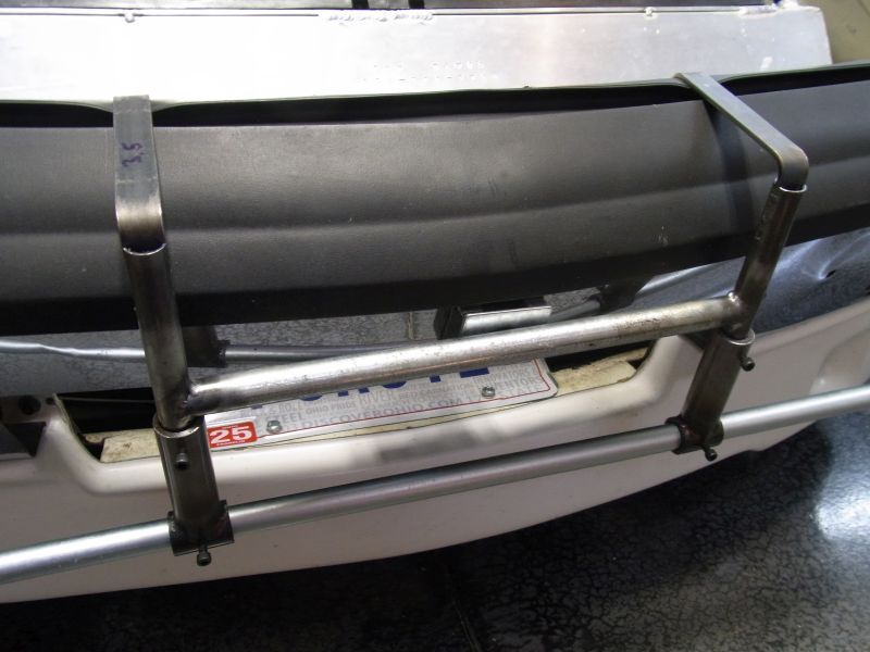

Europe is on summer vacation and Japan is on Obon so I figured it would be a good week to take a couple of days off to play in the garage and recharge. Looked at the to do list and decided alignment strings would be a good place to start.
Drew up a quick sketch and headed to the metal store. Unfortunately they did not have so much thin walled tube so I had to use 1/2 emt which is perfect...except for the galvanized coating which is not so much fun to breathe. The knotcher paid for itself on just this project alone. Perfect fitment makes for easy fun welding.
I still need to find adjustable bumpers so that I can get rid of the block of wood and stack of spacers.
I could not decide how to hold the string in place until I was using a tube cutter and noticed the nice grove it left in the tube before it cut though. Work perfect.
Equal length strings and equal spacing makes parallel strings no matter what.
Did a quick alignment to fix the "pro" job and it is pretty nice. Still need to set the corner weights and it should be perfect.
Cheers,
Scott

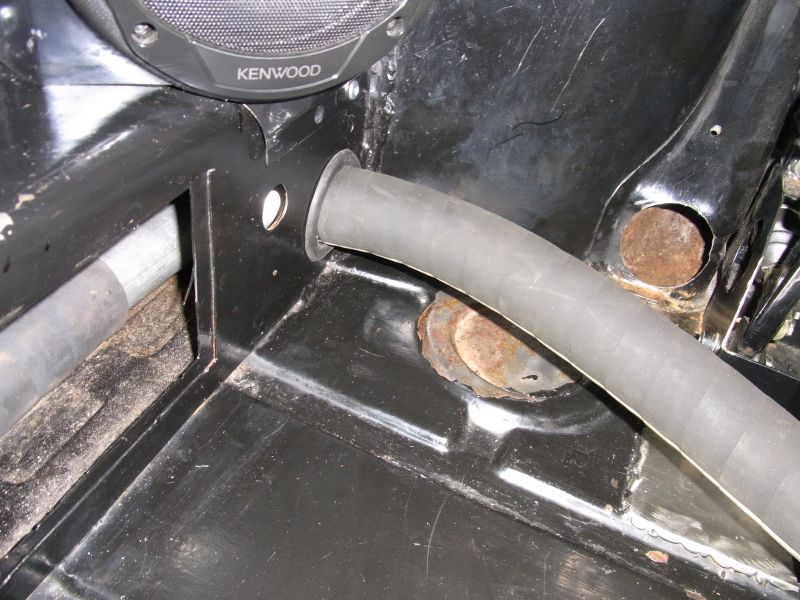

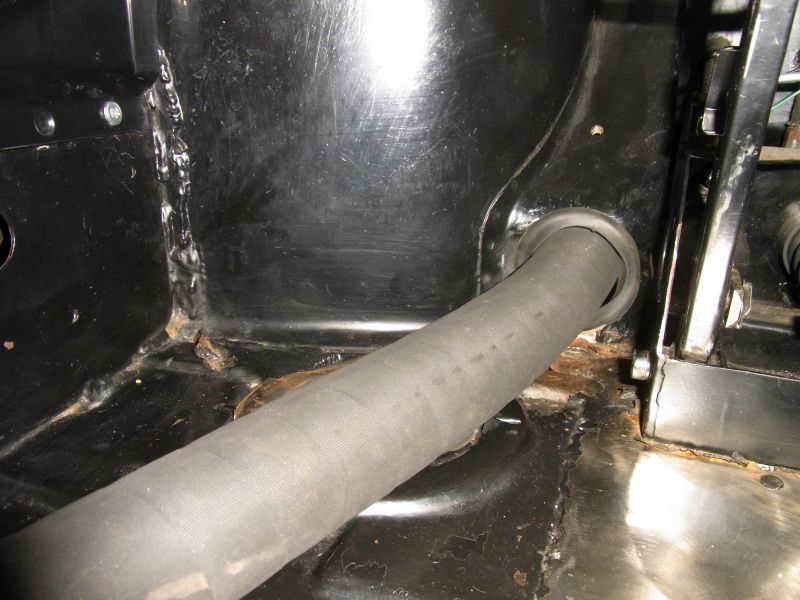

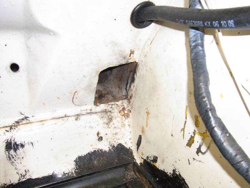

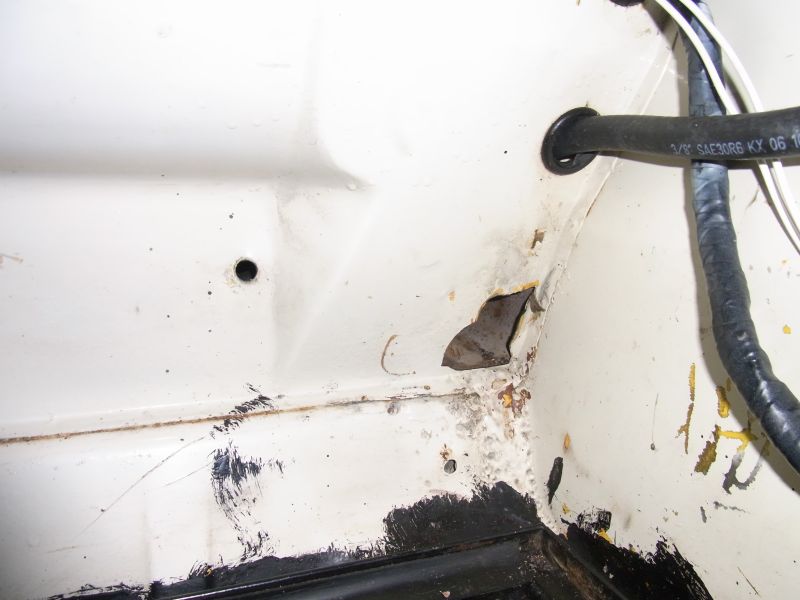

I figured out my rattle....what it was exactly, I have no idea. I gave the engine bay a quick wipe down before going to Cars and Coffee and it just stopped. Pretty sure it was one of the engine connectors vibrating. I wiped under the connectors on both sides and positioned them a bit. I thought that I had zip tied them so they could not vibrate but maybe not.

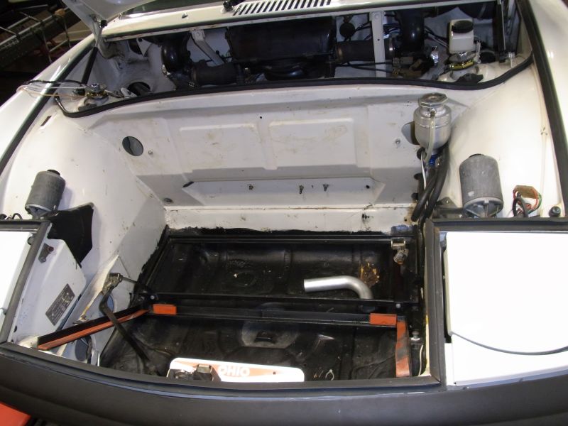

With that solved and Okteenerfest coming up I though that I would take care of a tiny pinhole leak in the radiator from a rock hit. While visiting Doug to check out Grey Matter he donated the 1.5" green stripe hose to the project so while I have the cooling system dry to fix the radiator I might as well reroute the cooling lines.
Step one, pull the raidiator and all of the cooling lines except the one in the passenger long. Then pull the Fuel tank to get access to the front of the steering rack hump.
Cooling lines will come out of the lower front of the longs and enter the steering rack hump channel here:
And come out here:
Then go under the fuel tank and enter the radiator from below instead of above. This requires removing and plugging and exiting connections and installing new ones. I will also end up remaking most of the elbows. Plenty of work to do.
While I was aligning the car with my new stings setup I noticed that I could get half of a degree more camber on one side than the other. It sort of bothered me and after looking at it for a while I decided that my upper bushings must be off somehow. I looked into replacement bushings and really liked the Elephant Sealed Monball units. While I was ordering those I decided that I might as well put the pollybronze bushings in the front suspension also. Jez, while apart it would be a great time to install new strut inserts so I ordered a set of Bilsteins. No big deal, plenty of time before Okteenerfest.

I have over 10,000 miles on the conversion and I am just starting to get frustrated by the esthetics. (IMG:style_emoticons/default/barf.gif) Driving is fun (IMG:style_emoticons/default/driving-girl.gif)
Wife was having girl time tonight so I had big plans on the project, ufortunately did not make as much progress as hoped.

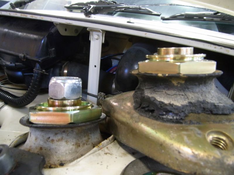

First problem was the Elepant Weather Sealed Monoballs for the strut tops. When Stefan and I first installed them I could not get the snap ring in. Figured once they were torqued down it would go...it does not. Both sides tightened to exactly the same place so I assumed that the mounts were not deranged. Called Elephant and they said that it was not known problem. On a whim I dug out a 911 camber plate cleaned it up, pulled the monoball out of the 914 and voila, fits great. Tightens past the snap ring groove with finger torque.
Apparently 911 and 914 camber plates are different enough that the monoball does not fit 914's properly. Talked to Elephant and they are going to get back to me with a proposal. I would like to just install the 911 camber plates and be done with it but I only have one good one. Anyone have a spare or two they want to sell?
The other issue I had was removing the 1.75" tube from the driver side long. Bloody hell, not sure how I got it in there but for a bit I did not think that it would come out. After much tugging to exhaustion, inch by inch it finally came out.
Back to progress, cleaned up the trunk side access hole.
Cut the hole into the long and test fit an elbow, looks pretty good.
Would look even better with the tube through the tunnel but it just would not go in. It will, just need to give it another try with a fresh mind and muscles.
Getting close to beader time, I can't wait!!!!

Update on the Elephant Front strut monoballs. They agree that the parts do not fit the 914 camber plates properly and offered to refund the purchase or send me a pair of 911 plates. I really like the parts so I am having the 911 camber plates sent. I offered in return to send my 914 camber plates so they can adapt the parts to our cars. They agreed on the swap so maybe sometime in the future they will be compatible with our cars.
