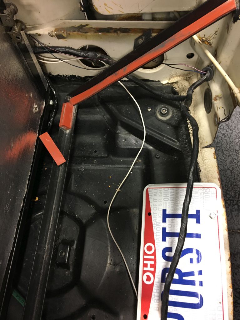

Not sure how to post pictures in PM so I will add it here... (IMG:style_emoticons/default/blink.gif)
This is the section that we need. Between the headlights including the fogs and horns. Back as far as possible to the fuse box.

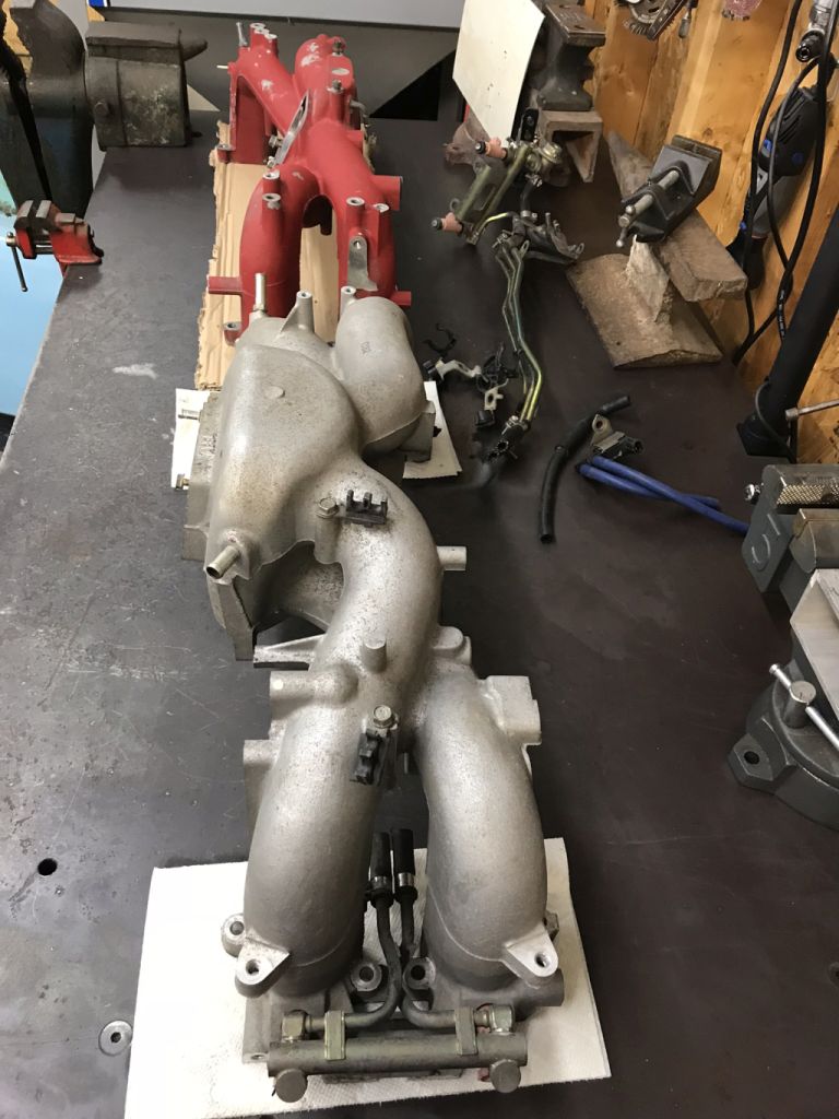

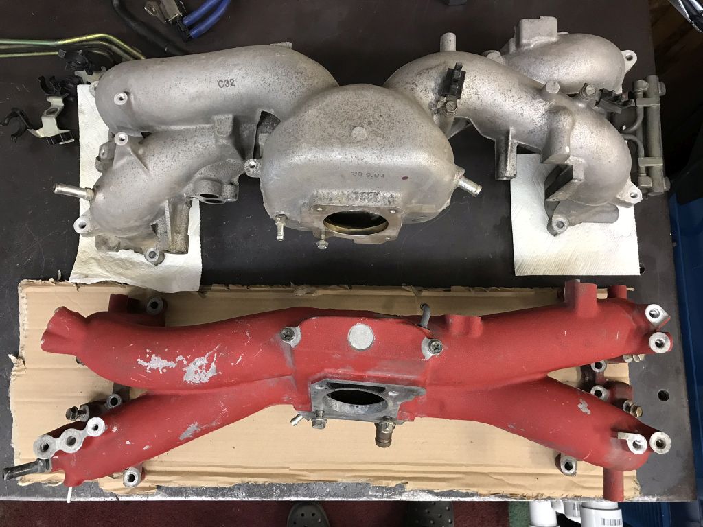

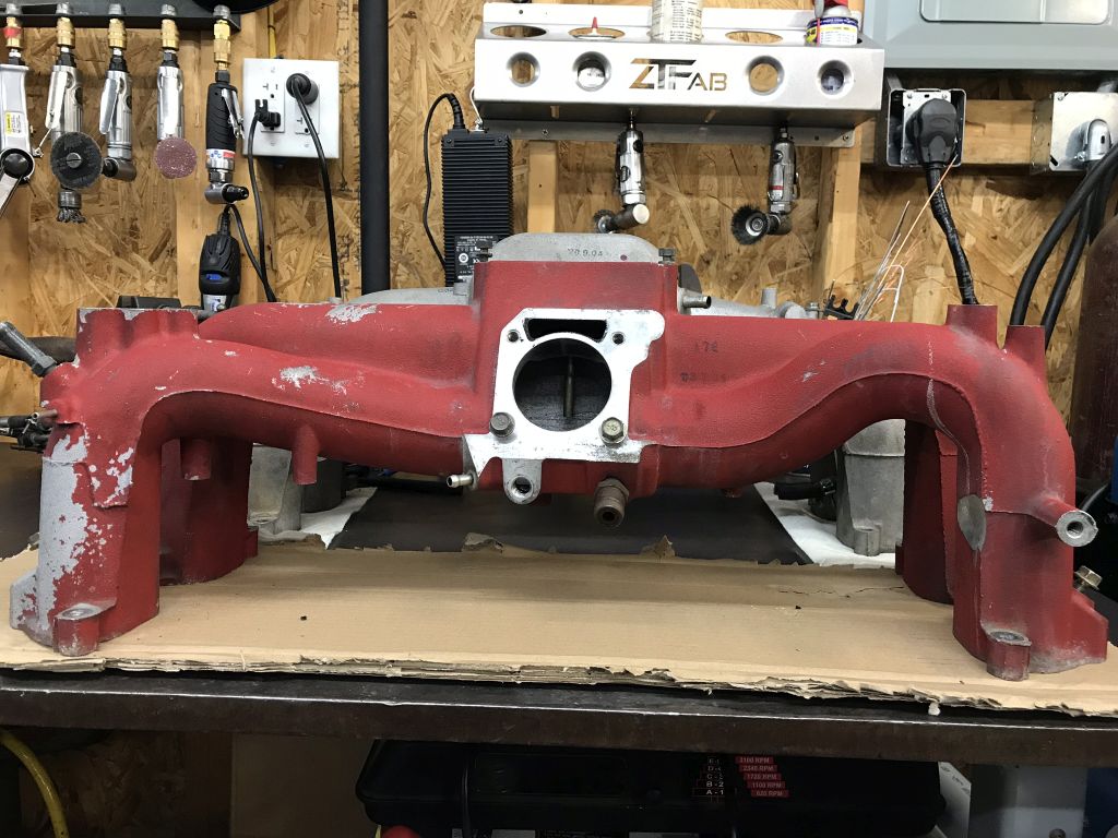

The 2.5i big plenum long runner manifold flows great and is cheap so I picked one up off eBay. I knew ahead of time that the TB mount is in a different location and probably would not fit my current setup. It won't so I found a JDM STI manifold which is long runner with the same TB position as my three piece manifold.

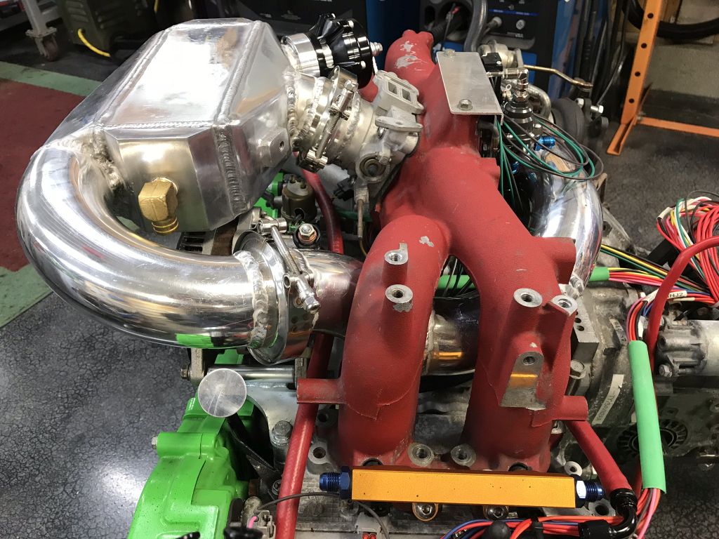

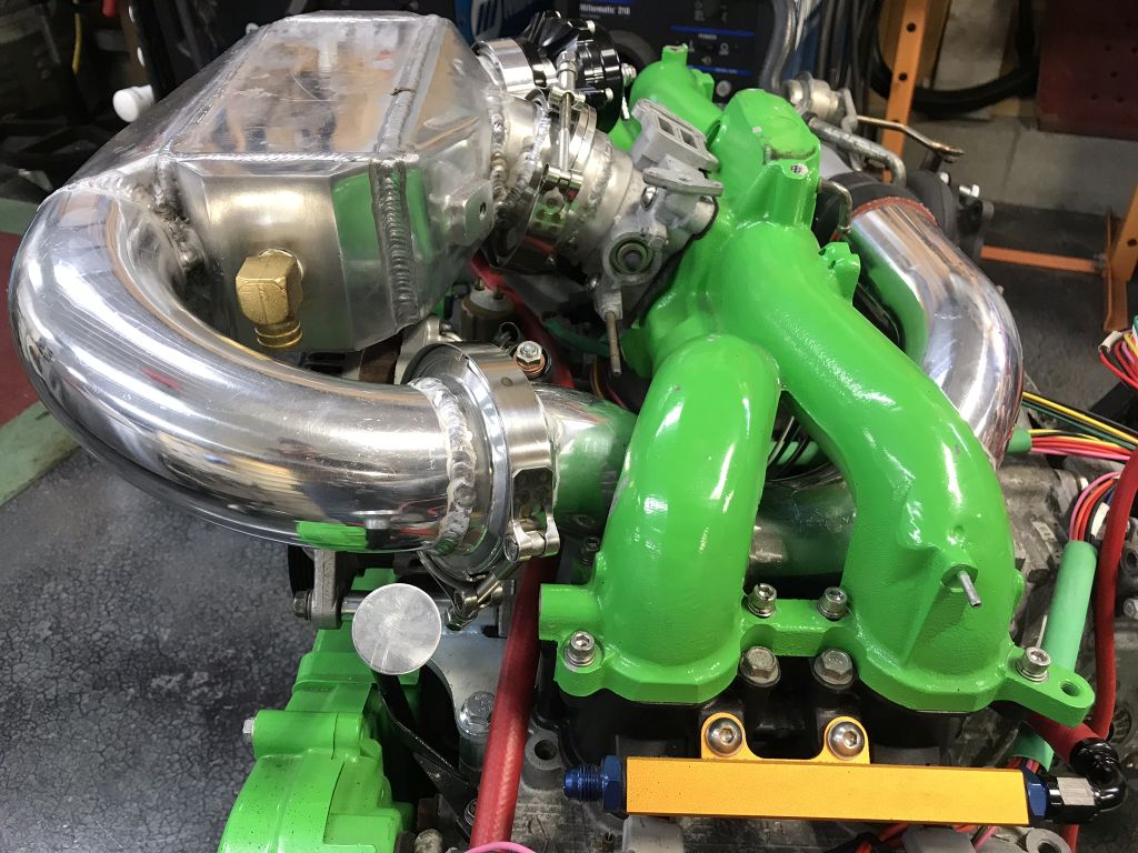

Plan is was to use the JDM STI intake until I upgrade my turbo and build a rotated intake setup with air/water IC like Grey and then use the 2.5i intake.
I wanted to see how it would look installed so I threw it on Grey's engine...
So much cleaner than the three piece manifold.
Now I am thinking that it would be a waste to hide it under the IC on PorSTI.
Cheers,
Scott

that looks great using the stock turbo location. Just my rambling but if I was planning on a bigger turbo and using the awic and needing to build all new plumbing, you might consider putting the big turbo down in front with the awic above it and then the big plenum intake on. the big intake has a lot of good value, it increases low end torque and of course acts like a capacitor to level out the pressure as the motor uses it, I do like the cob as my son always had only two places to get e85. The only bad thing is all the expense of the bigger fuel lines and injectors and pump to flow the greater volume e85 requires.It took about 26/28 psi with a big turbo, on e85 to get to 500 awhp with his sti on a safe tune. that was on a 98 degree day after driving 90 miles to the dyno. that was with a front mount air ic that we tested with a temp gauge at the throttle body. I am anxious to see your compilation of parts as I have most of them except a big turbo and awic and the plumbing. I will never be able to tig that good I'm afraid.

Wow how stuff changed since Friday night. I like the Grey market part on Grey it is only fitting.
For PORSTI I agree with Charlie, as you love to weld, and make intricate cuts on your huge bandsaw.
Keep the long runner, put it on PORSTI, TB, then A2WIC in front of that, and then Turbo just off to one side, nice and short plumbing. The header could give you a bit of an issue with your motor mount moving it forward.
In reality do you really need more than what E85 will give you. (IMG:style_emoticons/default/confused24.gif) It does make some very nice power, and your car all ready has issues with keeping the power to the ground. I don't think the larger meats out back are going to help you much. (IMG:style_emoticons/default/happy11.gif)

I agree, also the tranny will work great until the rear traction gets too good. about 400ft lbs is the max on the 5 spd tranny with awd and the heavier wrx body. also a larger turbo takes up a lot of room but will make less heat at higher pressure and more volume.

...no, I probably don't need a bigger turbo, but that really is not the point.
Realistically, a bigger turbo is a ways off because with it comes new pistons, rods, clutch and probably gearbox upgrades.
More likely is that I build the AWIC setup with the current turbo.

Just info I just remembered. I have a flow bench and when we did my sons sti heads we added 1/2 mm larger valves because you can use the factory seats. he has cams that go to .410/.420 lift I think I remember and at full lift the intake ports flow about 300 cfm each after porting. that's why subys can make that much hp. a 350hp chevy can use 600/700 cfm total. Also he used the tgv's with stock ecm and tuning.

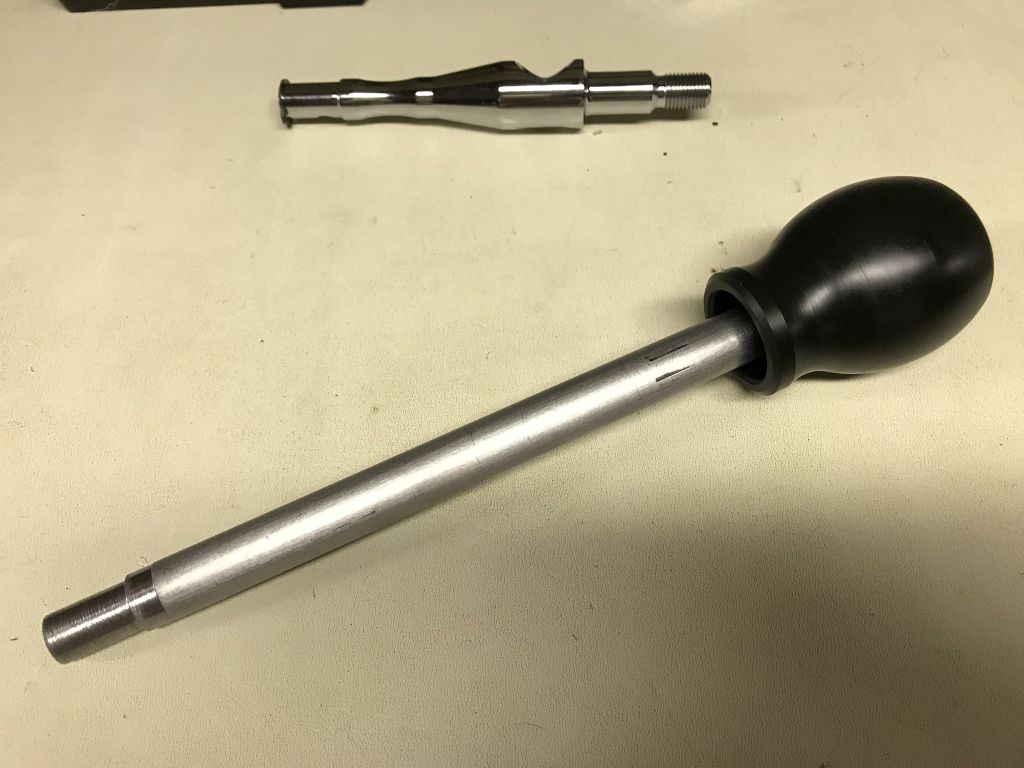

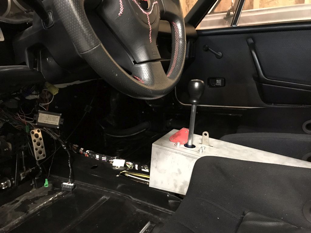

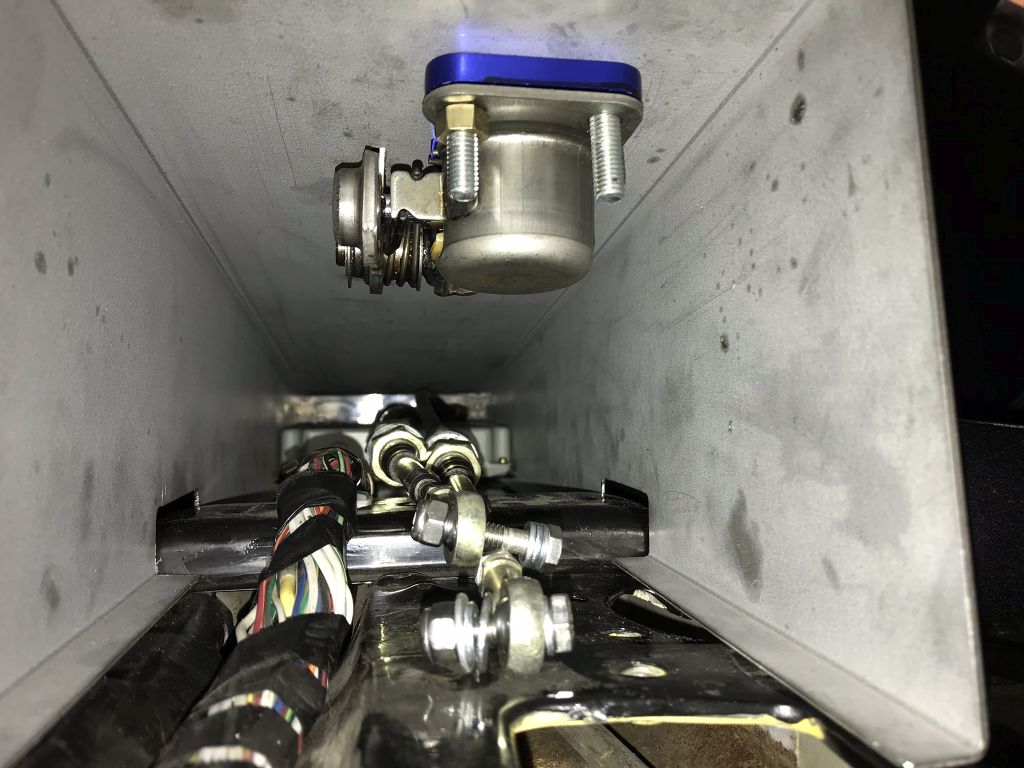

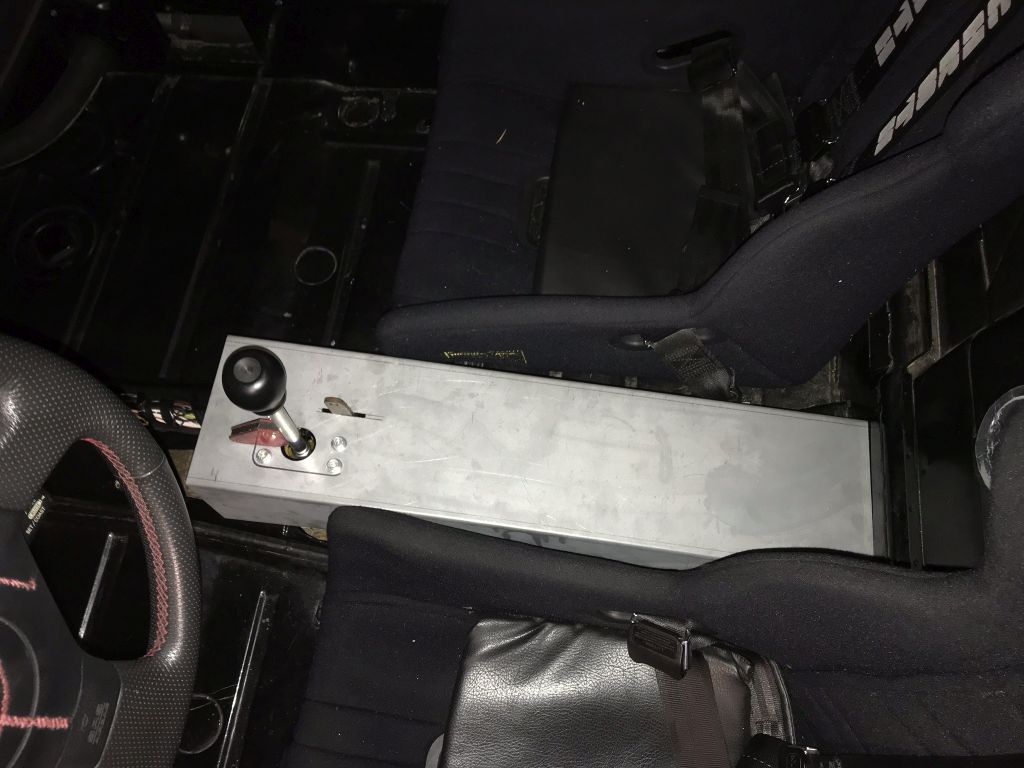

I did get an extra set of hands in the garage but I won't let anyone else work on customer projects so I gave him my new center counsel to play with. I have had the bent blank in the garage for over a year, time to get it in.
Looks pretty good and the shifter is exactly where I want it.
Took all of the guts from the MR2 shifter rotated them 180 to even out the cable attachment points and mounted them in the center console.
Made a new shaft.
Getting the cables up through the console will be quite involved so I will do that myself eventually.
Other than that just, accumulating parts so that I can hit it hard when it is on the working side of the shop again.

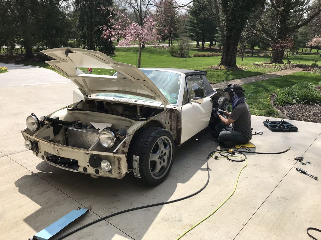

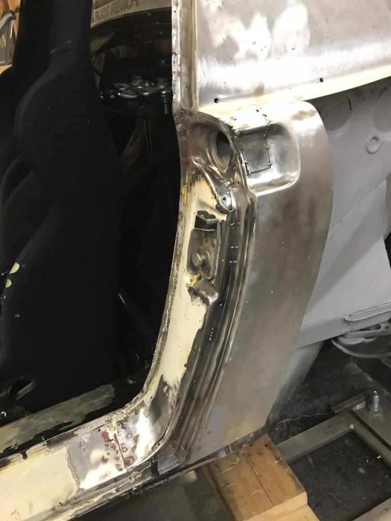

My yearly week of shenanigans with my car buddies is quickly approaching. I was working to get Grey on the road prior to getting back to my own project but endless details made that impossible. I proposed to Tom to take a few weeks to focus on Porsti and he graciously agreed for Grey to sit on the sidelines. (IMG:style_emoticons/default/pray.gif)
On with progress.

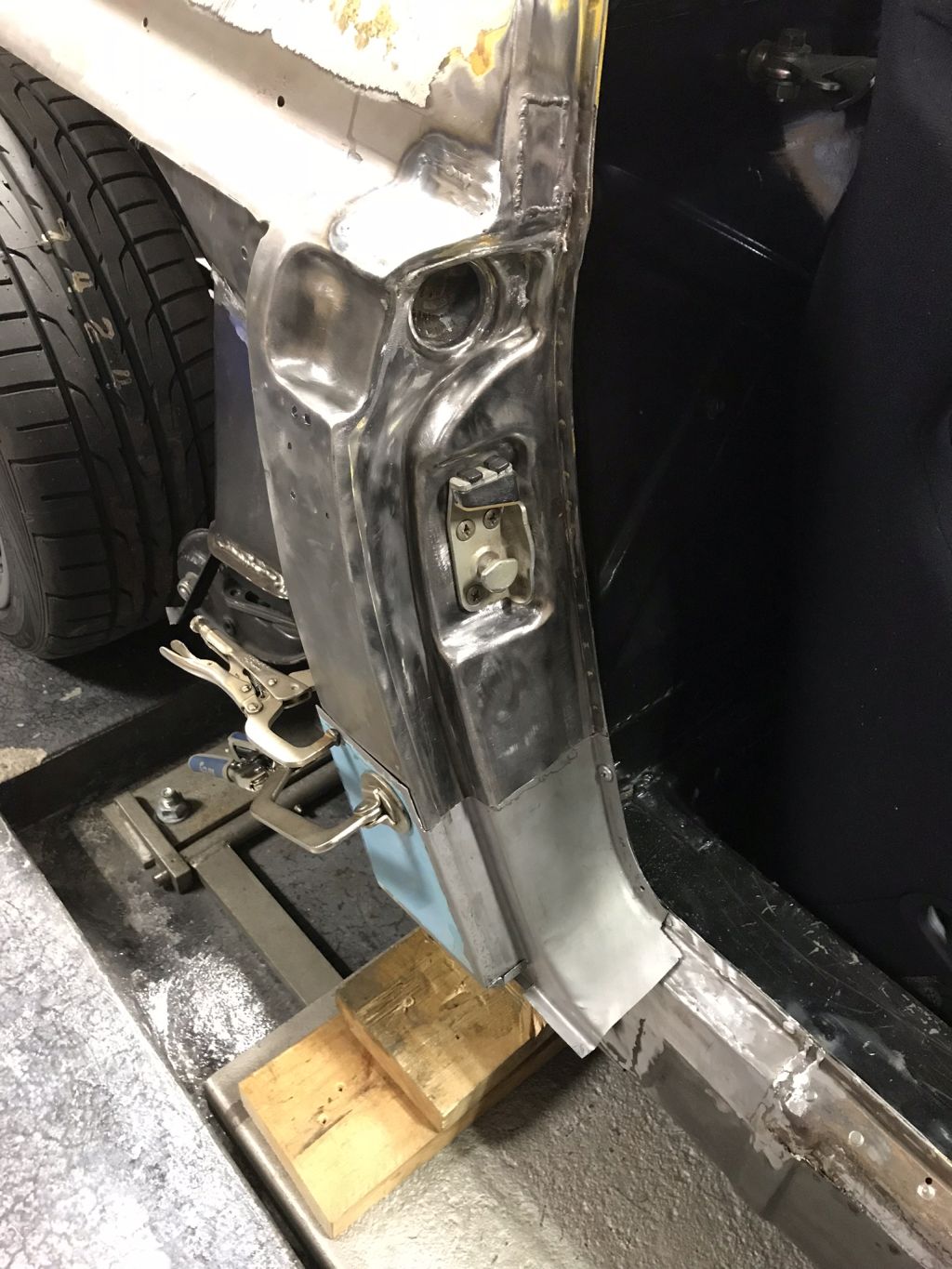

My Father is again planning to join the trip this year as he was last year until rust and the sins of the PO resulted in the complete removal of the fenders. He is quite experienced with car projects and agreed to come down with my Mom to give me a head start on this year's push to drivability. Over 4 days we probably put in 50 hours of solid work, Mom even helped! The goal was to get the rear fenders bonded on but ended up just a bit short but took the opportunity while we had access to fix a few other issues.
Lots of smoothing of welds from previous repairs and the never ending removal of undercoating and paint.

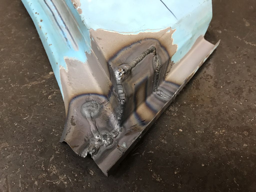

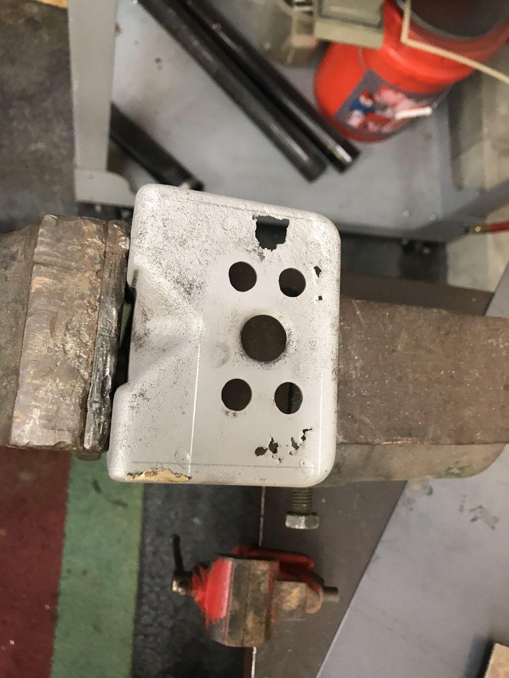

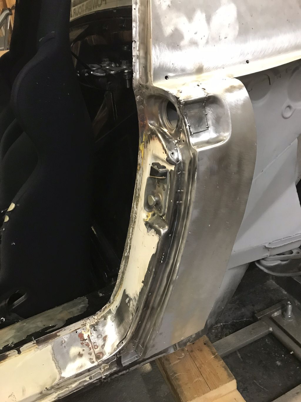

One of the unexpected repairs was a rusted out drivers side latch bracket.
Would have been easy to order one from Restoration Design but no time for that so cut/weld.
Still fits. You can also see several unneeded holes that we welded shut.

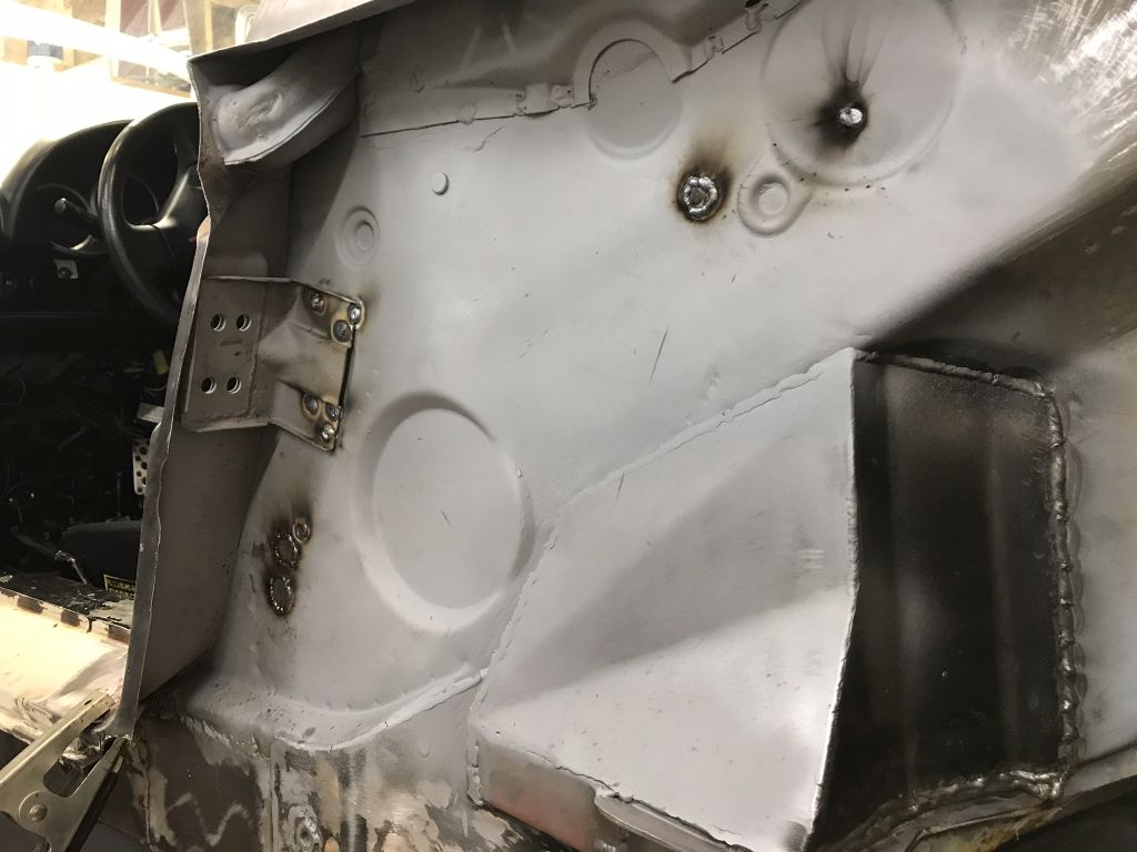

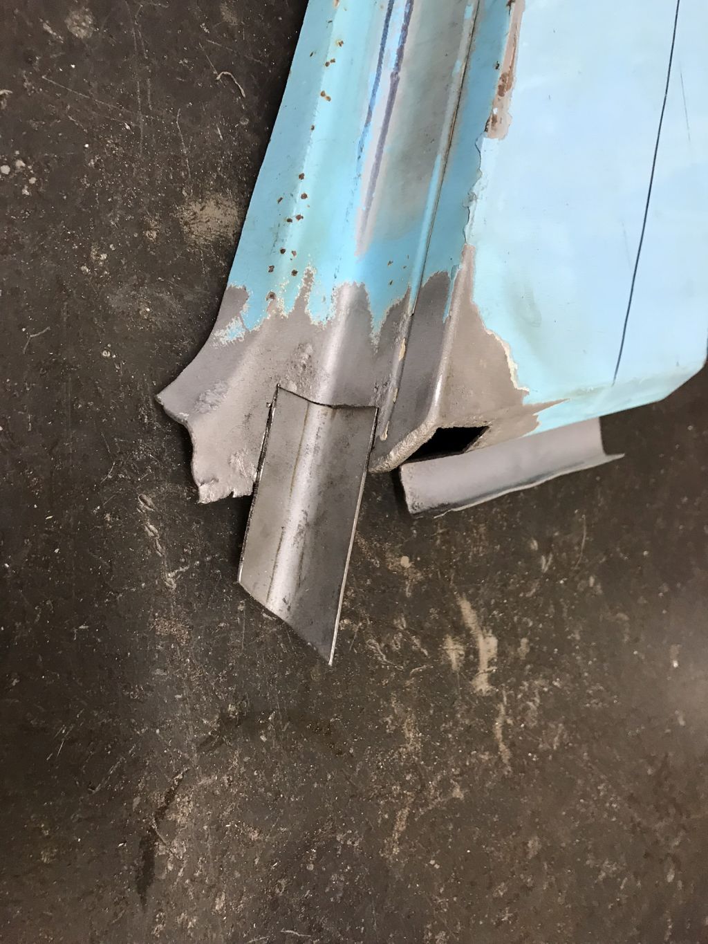

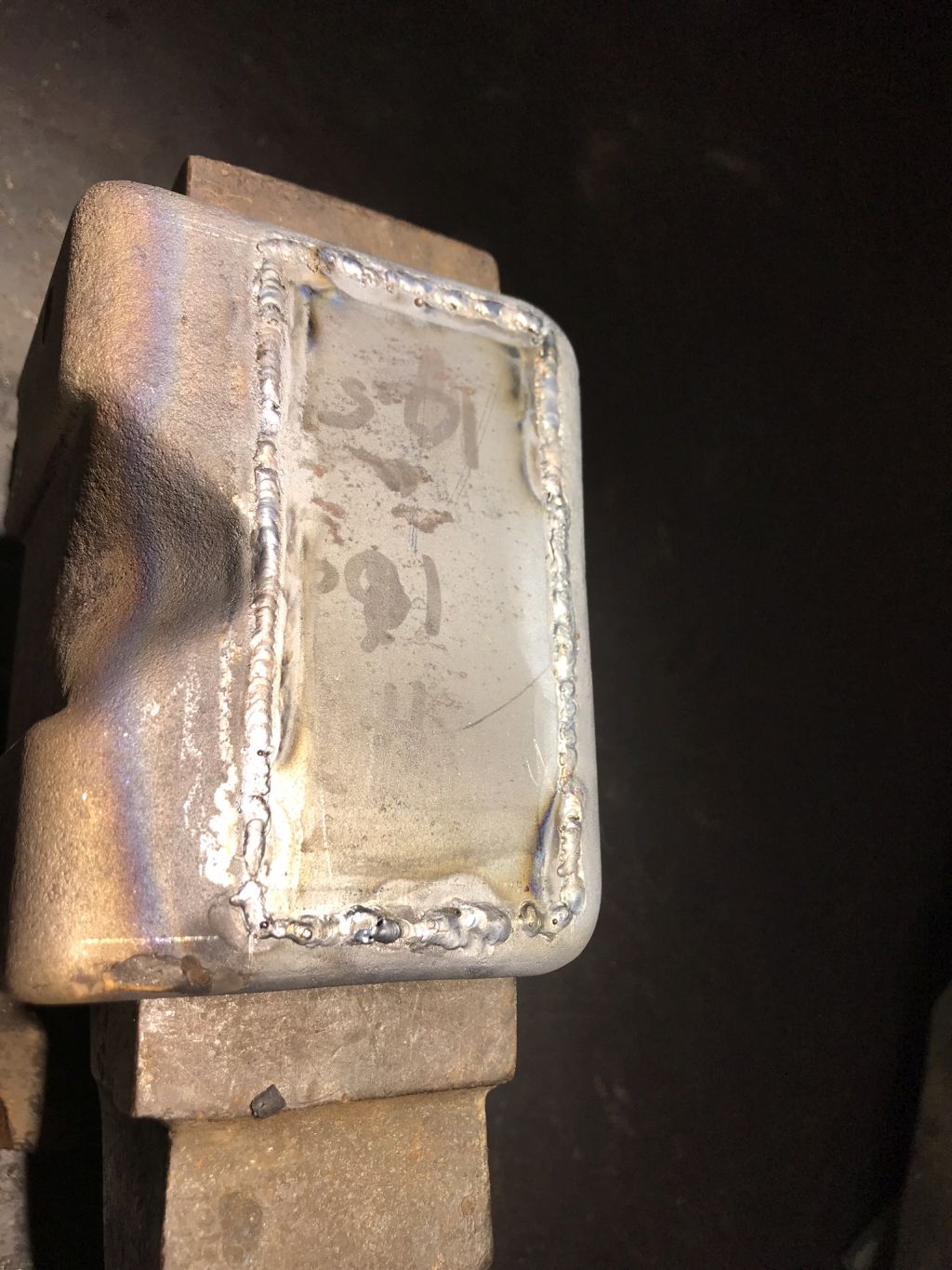

The patch panels that I picked up for the project were really nice but had a couple of soft spots that needed to be repaired. Just a few angles here to sort out.
Turned out pretty well.
Panel fitted and a patch at the top of the door latch relief formed from flat. That took almost 2 hours! My Father asked if I was gong to make a career out of that piece.
Two areas on the driver side need small patches along with complete replacement of the bottom. Part was make from a Restoration design panel and the rest formed from the bottom of another fender. Also cut out and repaired what was left of a rusted out jack pad. No pictures but it is slightly visible.
Such an insane amount of work just to get solid medal to bond the fiberglass fenders to. I have another 4 day weekend scheduled for this weekend. Should be able to finish up the rear and get the fenders boned on. Front is next. Full steam ahead.
