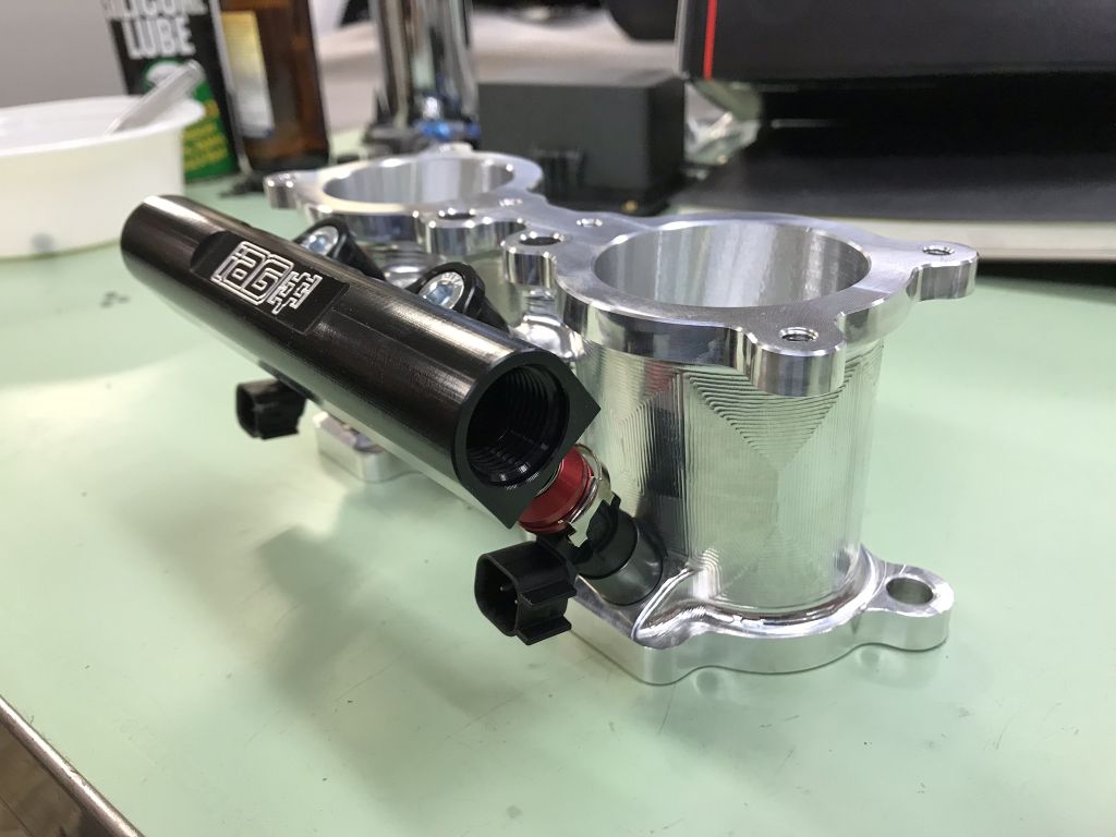

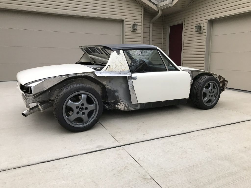

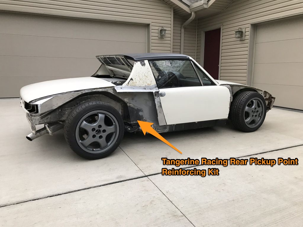

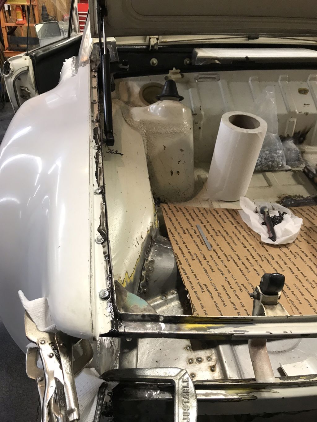

I started ordering parts and the first thing in were the AIG TGV deletes. These are top feed to get better injector options than the STI side feed configuration. I was going to modify a pair of stock WRX units I picked up for cheep but the amount of effort to make them decent just does not make sense when you can get a set of these for $260 delivered including gaskets and fasteners. I couldn't help but dig out the new fuel rails and ID1050x injectors. Bling!

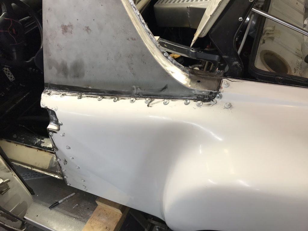

On to some real work...fitting the fenders. I had forgotten how crappy it was working with fiberglass and went glove and sleeveless. So itchy and prickly.
Fitting together fairly well for fiberglass but much tweaking to do.

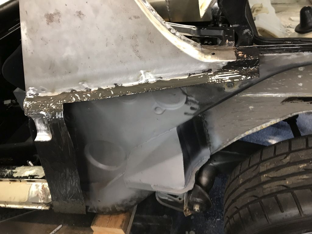

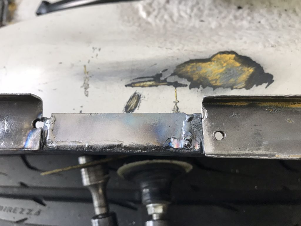

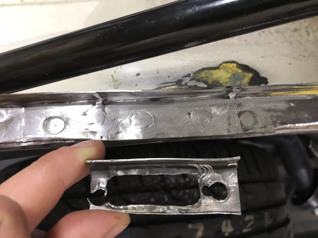

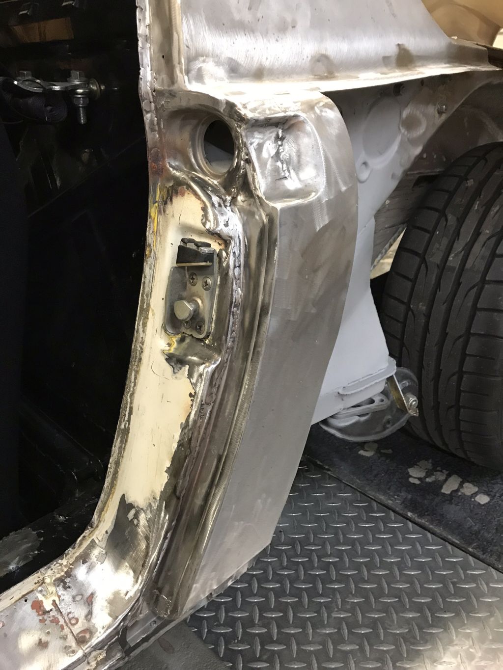

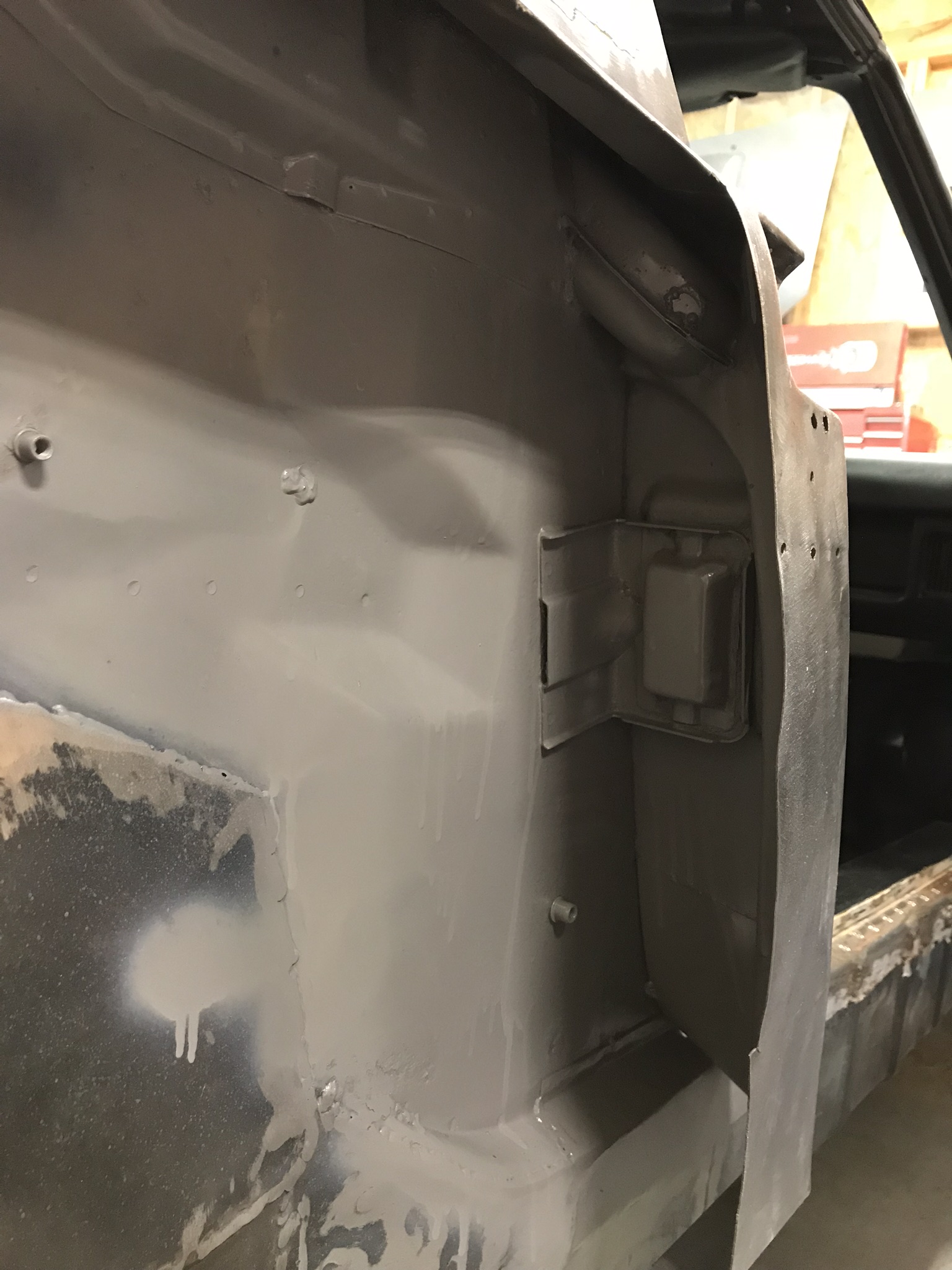

On with fender fitting. I had the trunk shocks mouned with fasteners and needed to weld them in place so that the fiberglass fenders could sit down. I started cleaning the area for welding and found more grey bondo...(IMG:style_emoticons/default/WTF.gif)
I thought that I had found all of the BS. Didn't get a picture of the area pre-repair but there was a strip of metal riveted under the rusted out area to support the grey bondo. Base area repaired.
(IMG:style_emoticons/default/bootyshake.gif) (IMG:style_emoticons/default/bs.gif) (IMG:style_emoticons/default/bootyshake.gif) (IMG:style_emoticons/default/bs.gif)
The passenger side fender fits much better now. On to the driver side. My substantial repairs were just off enough to make the new fender fit just a bit off so I had some tweeking to do. Much grinding and fitting later...
Almost ready for bonding. I left all of the new weld seams only tacked in case I had to adjust something. Tomorrow they all get welded. Nothing beats a couple of hours of torch time.

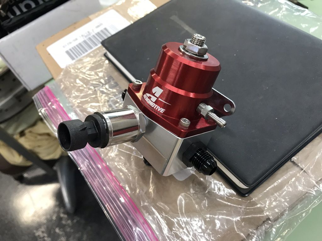

More parts arrived today. Fuel pressure regulator with all AN fittings and fuel pressure sensor.

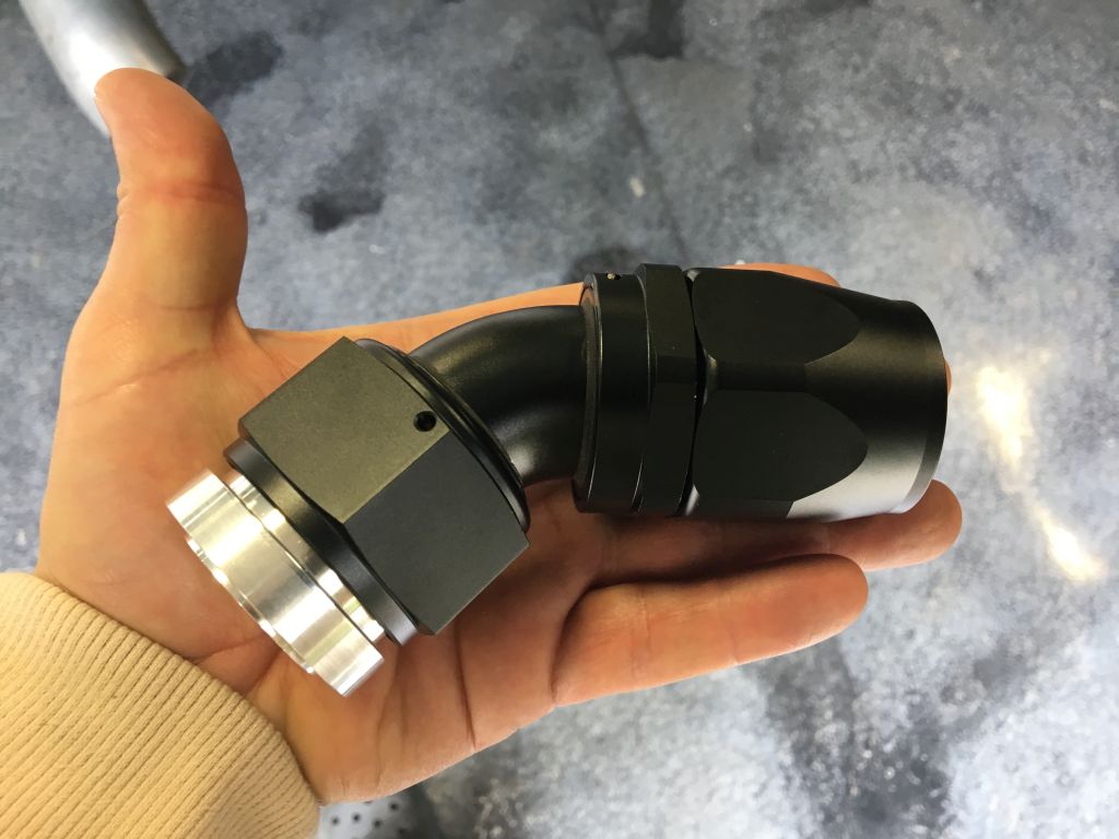

I am taking my no hose clamp mantra to a whole new level. AN20 for the new radiator plumbing.

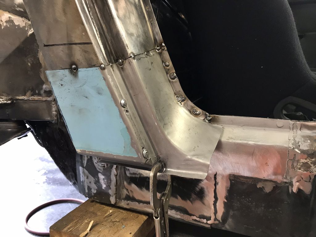

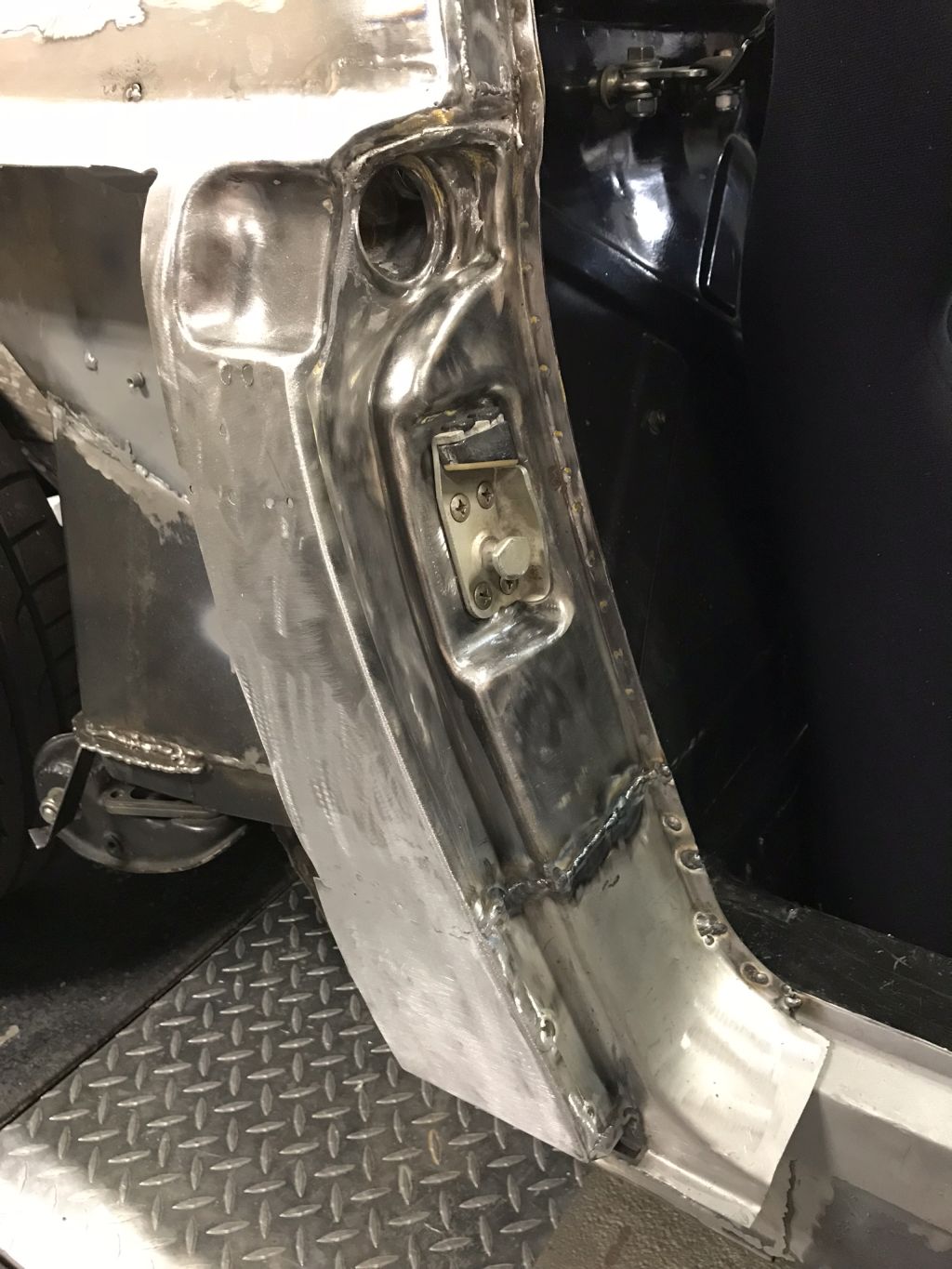

Passenger side repairs in place.
So much work just to get solid metal to bond the fiberglass fenders to.
So much work to get all of the moisture trapping white stuff from hell out. Well worth the effort.
Driver side welded. Got sick of grinding so the welds are not quite flush...yet.

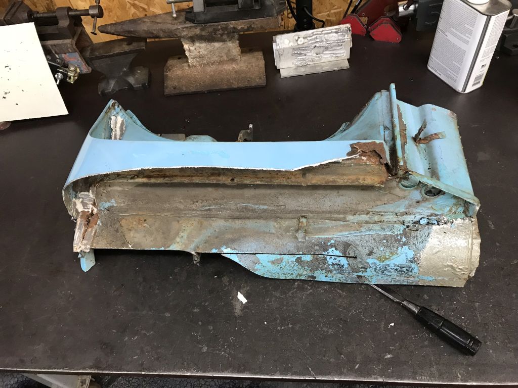

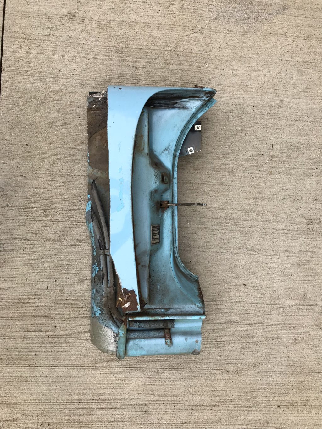

Fed ex guy was probably wondering why I was so excited to get a rusty chunk of car in the mail. Thanks Mark, this is much better than the pictures.
Anyone have the passenger side of this? I would love to acquire it.
Thought that it looked cool as the sun went down.
After cleaning up the days mess I could not resist putting the chunk on the operating table to get started removing the rust causing white stuff from hell.

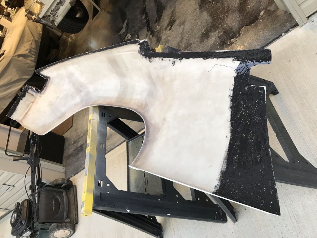

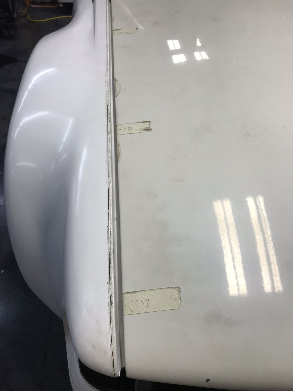

Sunday was supposed to be bonding day. I spent countless hours checking, tweaking, fussing, and delaying...because I was terrified that it was going to go terribly wrong.
Finally got to a point where bonding had to happen. Got out the adhesive and the dispenser and...that won't work. Turns out the dispenser works for 3M which is probably why Stephen recommended that I use 3m adhesive. (IMG:style_emoticons/default/headbang.gif) SEM dispenser will be here Wednesday.
Was actually a huge relief. Not only did it give me a chance to fuss a bit more, the earlier start mowing the lawn was just enough to finish as the rain was starting!
After mowing the lawn I started working on the front fenders. Mostly just scraping the white stuff from hell and figuring out where to start cutting.

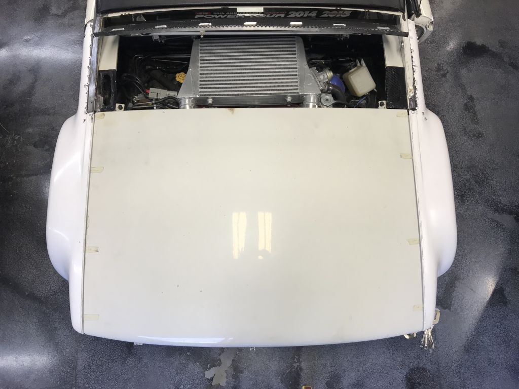

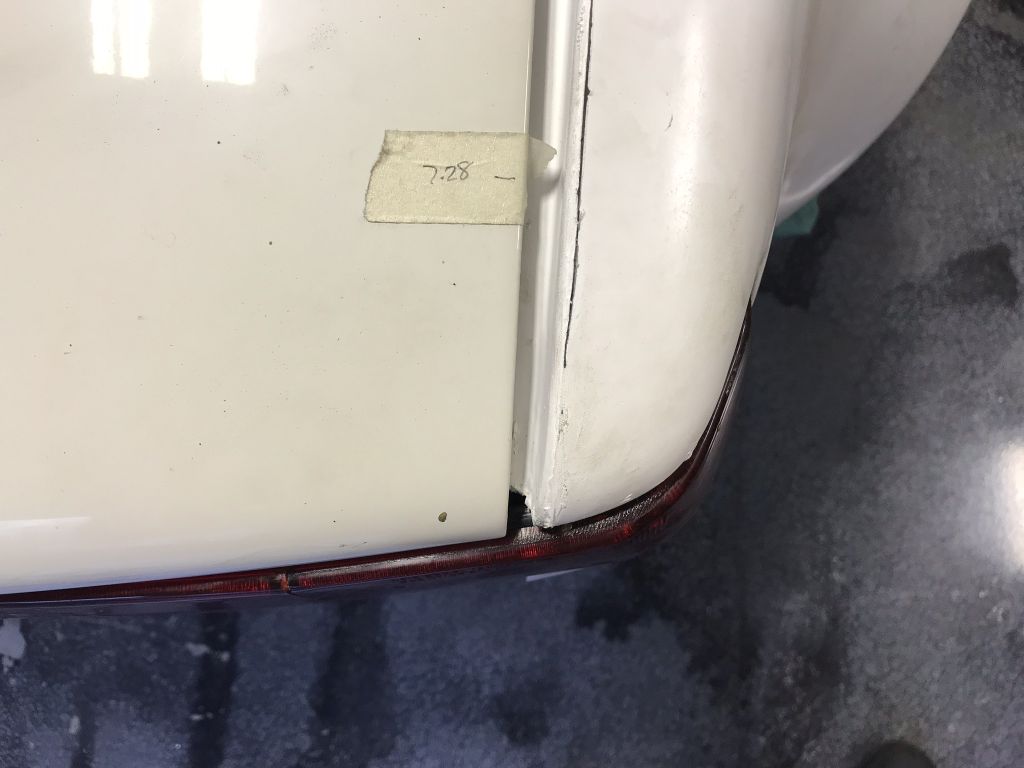

The dispenser arrived today. What a well built tool, just feels solid and smooth.
Which is good because I put down a ton of SEM 39747. Applied to both the body and the fender. Both were wiped down with mineral spirits beforehand.
I may have went a little nuts with the fasteners but I wanted to regret having too many holes to fill than having areas that were bulging or not bonded.
I had time to do the other side but wanted to see how this one ended up so that I could make any needed adjustments.
