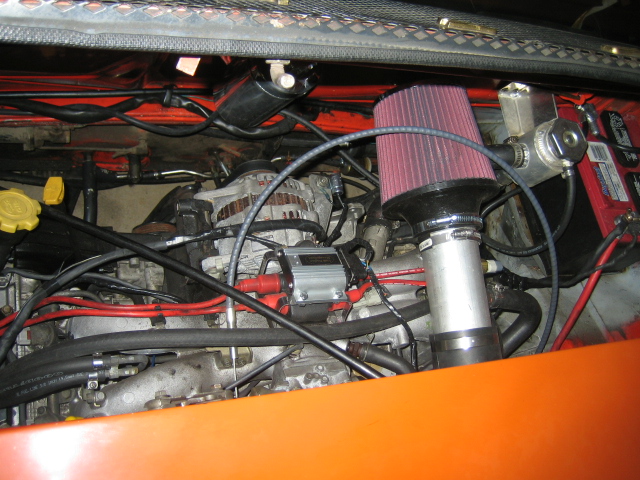

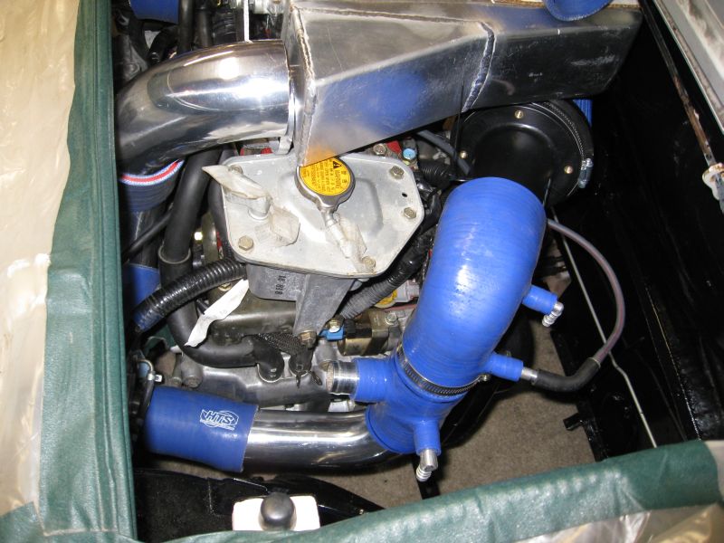

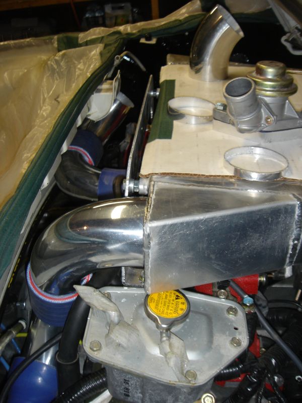

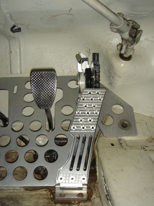

It's been a while since a progress update, unfortunately not so much to report.
Worked a bit on the IC plumbing. Am waiting on some more tubing to arrive so that I can finish it off.

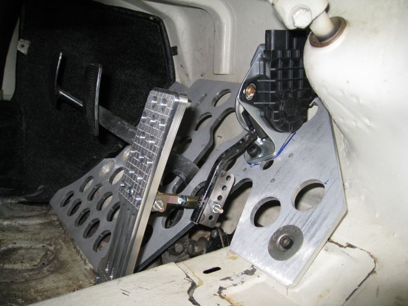

Mounted the throttle sensor this afternoon.
Still need to connect the pedal to the sensor. I will be using some tiny heim joints. Should work out quite well.
With the additional IC tubing on it's way is all of the bends I need to run the radiator lines and the rest of the fuel lines. Lot's-O-plumbing to do yet...

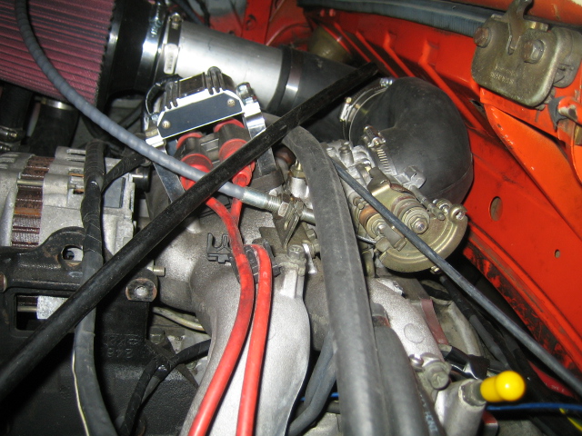

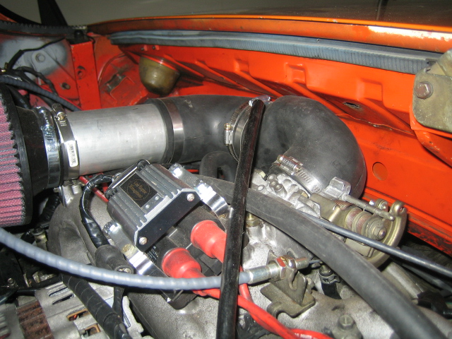

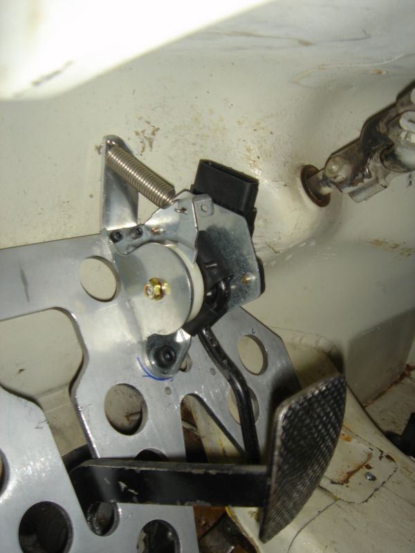

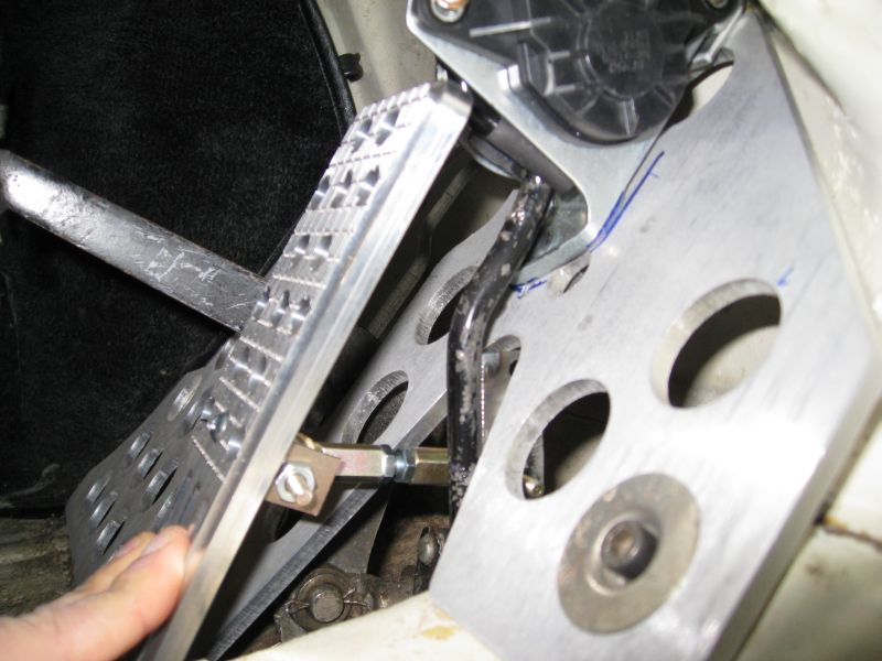

Work has been continuing at a slow although constant pace. The most interesting development was made yesterday when I connected the pedal to the sensor. Still need to clean up the brackets and make a pedal stop but...at least I know that I got the pedal ratio and feel right.
Worked on the filter/intake. I had to shorten the ebay silicone part quite a bit. Will make a better mount than a zip tie when the engine comes out next.

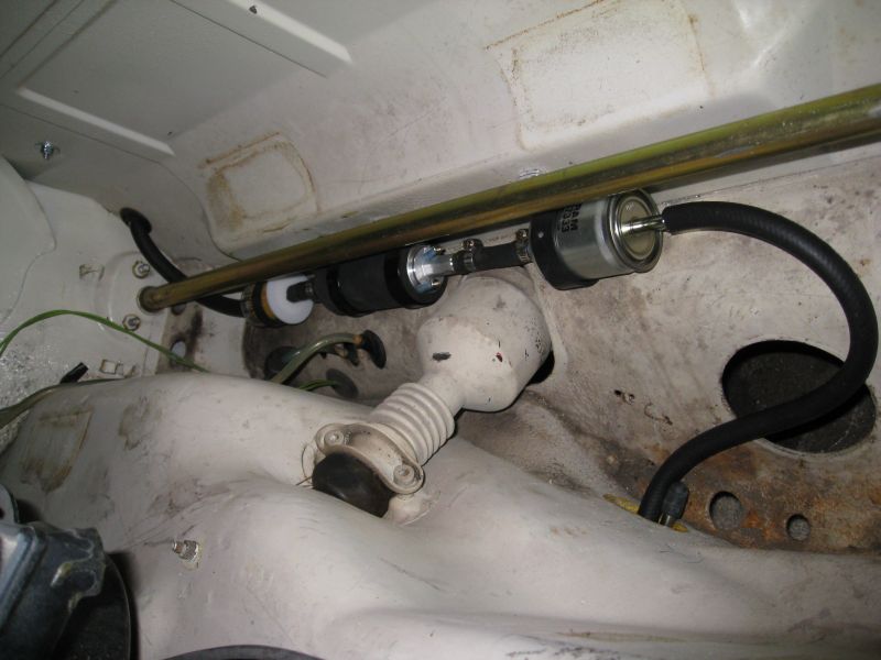

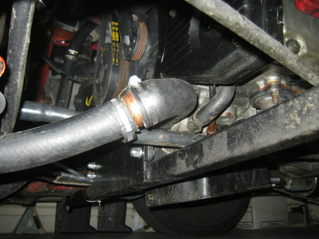

Also spent some time on the radiator plumbing.
and fuel filter/pump plumbing.

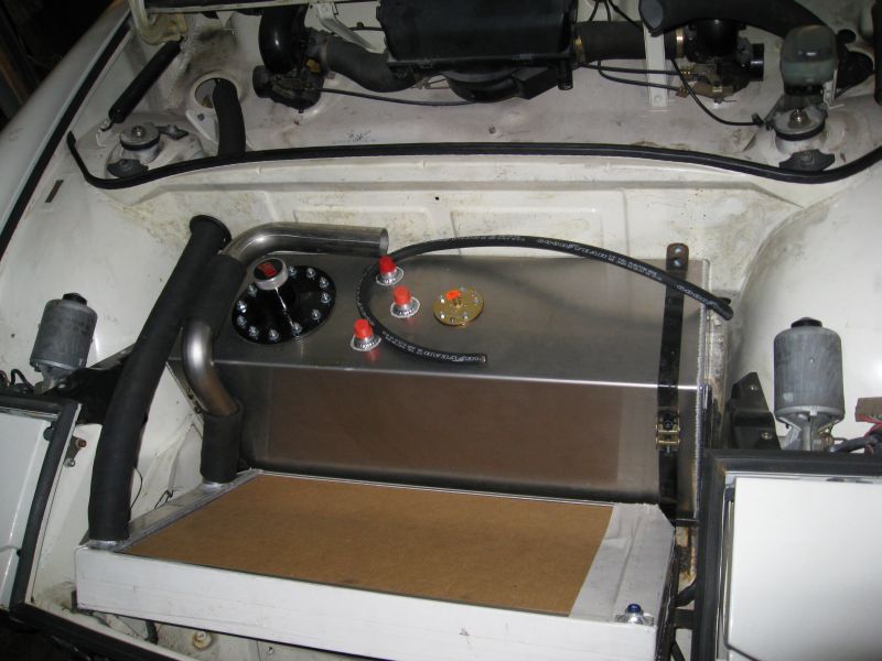

What fuel pump are you using? Also, I see you're sing a fuel cell so it may not matter, but on my WRX conversion (stock tank) I had to tee both the outlet and the return line together into 1/2" fuel line to allow enough fuel flow to the fuel pump (928 Bosche), and weld a return bung into the tank. Just wondering....these engines require ALOT of fuel flow and I was told without the overkill I would get fuel starvation.
Ed aka W9R1
Amenson
post Nov 5 2007, 11:30 AM
Post #89
That's opposite lock!!
Posts: 645
Joined: 27-May 05
From: Dublin, OH
Member No.: 4,154
QUOTE(fat73 @ Nov 5 2007, 09:04 AM) *
Scott....Very nice work.
Ed aka W9R1
Ed,
I am using a Walbro 255 l/hr. It should be good for just over 500hp. With 3/8" lines to and from the engine, I should have plenty of fuel.

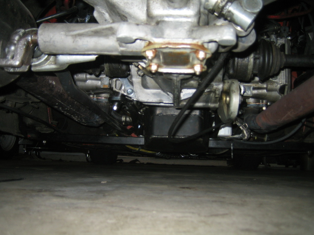

underneath engine / custom bar that bolts right up to small car performance mounts with no mods to them

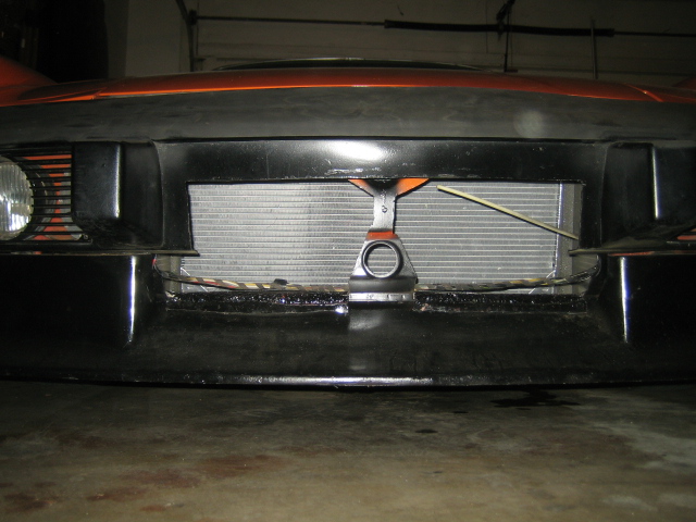

Front still not complete, hole works fine, just needs to be a little larger to look a little more put together... Oh Renegades radiator, nice setup, no brainer proven setup. Still fairly new....... Anyone have a little advice to get all the air out of the system. I have added water about 10 times so far and still finding air in system. guess it takes that long to work out the bubbles in the lines, etc.

Great looking conversion! Do you have the engine solid mounted? How is the engine vibration? Any cracking issues? How much does it weigh?

Engine is solid bolted to engine bar and when driving just as much vibration as stock. Remember i am still running stock motor mounts on the sides and stock trans mounts (not solid).....Screams.
