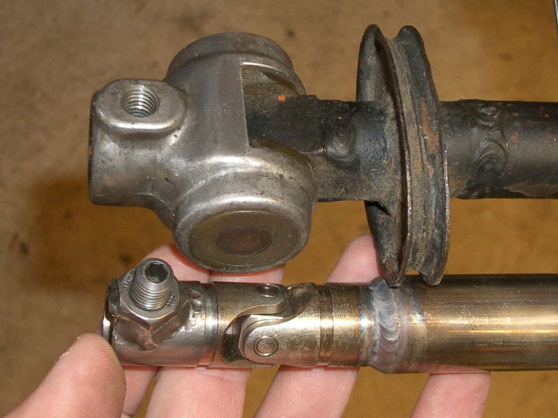

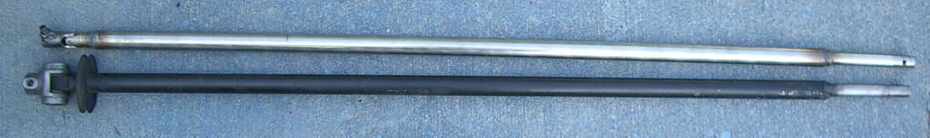

The POs side shift adapter and the new one:
The U-joint vs factory coupler w/ plastic bushings

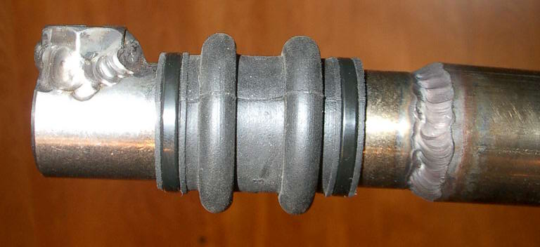

The boot over the U-joint (full of grease)

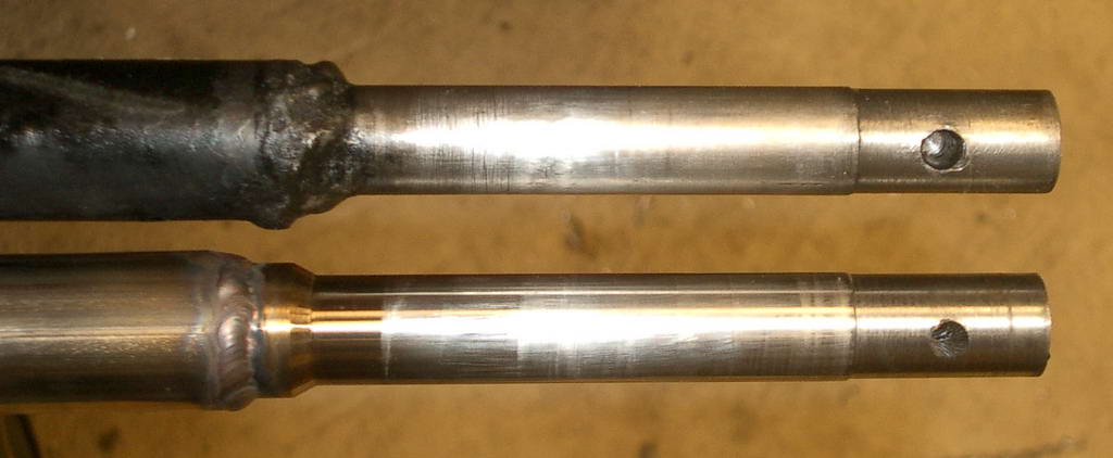

The tranny end - turned and polished (the tapered hole is even correct).
Its 100% stainless (303/304). Im out of stainless pickling paste so the welds haven't been cleaned yet. (Dont pick on my weld of the nut to the coupler - it was late and the little bugger flops around while you're welding;)
It can report that is works great and completely solves the bind that I use to get in the 1st/R plane (it never was as bad in 4/5 but I dont know why).
In retrospect, I'd use the next larger U-joint and tap the hole vs welding a nut. Both welding the nut, and pulling the boot over it sucked;) I'd also look into using smaller diam or thinner tubing (its currently 7/8" because thats what my old one was.) I didn't want the prototype to have too much torsional twist (calculated 0.75deg @ 10lbft)

I like it , but I would suggest one slight change.
I would incorporate the stock boot as it protects the firewall bushing from dirt/grit and helps it to last longer.
just my $0.02

QUOTE(JOHNMAN @ Sep 5 2006, 10:42 AM) *
John, I thought about that but the early cars boots are NLA and to my knowledge, there isnt any off the shelf solution to fit an aftermarket boot. My car came w/ a cobbled little bolt on thing that gives a place for a tail shift chassis to attach a side-shift boot, but it would need alot of RTV to seal behind it and at least another screw. Its a pretty crappy design and doesn't fit well. PRS914-6 did a better job by making something to fit his monoball setup:
http://www.914world.com/bbs2/index.php?showtopic=59088
I would need donor shift rods to take the oval flanges from - not cheap or easy (or stainless;) I *COULD* however find an aftermarket round-round convoluted boot that either tapers down to the size of the shaft (like "East Coaster" did in the same thread) or weld a round stainless washer to the rod. I'd need to know what size the firewall side is though.
Thanks!

A straight rod doesn't give optimum shifting, and usually puts stress on the shifter and the couplings. Compare the geometry of a stock side shifter rod to what you've made and you'll see what I mean.
I've been making conversion shift rods for almost 10 years now, using a specific jig I made, and there have been no shifting problems. Why did I start doing this? Because I paid $100 for a straight shift rod that didn't work!

Perry,
I completely agree w/ you if using the factory coupler. I think it was the root cause of my binding w/ the orig rod (and I suspect Michaels too), Thats why I started the first thread on the orientation of the factory coupler,and why I built one w/ a U-joint. Using a U-joint corrects ALL geometry problems except for the angle the rod passes though the single bushing at the tranny. That one (unfortunately) has MORE than enough slop to take up the few degrees of misalignment (I calculated around 4deg). When I welded the machined end to the tube I tilted it sideways a little. I can rotate the whole thing under the car a full 360deg and can watch the tranny bushing take it all up so I don't know if its even worth doing that last little tiny kink. The "teeth" that hold the last bushing in look like they'll take up +-10deg of misalignment no problem. The binding w/ a straight bar is only a problem if the factory single-axis-of-freedom coupler is used.
FWIW, that little bushing @ the tranny is the last source of real angular error I have. Even new, it moves about 0.040" in its hole. W/ the ~4" lever to the tranny, thats 0.6 deg slop. The shift tubes will twist more than that much (I calculated 0.7 deg @ 10lbft for the rear tube - which was my best estimate to the force needed to shift the tranny. The factory front bar is smallest and thus a larger contributor). After doing the calcs, it didn't seem like a large enough source of error to bother with machining a more perfect bushing.
SMD
