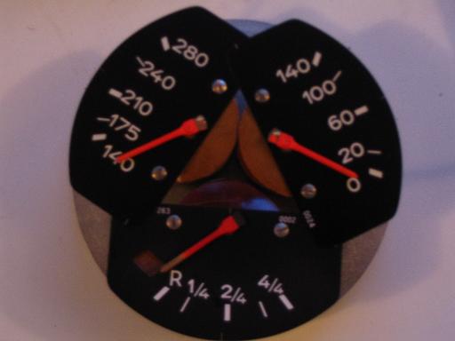

Can anyone confirm the correct VDO senders for the temp and press gauges configuration shown here? There were no part numbers on the gauges themselves...so I'm left to go by the temp.
my guess is?
Press sender = 911 606 230 ???
Temp sender = 901 641 632 ???

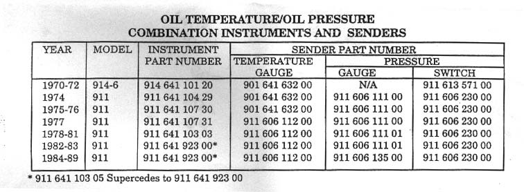

I think that you are right with the temp sender, but I think you would want the 911 606 111 00 pressure sender. The sender you call out is for the idiot light.

When i built mine i made sure the gauges and senders came out of a single 911 at Partsheaven. Might be a good question for pelican board or if you know what year 911 they came out of just have the dealer look them up maybe
