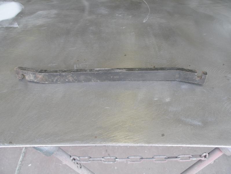

I saw this tool for the first time today. Tool is possesed by a former body shop owner who got the tool from Porsche 30 years ago as he recalled. Do you know what it is used for?

installing engine lid hinge?

replace the plastic roller on the rear trunk lid torsion bar

REAR TRUNK SPRING TOOL.

My dad fabbed one up when we had to do that on my car. My explanation didn't quite capture the roller torsion but that's what I meant about the "hinge". No worries on the sticker - just fun playing along...

I could have used that tool when I removed and replaced the trunk lid and hinges on my red car. Moving the torsion springs with box wrenches was quite scary. Those suckers pack some serious pressure.

I tried using this tool recently and it really works much better if you have two of them used together becasue of the configuration of the spring. I had two of these tools and used together, the process was as safe as it gets and the length of the lever puts using any other sort of kluged gizmo to shame...

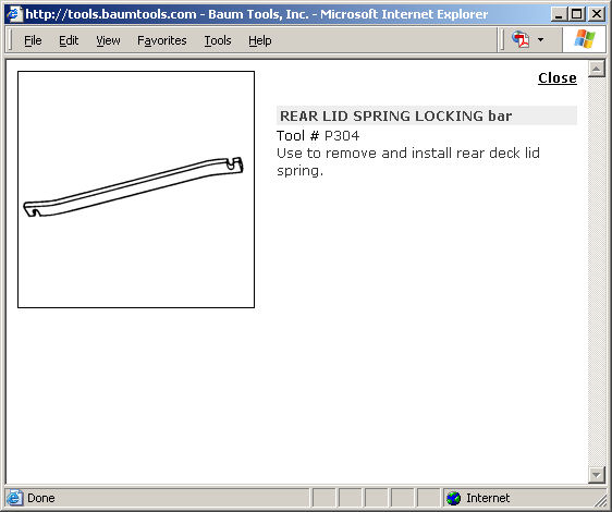

Here is a link with a full discription!
Trunk Link
