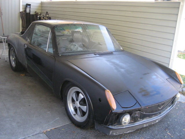

started out by stripping all four corners about a month ago, then bought my fuches, but since then I have kinda stalled out mostly due to work obligations, had to go to NE Washington for the forest fires for the last three weeks or so.
before I left I bought 16x6 and 7's and found that some stretching would be necessary in the rear. I have always liked soft flares anyway... but as follows is 1) as delivered
2-4) stripped and pounding started on the rear fenders

JPB   Lots of stroking on that sheet metal bro. Good wo...   Sep 9 2006, 07:21 PM
geniusanthony   #4 close up again...and problem area which i need ...   Sep 9 2006, 07:23 PM
geniusanthony   dont worry i know i am not close to being done (bu...   Sep 9 2006, 07:28 PM
Lou W   Looking good, looks like you'll end up with so...   Sep 9 2006, 07:34 PM
geniusanthony   my goal is more rounded to flow into the shoulders...   Sep 9 2006, 07:54 PM
Lou W   No, its not mine...however there are people here t...   Sep 9 2006, 07:57 PM
