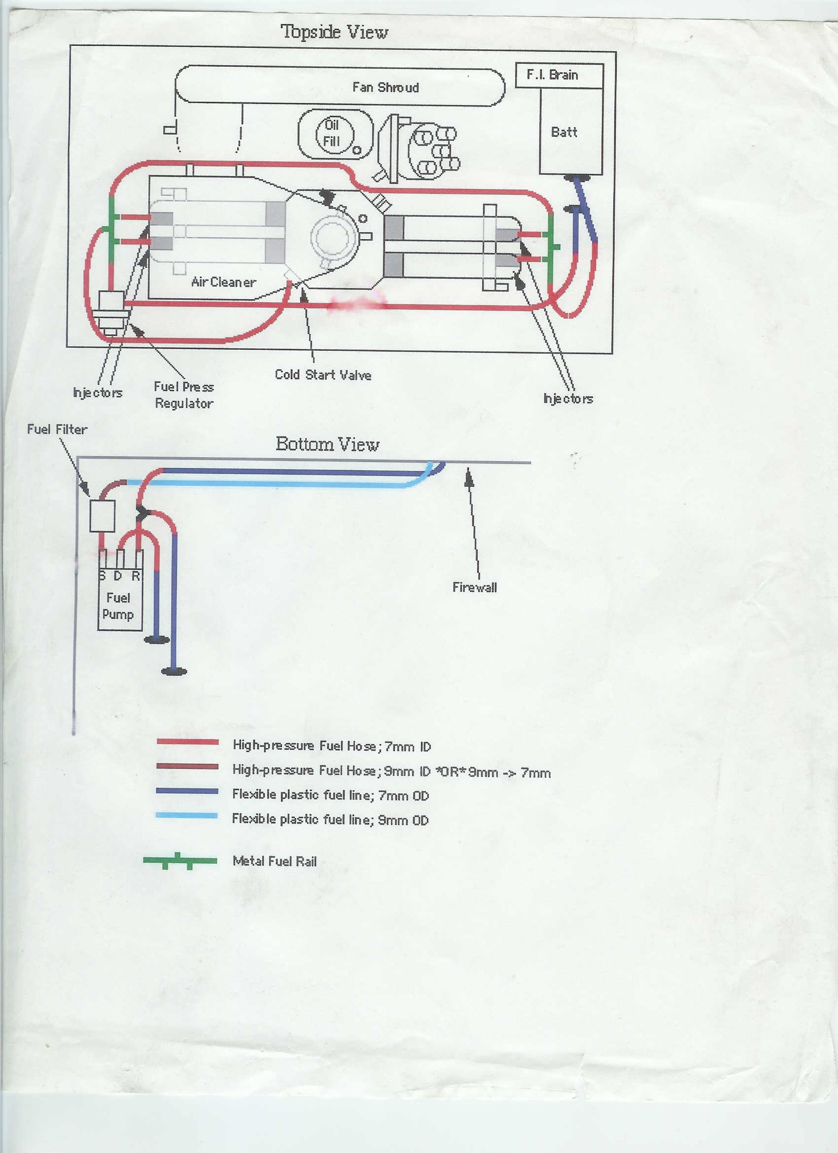

I recently replaced all of the vacuum/ fuel/ miscl hoses in my '76 2.0 with new Genuine German hoses including the stuff at the fuel tank. Intake runner to Intake manifold "hoses" were also replaced so ALL the engine's rubber is new and tight. I carefully followed the guide on Pelican so I'm pretty certain everything is plumbed correctly. I adjusted the valves before I resinstalled the engine, and have about 1/2 and hour of running time on it subsequently. After careful adjusting my timing (was at 20 degrees BTDC @ 3500RPM, now is 27) I started down Brad Anders' list.
Idle DOES respond to adjustment on the throttle body, but DOES not respond to ECU IDLE mixture adjustments.
Throttle lags on acceleration.
Car is running "stinky" rich... wisps of black smoke when throttle is goosed.
Cold Start valve has been disabled by disconnecting supply line.
I suppose I could always go back and check my work and readjust the valves to make sure they aren't too tight as I habitually tend to adjust on that side of the "tolerance".
Anyhow, in order of priority, I'm guessing the following is the best bang for buck in trying to pin down the "running rich" issue, tell me if you agree:
1) Readjust valves
2) Check fuel pressure
3) Remove Head Temp sensor and check resistance in ice bath, then room temp, then boiling water.
4) Ring out harness to make sure head temp sensor is being "listened to" by ECU..
5) Suggestions???
