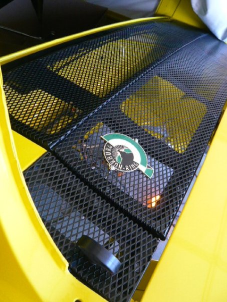

I started the morning by searching the archives for "GT Lid". I found a great how to that took me to Dave's post on the PP BBS. Great job Dave. I was inspired. Off to the garage.
In building my GT replica I wanted my lid to match as closely as possible. I wanted the two screens to mate together down the middle. This is how my project differs from what I saw on other sites. I left the extra metal (not covered by an additional, original grill) at the back of the lid.
I actually only spent about 2.5 hours on this to get it to what you'll see below. The only thing left to do is to bend the final lip(s) down on the backside of the lid and prep for finishing.
Here's what you need if you care to brave the wilds of creating a GT lid.
* An extra 914 grill.
* Cut-off wheel.
* Tin Snips.
* Sabre saw with a metal blade.
* Die Grinder
* Vise
* Drill
* Body hammer
* Dollie
* Flanging pliers (or something... haven't gotten to that step yet. I'll keep ya posted)
Step 1:
I think this is a fairly easy way to get a GT lid started. I simply used an extra 914 grill but used it in the opposite direction. No "major" bending of metal (at this point). All you'll need to do is cut the mounting tabs off the long side where the two grills will meet. These tabs would get in the way of the tabs on the original grill. By cutting them off and using a "V" notch, the original tabs will be able to mount in their original holes (novel concept). I've also left as many of the (other) original mounting tabs as possible on the grill. More about that later. I used a small cut-off wheel to do the job.

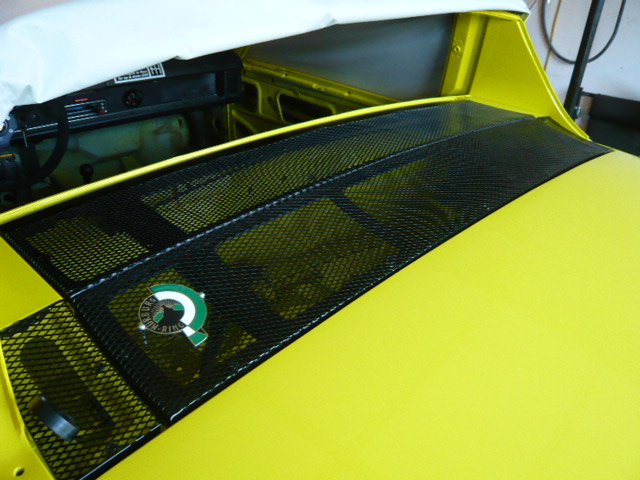

Eric_Shea   Today's status: Finished off the filler on th...   Nov 8 2003, 02:00 PM
Eric_Shea   Here's the parts hanging in the sun... I'l...   Nov 8 2003, 02:02 PM
djm914-6   SCHWEET! That looks much nicer that what I ha...   Nov 8 2003, 02:08 PM

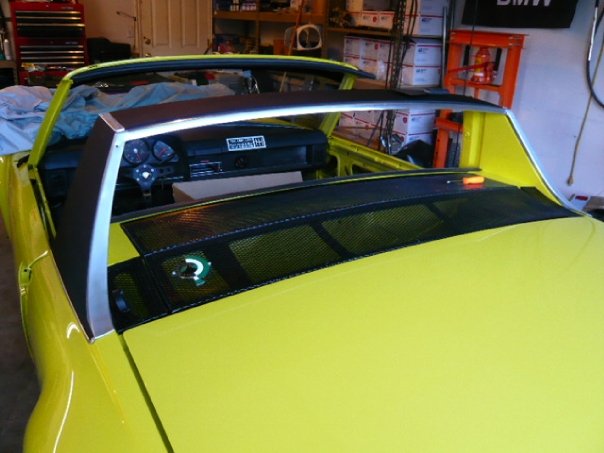

Eric_Shea   Thanks Dave and all... Done, fineato, pronto, fin...   Nov 8 2003, 02:39 PM
Eric_Shea   Last one...   Nov 8 2003, 02:40 PM
thesey914   ...   Nov 8 2003, 04:09 PM
scotty   O-M-G! :worship:   Nov 8 2003, 04:10 PM
Eric_Shea   It is on the car... sitt'n right on the rear t...   Nov 8 2003, 04:33 PM

Eric_Shea   I have nothing to add but a picture of the lid now...   Jun 2 2010, 09:10 PM
SirAndy   I have nothing to add but a picture of the lid no...   Jun 2 2010, 09:17 PM
Eric_Shea   That was an early shot when I was test fitting bit...   Jun 2 2010, 10:04 PM
SirAndy   How's this? :thumbsup:   Jun 2 2010, 11:09 PM
JmuRiz   How's this? :thumbsup: Double :thumbsup: Lo...   Jun 3 2010, 09:18 AM
Eric_Shea   Paul and Peter, I saw many GT lids and each was a ...   Jun 2 2010, 10:10 PM

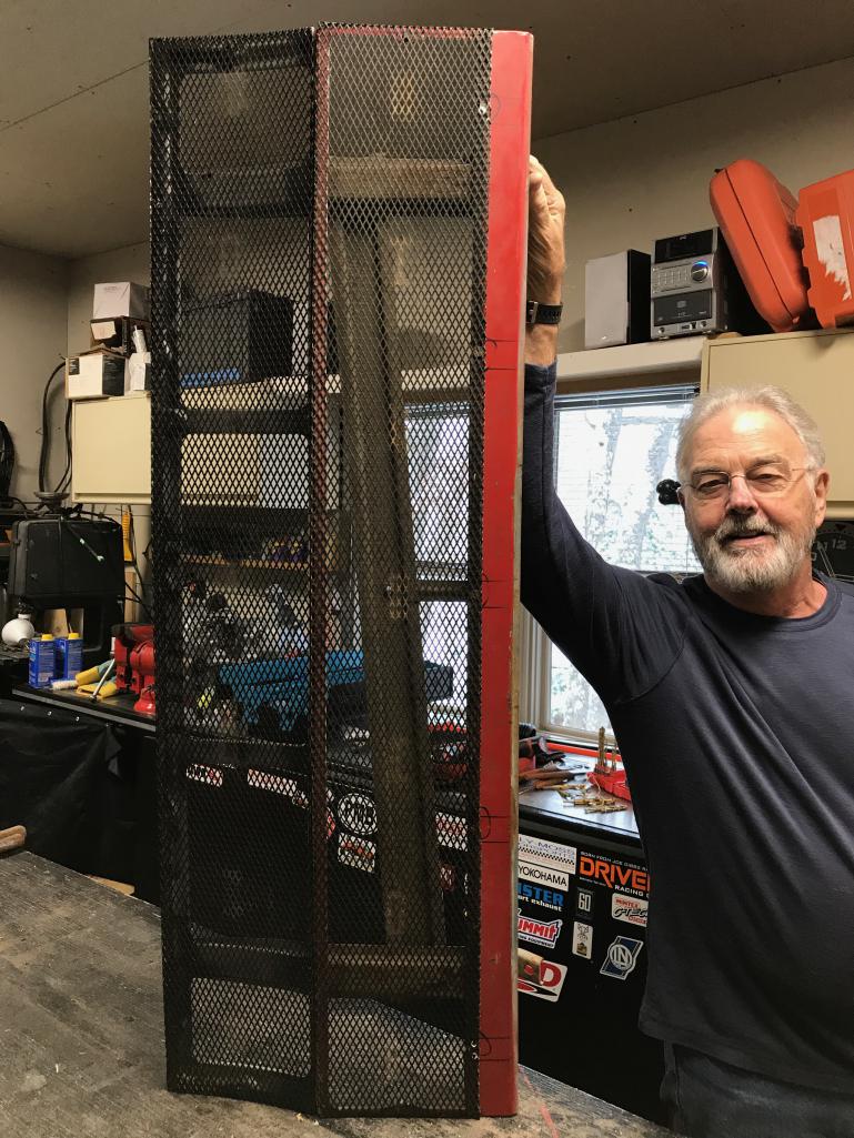

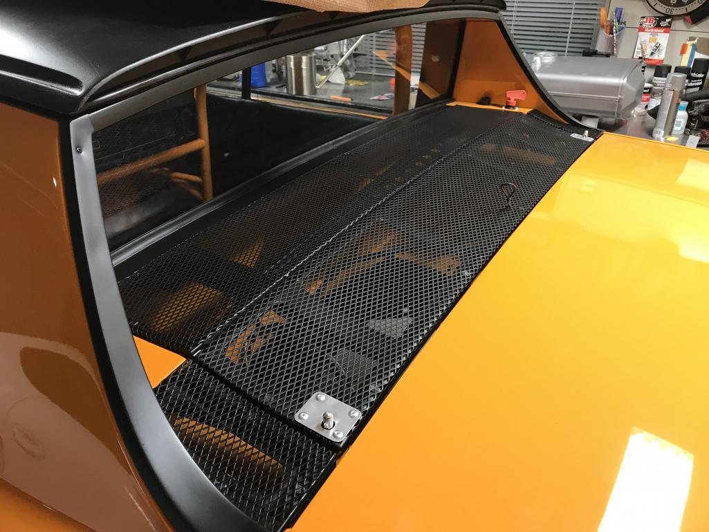

mlindner   Thanks Eric for the post. My buddy came up to Wisc...   Nov 25 2019, 06:29 AM
mlindner   Final product just great. Mark   May 23 2020, 05:05 AM
Eric_Shea   Great job guys! :trophy:   May 27 2020, 03:14 PM
