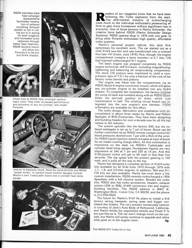

These articles are at least entertaining.
The first is two pages, from VW&Porsche, June 1980. (hard to imagine that the 914's had only been out of production for 4 years at this point)

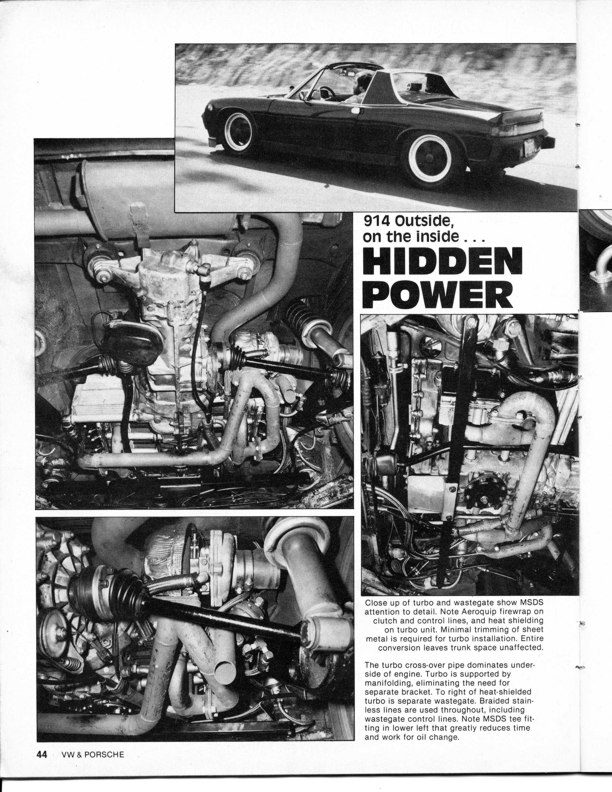

post Nov 4 2003, 12:39 AM
Posts: 997
Joined: 27-December 02
From: San Jose
Member No.: 22
page 2.
