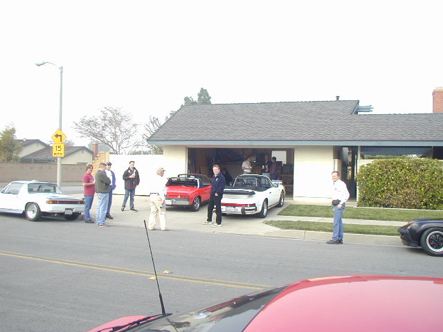

I've ran new pipes up in the attic on 1/3 of the house already (built in 1969) but because I have a breeze way twixt the garage and the house it's a PITA to run all of them in the attic. The main line comes in from the front of the house, all the way to the garage which is in back around the corner, then back to the house again. Not easy access to get the pipes in the attic there.
The epoxy is sposed to seal all pin hole leaks and prevent future leaks without having to rip up all the walls and stuff.
I plan on living there for 10 more years, then I retire to Utah or Idaho or someplace cold.
Here'as a picture of the garage (IMG:style_emoticons/default/wink.gif)
