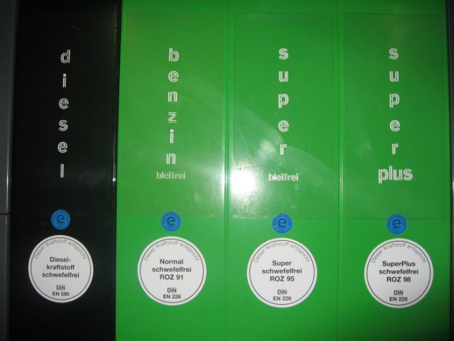

I run 87 on my stock 2.0 engine as recoemnded by Porsche on the sticker under the hood of my '76. I have never really seen much if any diference between the 87 and 93 octane fules. te only time I use 93 now is if I am also putting in a bottle of injector cleaner. Not sure why, but I feel like it is better to do it that way, although I have no evidence.
I was thinking about the octane ratings between the US and Europe a few weeks ago and when I was on my way to Stuttgart I popped off this picture of a pump there that clearly shows 91 ROZ is the equivalent of regular here in the states.
