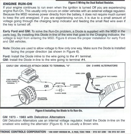

Found this picture on a thread a year old...about engine Run-on. The more I read it seems its an issue with MSD (which I don't have--Compufire), but also manifests itself as result of all kinds of electrical issues.
Quote: the keeps-running symptom has been known to be caused by - of all things - bad connections to the front turn signals. wonky grounds can affect it too.
Anyway, it sounds like an easy fix if it works. From the looks of it the diode allows juice to flow to the Alt bulb does not allow some sort of backfeed of 12 vots to enter the ignition cirucuit (Fuse 9) causing run on.
jd66921
post Oct 28 2006, 08:42 PM
Posts: 316
Joined: 9-January 06
From: Texas
Member No.: 5,394
QUOTE(computers4kids @ Oct 28 2006, 07:04 PM) *
It's worth a try. Still need info on what still works, and year of car if this
doesn't help! It would be better to fix it right.
Jeff

You could try splicing in a one way diode in the power wires to your amp and stereo, some how power is bleeding back into the system. Simular cure for the MSD problem above.

I guess I could put some diodes inline--I'd rather figure out what I've changed that has caused this feedback.

I guess I'm going to try the "diode" near the generator light. The light has two prongs: one with a thinner blue wire and another that is a twin red wire that loops to the other instrument lights.
Which wire do I put the diode on? And which direction?--flow towards the light or away from it ( I presume towards it).
A little help please,
Mark
If you want to add the diode, the (+) end of the diode goes toward the light bulb.
The other end of the diode is the ngative end, and is normally marked with a bar.
On my car, you would put it in the blue wire line.
