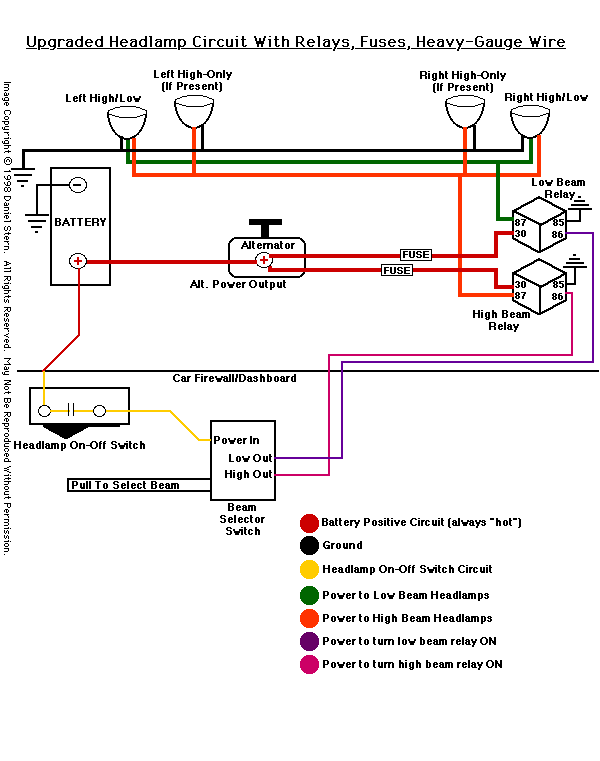

Here's a pretty good read on the issues, and diagrams on how to employ relays.
http://www.danielsternlighting.com/tech/relays/relays.html

my thought on this is to use the current wireing to trigger relays to power the lights. So, when you turn the lights on, the low beam wires turn on the relay (you can use one for both or one for each side). Same with the high beams. You can buy a fuse block from FLAPS and run the necessary power to the fuse block. Run from the fuse block to each relay.
Low beam R wire to Relay applied power
Low beam L wire to Relay applied power
High beam R wire to Relay applied power
High beam L wire to Relay applied power
Battery or Stock fuse block + to fuse block
Fused connection to relay LR,LL,HR,HL constant power
Ground each relay
This would keep the stock switch and High/low relay in play and not require a huge amount of rewire.
If you lift out the tank, you can run the new power along the stock wireing loom and keep it low profile. Mounting the fuse block on the headlight bucket (below the tire cover) makes for easy access.
A GT headlight pop up kit and you can lose another 5 lbs off the front of the car.
Thoughts?

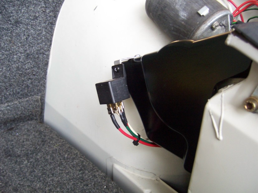

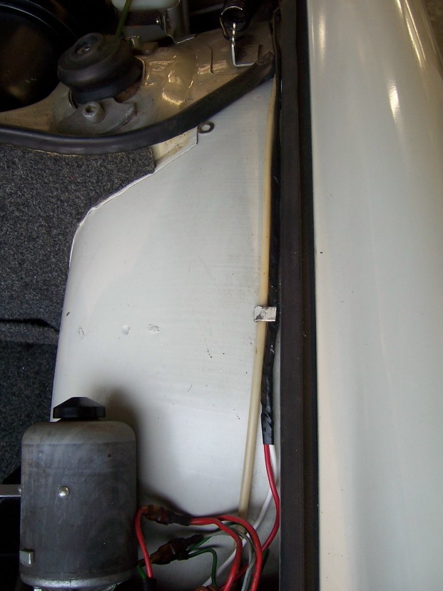

I had some extra time today so I wanted to tackle this problem. Here's what I did:
Since my low beams are 55W I decided to stay with stock wiring and not touch a thing. I'll run only additional relays and wiring for the 100W high beams. I bought and attached an aftermarket CB Panel in the engine compartment. You see three wires. All 12ga. Left to right is High Beam (HB) left, HB right, and a spare. Should I need to run something from the battery in the future it's nice to have a spare feed already hooked up. The wires go through the bulkhead and under the passenger seat. The third wire is capped off under the seat.
I then ran the wires up the tunnel with the main harness, over the top of the main CB panel and up out to the front trunk. At this point I changed the color of the HB right wire to white.
I made a small aluminum bracket to hold the relay to the headlight motor cover. I pulled 56a from the headlight bracket, fed it back through the opening to the bucket, and attached it to terminal 86. The original power wire (56a) that would turn on the highbeams now powers the relay. The power feed from the battery went to terminal 30. I made a wire to run from terminal 87 to go to the headlamp. And another, the green one, to go to ground from terminal 85.
I showed only the left side but the right is set up exactly the same.
I like using the stock wiring in this way. As mentioned previously in this thread it alleviates a lot of extra wiring and work. Also I have two CB's prior to the headlight. A good safety margin. I haven't tried it out yet since I need the battery to remain out of the car for another repair.
Thanks for the help all! (IMG:style_emoticons/default/beer3.gif)
