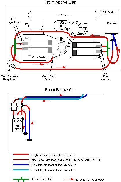

My son and I replace the fuel lines in our 73 2.0. We used 3/8 inch thin-walled aluminum. We tied a cord to the old lines when we pulled them out and use the cord to steer the new lines into place. We pushed the new lines in from the rear of the car. Using the string and guiding things by hand using the access ports in the center tunnel were all that was needed. The diagram I found on the site of the tunnel cut open was really helpful. Finished with a few restarts in about ½ hours.

This diagram was also very helpful.
Lesson learned: The fuel pressure guage and this diagram are invaluable for trouble shooting tools and worth the money. I plan to just install it permanently.
