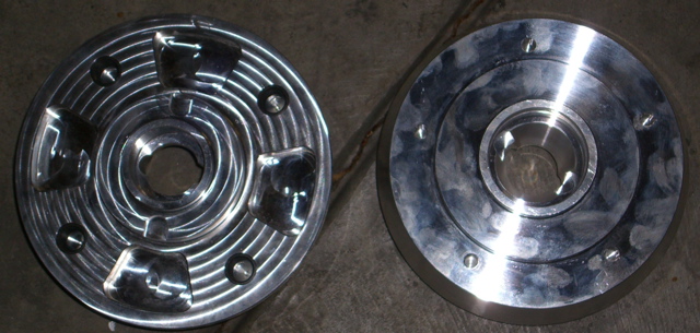

Like these magical mythical billet 4 bolt front hubs?
Use with M front calipers and early 911 vented rotors.
