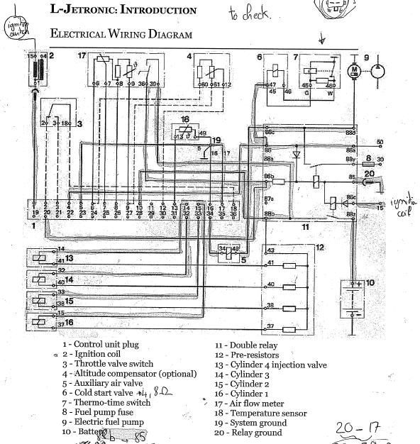

I have tested the wiring harness according the website link you gave me: everyting seems to be working... exept for the resistance between ECU plug terminal 20 and system ground at terminal 17 with ignition ON: I have 647 ohms (Test Chart says 52-78 ohms). Does that means that my fuel pump relay is defective? I don't think so because I can activate fuel pump by pressing the AFM flap witouht any problem.
Underlined wires on the enclosed FI wiring harness diagram are OK: I have tested all of them yesterday evening. I have 2-3 ohm for each injector. 4 ohm for cold start valve injector.
Is it possible that the ECU is defective? How can I test it?
When I start the engine I have no spray at the cold start valve even if the wiring connections seem to be OK. Can I put 12V and ground to my cold start valve to see if it is working?

Did you test the resistance in the cold start valve's windings? You should measure about 4 ohms between terminals 45 and 46 in your pic.
You should also have continuity between terminal 45 and thermo-time terminal G (see figs. 6 and 7 in your pic) and terminal 46 and thermo-time terminal W.
