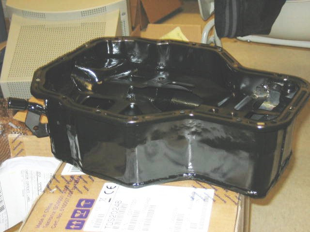

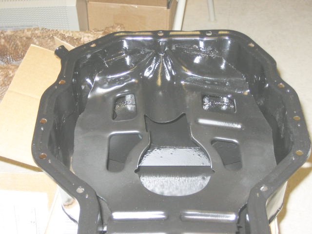

QUOTE(seanery @ Dec 31 2006, 05:16 PM) *
Pics of the finished job, or pics of the mess ?
The parts I coated were an oil pan and splash tray from a Subaru EG33 that I reworked (shortened) for putting in my 914 one of these days. The coating is black, so it's real hard to see anything at all in the pics. Here's one with contrast and gain cranked up fairly high. What can I say ? It's black. I missed a few spots on the inside, and they really stand out in the picture. I originally wasn't gonna coat the inside, and did it after the pan was hanging in its curing position, so some angles were tricky. For curing I used a catalytic propane heater and some sheets of scap metal set up behind the part as reflectors. (Sorry, no pics). The heat wasn't super-even, so I kept rotating and adjusting the parts/heater during curing. A proper oven would pobably be much more uniform.
Hey, that was picture # 666 for my camera. Coincidence ? I don't think so...
Here's a pic looking down into the pan, with the splash tray in place. Again, major contrast/gain tweaking. The splash tray was the first piece I coated. Towards the rear (top of pic) got less heat during curing, and came out more glossy than the rest. Also, I made several attempts on the tray (wiping it off w/ a paper towel), and it wasn't coated super -evenly, so you can see some bumps. I have no idea why the bottom of the pan (seen through pick-up tube opening) looks so white in the pic; in reality it is a nice, even black.

More than likely you didn't get a full cure on the part. I don't know what the cure schedule was for your perticular powder, but typically if there are areas with more gloss than others, then the cure was not completed.
You may want to run some test parts prior to running real parts to play around with application and curing.
If you take some MEK on a Q-tip and rub it on the "shiny" spots, the paint will come off. (This is a rub test with a generic solvent. Rub Test kits should be available from the powder manufacturer.)
The shaking of the powder just prior to pulling the trigger may help. The use of a fluidizer really helps keep the powder loose.
To cure parts like that pan, I would shoot for a lower temp for a longer time (to get the metal temp more consistant without burning the powder).

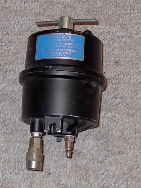

If your propblem is powder delivery than you're pressure's worng OR you have moisture in you air lines (regardless of whether the powder *feels* dry coming out). If you don' have a good moisture filter, get one. Especially for powder coating.

Moisture can really cause some erratic problems. I also have the HF gun and was getting the same problems. Once I hook up my air filter it fix the problem. It not the cheapo air filters either. This baby extracts all the moisture. Has an element inside that looks like a roll of toilet paper.
