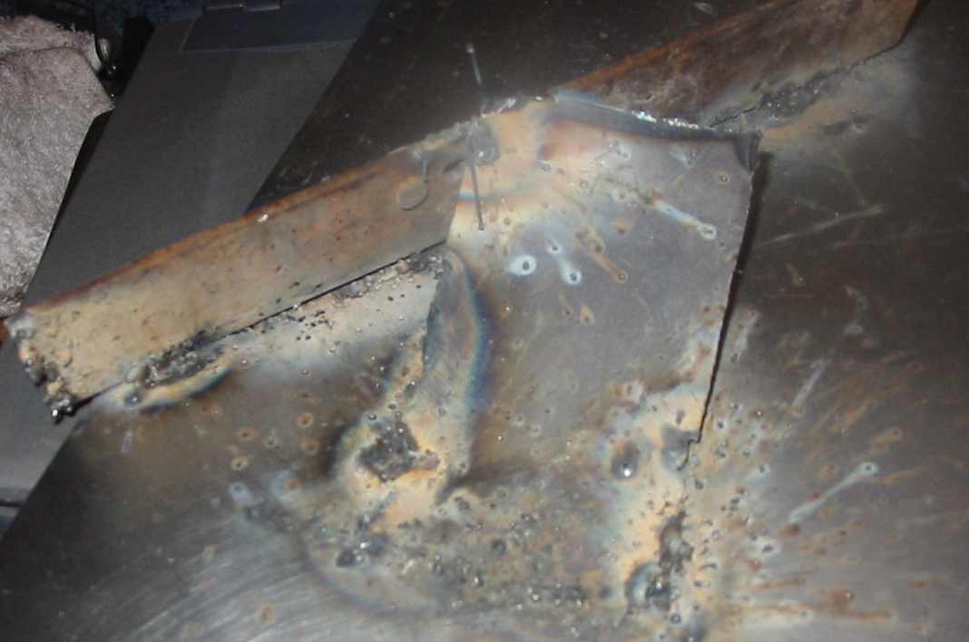

OK. It looks AWFUL. JUST AWFUL. But thes pieces are really and fully attached. Even actually fused like real welding in a few spots. I'm gonna keep practicing a little before I attempt car stuff, I think. (IMG:style_emoticons/default/smile.gif)
For a cheapie HF wire feed (not mig), it seems to work OK. Who has some good welding tips? I saw something on the almighty internet that indicated there might be primer of some kind? When do ya use this? What do I need to look out for? It's kinda fun. The biggest challenge is starting "in the dark". How easy is it to burn 914 sheet metal up? This is only a two setting unit- high or low. So far I've been using just low.
So here is my sculpture.
Now I really need a good cut-off tool....

It's a start! (IMG:style_emoticons/default/biggrin.gif)
The Harbor Freight auto darkening helmets are helpful, or halogen lights illuminating your work piece so you can 'see' with your helmet down.

Its flux core wire right? For mild steel I think E71T1 is the one to use for flux core .035 in dia.
If you want to learn how to weld, get two plates and but them together flat. Allow for a 1/8" gap between the two plates you will be welding. Fasten them down at the top and bottom with clamps or even a weld tack. The trick is to bridge the gap and burn completely through the metal which should be about 1/8" thick. You need to run just enough heat as to not burn through but still need to weave back and forth from one side to the other and filling the gap with weld wire. When welding, you should see a small puddle of moulten metal which you need to keep wet and stretch it from one end of the plates to the end. If done correctly, it will look like flowing water, about 1/4" wide and slightly convex to almost flat. Just do little even circles in the moulten puddle and it will be perfect. The wire should not bounce as you are doing this but melt smoothly so keep your wire speed in ballance with the heat setting you use. (IMG:style_emoticons/default/biggrin.gif)

Thanks folks. The auto darkening helmet sounds like a must have. The E71T1 wire is prolly NOT Harbor Freight spec, right? I will work on filling holes and bridging gaps. Is it possible to get a decent bond upside down? Like on the bottom of a car on jackstands? I'm not even gonna address the potential for horrid burns, just will it work?

So far all of the welding that I have done on my car has been flux core, as I was too cheap to go out and get a gas bottle for my welder. Welding sheet metal is HARD with flux core. You will burn through it, especially while you are learning.
As I understand it, if you clamp copper to the back of the metal that you are welding, it acts as a heat sink and and really helps burn through. Also, the weld is not supposed to stick to the copper.
Of course I learned this after I was done with just about all of my sheet metal welding.
Butt welding looks nicer, but is much harder. when ever possible I just cut the patch slightly larger and welded the over lap. That _always_ worked much nicer and gave me a stronger weld the first time. Course, for body work, that might not be possible.

just my 02: don't go near your car with that thing. use it for mending fence or fixing a plow or something. even if you could get two pieces to fuse with it (without burning holes everywhere), do you want all that splatter all over your car?

AFTER I got it, I started reading up a little more. I would have preferred MIG, but dis is whut I got. I now realize that a mig joint is not only cleaner, it is stronger, too. Well, for the $, it can be a learner. Dr Evil still has my trans, so I get a while to see if I can make this work OK.

If you are going to try to weld body parts with an arc welder you are really going to struggle.......It's hard enough with a good MIG. For best results, no rust, oil, residue, NOTHING! Clean, freshly ground metal will make life much easier.

Get a welding book.
It helps to pre-heat the work piece. Try it in your oven. 350 deg or so. That'll help.
Flux core will help too. But a purge gas is still best.
When you get into the high-end stuff (like your car.) They've proven that sunlight helps in some way.
EDIT:And take lots of time with the prep work. Make sure everything is very clean. Use a metal-prep solution after wirebrushing it clean.
And DON'T get a crappy auto-darkening helmet from Harbor Freight. They suck. They are POS. They're response time is really poor, so you get bad burn-in after a few time off-on.When it comes to your eyesight, get the best. Get oone with a faster response time, or get a traditional helmet (because it'll ALWAYS be on when you're using the torch.)

If you are using wire feed (not MIG) then you should be using flux core wire.
Flux wire will never make as pretty welds as MIG will, but you should be able to make some acceptable welds after some practice.
I hope you have some good gloves, a good helmet, some welding protective clothing, and a BUNCH of patience. A good grinder and a wire brush will help as well.
Try to keep your welding surface as clean as possible it will keep the brown crap to a minimum.
Another tip is to obtain a piece of 1/4" thick brass. It can be small 2" X 4" X 1/4" or so. You can use this as a backing plate to fill small holes and to bridge gaps. The weld will not stick well to the brass and will support your puddle until it solidifies.
The easiest way to learn is to get a bunch of scrap (the thicker material is easier to do than sheet metal) 10ga or 3/16" and weld them on a table. weld them at 90 degree angles, butt weld them, lap weld them, and try to break them.

Try welding with no gap. Gaps are for thicker materials in order to get good penetration. Set the welder to its hottest setting and do short bursts...zap, ,wait....zap again. You want a flat hot weld. Look at the back side of the weld. It should look like a weld, not two pieces glued together. Flux core welders are a poor choice for sheet metal but they will work.
