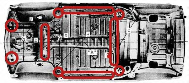

answer #1 = Jack Stand Locations

Here is the real deal.

depends on where you are doing the work. the chart is good although we use boards under the stands to distrubute the weight

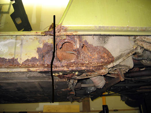

Here is the area behind the inner rocker on the right side. Is this what is called the inner wheelhouse? Restoration Design makes a piece for the right side.

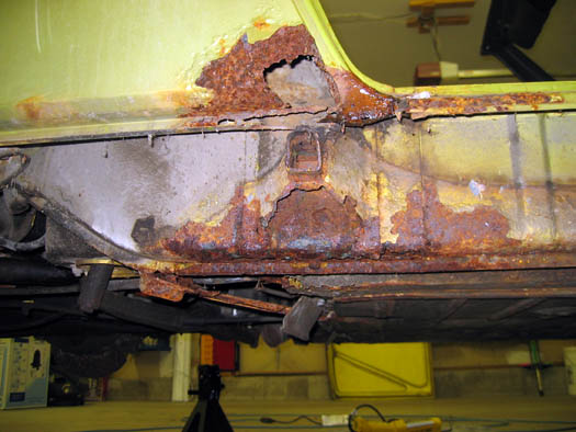

Here is the left side. I noted that (probably due to the location of the battery, neither Restoration Design or Auto-Atlanta make a piece for the left side. Make my own piece, right?

The "wheelhouse" is the area of the car where the wheel lives. No, really!
The parts you're looking for are the "longitudinal"--the "clamshell reinforcement" may work as well; just make sure you cut away all the rust and then treat everything so the rust doesn't come back!!
Another good location for jack stands is under the pivot for the trailing arms. The pivot tube fits nicely into one of the jack stands pictured in the thread linked to earlier.
The Doc is quite right about using wood to spread out the load; I mentioned that when I originally posted the pic. The front suspension pickup points and the "donuts" are the exceptions to this rule.
