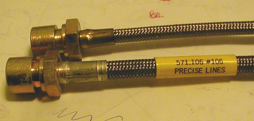

QUOTE(sww914 @ Jan 8 2007, 10:02 AM) *
The story I was told by a supplier many moons ago is that the lines are the same, but the DOT ones are more expensive because the manufacturer spent about $35,000.00 proving that they are safe and getting them certified by the DOT, so the cost is passed on. If you put stainless lines on your car, it will not stop any faster.
The pedal will feel harder, the lines will resist abrasion better, and they look really cool.
I actually have a set of both. I think they were made by
"Precise Lines". That is the name on the packaging.
Both were made by the same company and are packaged similarly.
The DOT ones do look different. The hose is bigger in diamter and
the crimping on the ends looks better made. The crimping just looks
better. See the attached photo.
The one with the yellow label are the DOT lines.
slothness
post Jan 8 2007, 03:15 PM
It's business time
Posts: 110
Joined: 7-October 04
From: Valencia, CA
Member No.: 2,906
Holy crap, I just bought some awhile back! I hope I got DOT approved. I think I remember the yellow label, but I might just be imagining things. (IMG:style_emoticons/default/sad.gif)

QUOTE(bperry @ Jan 8 2007, 10:57 AM) *
Thanks for the actual info, as opposed to the myth that I was propogating.
