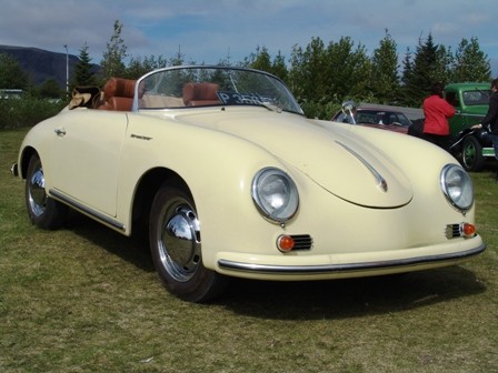

HafthorRunar
post Feb 2 2007, 02:39 AM
Posts: 4
Joined: 29-January 07
From: Iceland
Member No.: 7,487
Thanks for that:)
My Replica Is made in the US of company named CMC speedster. And this car whas made around 1990" and the whas a Film maker hear in Iceland how buy this kit and used him in film he made 1992. But this car was never finnist and had bin in his garats for 10years. So I got him aruond 2002 and have bin workin in him and trying too finnish him now for the summer. Paint him in silver and hoop i can finnish this type4 him (IMG:style_emoticons/default/drooley.gif)
And i Like to Iam sorry abourt My bad English (IMG:style_emoticons/default/confused24.gif)
HafthorRunar
post Feb 2 2007, 02:43 AM
Posts: 4
From: Iceland
Member No.: 7,487
this is My car (IMG:style_emoticons/default/thumb3d.gif)
So.Cal.914
post Feb 2 2007, 07:33 AM
"...And it has a front trunk too."
Posts: 6,588
Joined: 15-February 04
From: Low Desert, CA./ Hills of N.J.
Member No.: 1,658
Nice looking car.
You make yourself understood, the rest will come in time.
Keep up the good work.

QUOTE(HafthorRunar @ Feb 2 2007, 12:43 AM) *
very nice!
(IMG:style_emoticons/default/beerchug.gif) Andy

post Feb 2 2007, 06:17 PM
Hey nice rack! -Celette
Posts: 21,217
From: Now in Superior WI
Member No.: 43
Very nice! (IMG:style_emoticons/default/welcome.png)
