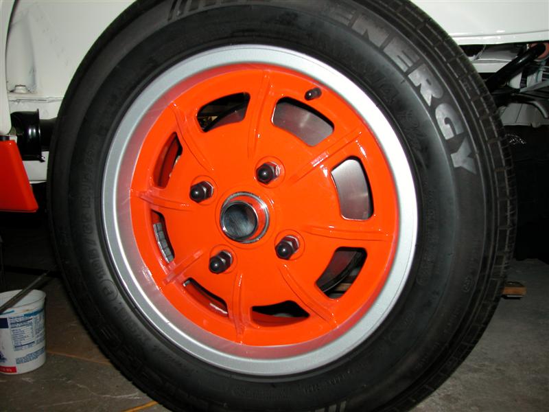

LE rim refinished properly, yeah its orange so think yellow.

Yes, I am sure they are painted, and the Wurth silver is a very close match. Either painting or anodizing must be used to protect the bare aluminum. Without either the aluminum would oxidize quickly and darken eventually.
