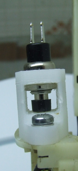

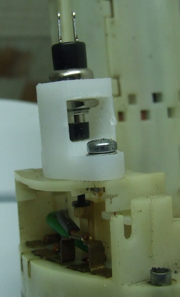

So, I have made a prototype switch holder, and it works. The switch will not carry the current, so a relay would be required along with a fuse and the pump. Should I make this into a turnkey kit?

Dave,
Your setup looks good. Ideally the switch should be able to carry the current of the pump. Adding a relay is an extra complication that could be avoided with a 1 to 5 amp switch.
What current rating is your switch?

This switch is about 0.25 amp, and another I will try to sample is about 3 amps. Not sure of the inrush current of a washer pump, and that is what will burn the switch contacts. Relay can be a 10 amp unit that is mounted in an easy to replace location. Also have to have a fuse. I want this to be a reliable solution. Also have to figure out the pump mounting. The six has the mount locations, and I'd like to duplicate this and the 914/6 pump. I can supply the vent for the washer bottle cap.

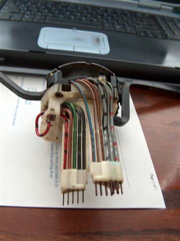

Help. I received my 924 switch and opened it this Sunday. It was kinda cracked up where the mounting screws go into it and, it didn't seem to have a pull/on washer pump feature.
Am I missing something? The right stalk should pull correct?

how many wires you got?
(IMG:http://www.914world.com/bbs2/uploads/blog-219-1153778014.jpg)
Eric_Shea
post Mar 5 2007, 03:43 PM
Post #39
PMB Performance
Posts: 19,304
Joined: 3-September 03
From: Salt Lake City, UT
Member No.: 1,110
I see you have the same cracks...
Let me count wires. How many should I have? 11-12? (that's about all I can see in that pic)

you should have 2 more than a stock 914 switch (just the washer section)

Just got in a sample of a similar switch, but 5 amp rated. That should be good enough to work without a relay I think. I'm going to convert my own cars anyway.
