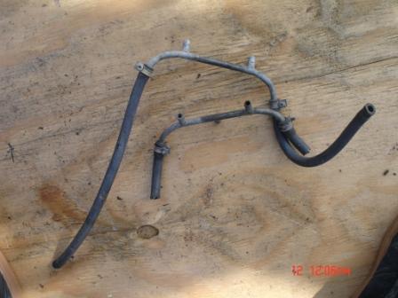

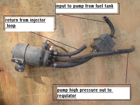

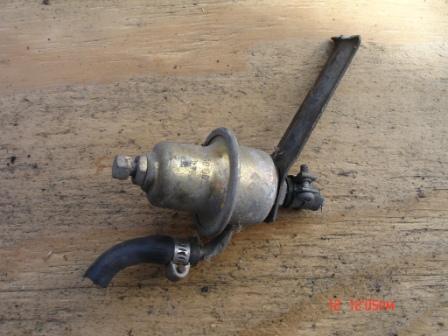

to start let me explain the 914 fuel system as i understand it. please correct me if and where i'm wrong:
1) fuel comes from tank to pump, bottom nipple on pump
2) high pressure out of pump to regulator, middle nipple on pump
3) reduced pressure fuel from regulator loops to and past injectors then back to pump, top nipple on pump
if this is the true operation
i should be able to:
1) mount 914 pump near tank (1969 ranchero v-8). run high quality lined goodyear hose (better than oem vw hose used on 914 system) to 914 regulator (30 psi) say 12 inches from pump output.
2)after 914 regulator outlet (30 psi) install a "tee" in line to return unused fuel pressure. thus "mimicing" the fuel return loop of a 914
3)run 30 p.s.i. fuel from 914 regulator/return tee forward through (stock 3/8" steel line) to 2nd regulator at carb. this dial type regulator would hold pressure to 4 psi at carb
(IMG:style_emoticons/default/poke.gif)
any thoughts/comments on saftey/operation that i might be overlooking (IMG:style_emoticons/default/clap56.gif)
